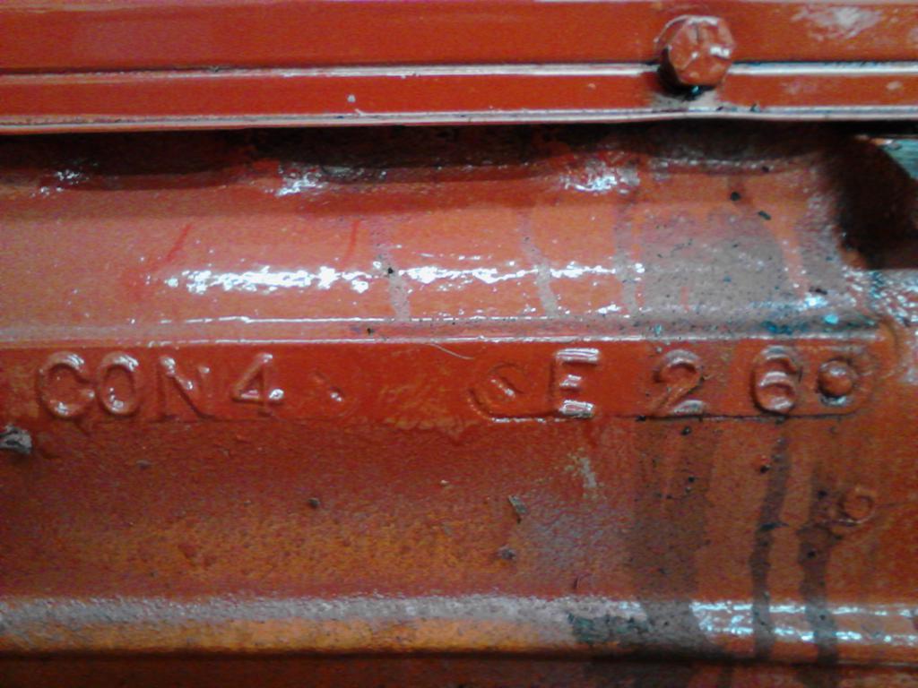

    Well I changed my mind on that motor but fell into better luck with another 235! this ones block number is. 0340363f56z
    its a 56 so that means its a hydraulic lifter engine! he also threw in this nice valve cover.!

    Block was cast on May 2nd of 1956
