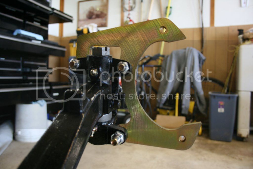

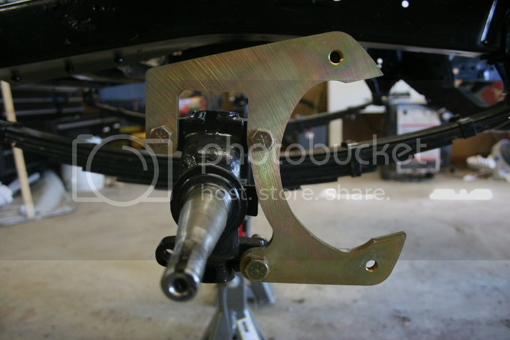

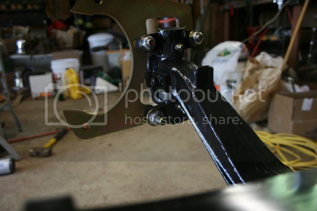

    Just wanted to post a few photos of the disc brake conversion kit I had tried to use before I sent it back. I shipped it back to the seller on Tuesday, and my bank account was credited yesterday, so there were no problems with the return.
    Here are the photos:
    In the first shot (right side), you can see the steering stop just barely not clearing the caliper bracket.
    Same story on the left side.
    The third shot is from the outside of the left side. It appears to me if they had placed the recess that is near the bottom bolt hole a little higher up on the bracket, these would work nicely. The brackets were otherwise good quality parts, approximately 5/16 of an inch thick steel, possibly laser cut.
    I'll be calling our host next week to find out which brackets they're currently using. I will most likely use our host's kit if the brackets are the correct design. By MNJim's account, it seems so! Thanks for the info, Jim.
