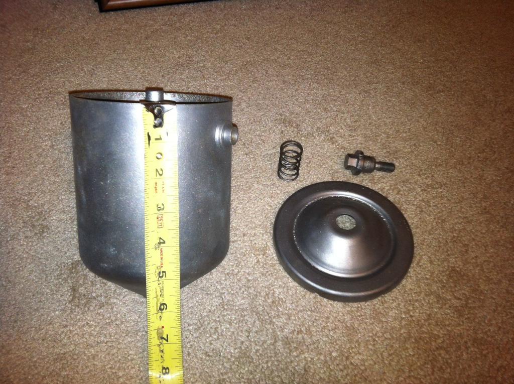

Well I know you guys like pictures....
So here are the pics of the actual filter and all of the parts that I have for it. A couple of questions:
1. The stem coming up in the middle of the filter only appears to have one small pin hole. Is that is all there is supposed to be? It doesn't seem like that's big enough to push the oil through.
2. The hole coming in on the side is stamped "INLET" so it is pretty clear which hose goes where. The thing I am confused on is on the underside of the lid there is no gasket or anything to keep the oil from flowing out the top once the top nut is screwed down. Is there supposed to be some sort of gasket that goes on the underside of the lid? If so, where can I find that gasket?
3. The screw that goes into the top of the lid and screws into the stem. Does that need a gasket as well? It would seem so to prevent leakage. If so, does anyone know where I can get that gasket?
4. I have the spring which I assume goes into the bottom of the filter. Does the filter just sit on top of that? Also does anyone know which filter it is that I need based on the outside measurement of the canister?
5. And finally, is there anything else I need to buy (other than stickers, paint, brackets to mount it to the manifold, and the hoses) in order to complete the assembly? Just want to see if there are anymore parts I need to buy.
After all the discussion I think I am going to go to the black/yellow combination. Thanks for everyone's feedback. Any answers to the above questions would also be greatly appreciated.

Steve, you'll need the 5" filter element. NAPA p/n 1100. Wix p/n 51100. The element comes w/ gasket. If memory serves, I've got a fiber gasket on the top nut/screw which can be found at any good hardware store or auto parts house.
Ken
Yes. Beware that your filter needs more often inspection then a regular modern filter as the oil is only sucked up and transported through , very simple fysics.The pinhole can be easely closed by particles or clothed oil. Its good to start with fresh oil when starting up your engine including this fllter. Climate and usage of your truck every day tells you what kinda oil SAE grade you should use. SAE 10-30 or 15-40 multigrade, halv synthetic or fully synthetic W 20-50 is average in use ? Me myself i use halv synthetic oil SAE 20-50 as it is not that hard in cleaning the engine inside to much ! As these old 50 tees engines are used to work best on low octane petrol gas with lead added a lead substitute is recommended if the low petrol gas (lead gas) is not availeble at your local gas station. The valves of these engines last much longer and valve ticking will be less . Usage 10 ml to 10 ltr of fuel. The contents of the substitute = Petroleum destilator 60 % ; Kerosin 7% and kalium Alkylnate 10%.
There should be a rubber O ring in the lock.
Yes , o-ring here to.
Yes , filter is availeble from our host ,just give them the inside measurement. The AC filter has another measurement then the Fram filter. Just look it up on there site.
No useally everything comes together with the brass fittings in the kit. Ask our host and they know what you need for the AC filter. Sending them a photo would help! Elsewhere complete kits are availeble at EBAY to.
Hope this is of any help?

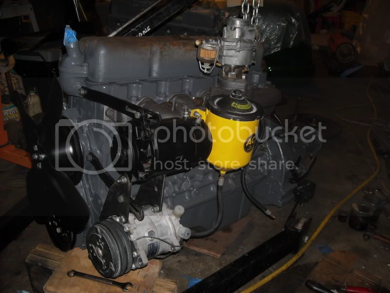

Then there's this~
Like they say, it's your truck. ;)

Nice atractive machinery Zig.
Red color atracks peoples eyes ,one reason firetrucks are colored red. I love it.Thanks fore sharing Zig.:)
