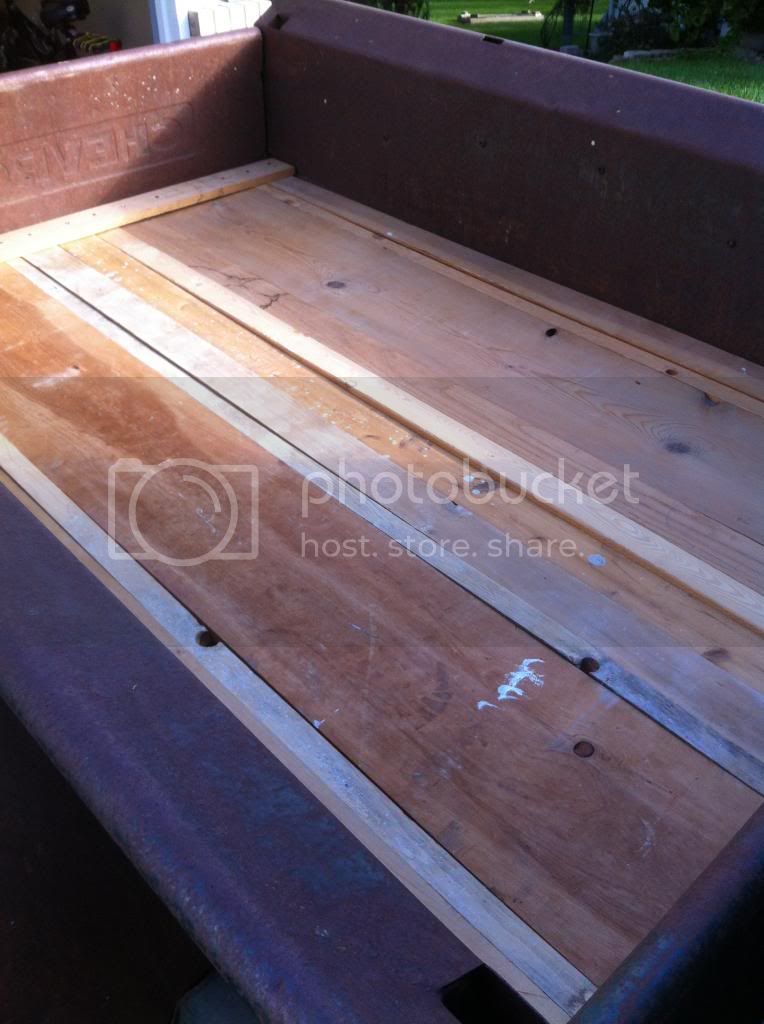

    Yesterday was my birthday and my wife said we would do what ever I wanted. So I got dinner at Red Robin and spent the rest of the evening after work tackling some projects. I was going to build a garden and needed to run to Home Depot and I wanted to take the 50. I grabbed some scrap wood that was left in the rafters by the last owner of the house and 2 hours (hand saw only) later I had the trucks first bed floor in 30+ years.

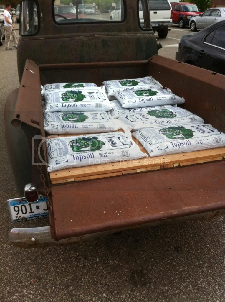

    This morning I went to the Home Depot to get some soil for the garden. I only got 12 bags because it was a shakedown run for the truck but it was successful.
    Its a lot more fun to go to Home Depot in the 50 than in my Ranger. And I always had someone to talk to while I loaded the bags. People just love to come talk about the truck.

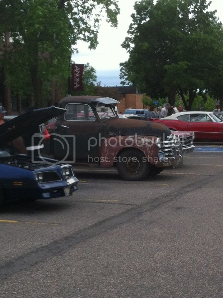

    I decided to finish the day with a car show. Its the first one I have ever brought my own car to. The truck ran good all the way there but I barely limped home. I need a new battery.
