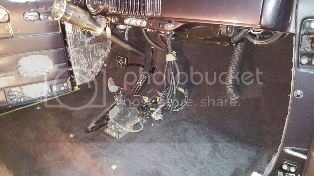

Inside of cab wires finally cleaned up

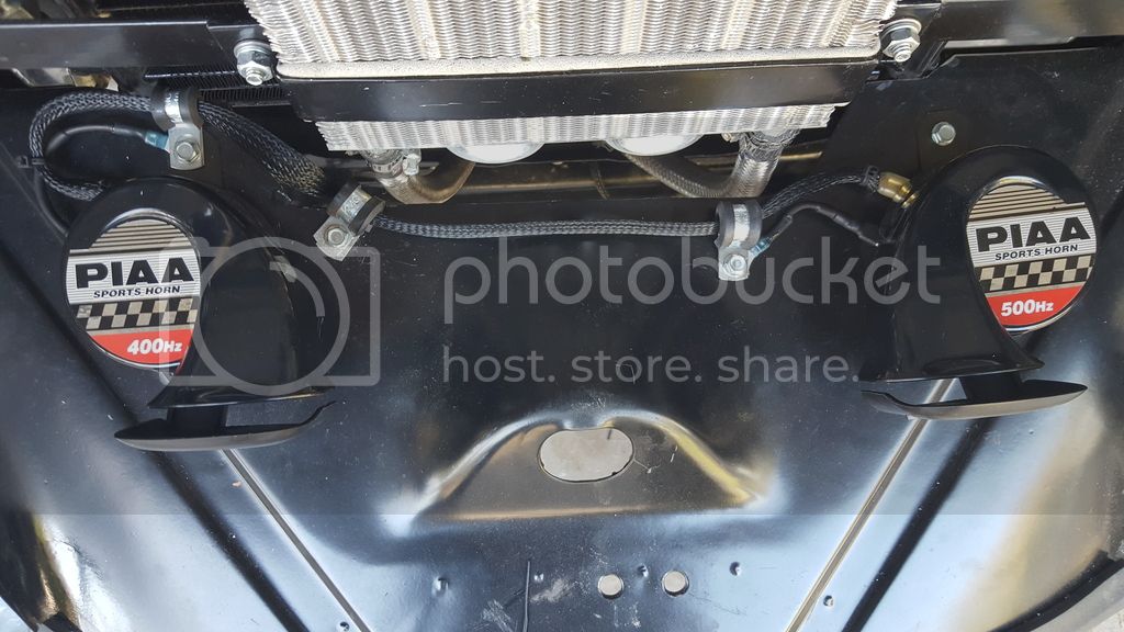

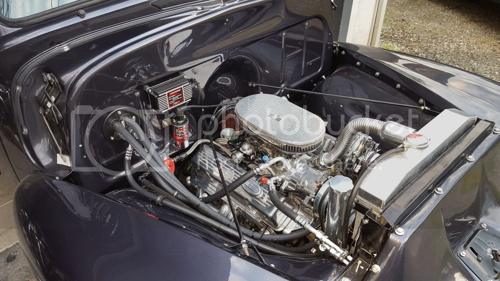

Wired horns in today
Love it, love it, LOVE IT!!! Man that is clean!!! Guess it's time to Google "PIAA Sports Horn". (Not sure I like something that has "PIA..." as part of it's name, however.)

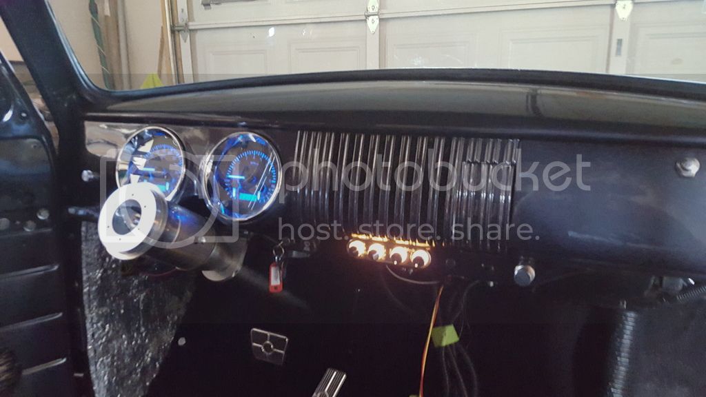

AC is a necessity in Phoenix where I'm at. Really like the vents in the lower drop down on the dash - where'd you get them?
What's the airflow like? Any other vents besides these four?
Would like to add them to my 'idea' file for my build
Thanks,
Phil

Thanks Phil, Vintage Air sent me some plastic vent holders to hold the vents and I Thought they were cheap and flimsy so I had a friend made me some out of 18g sheet metal.

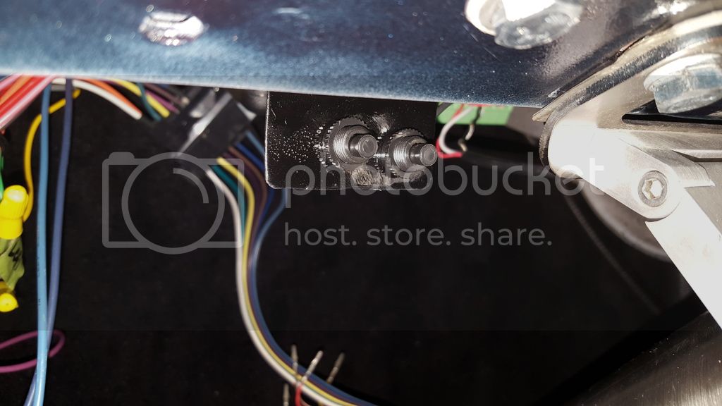

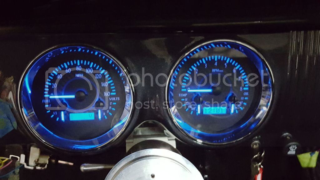

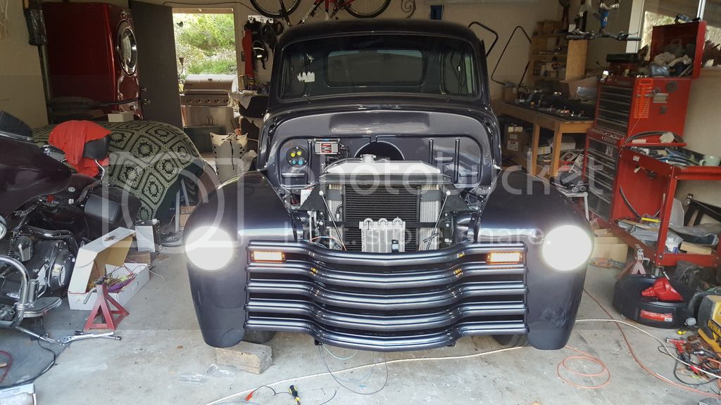

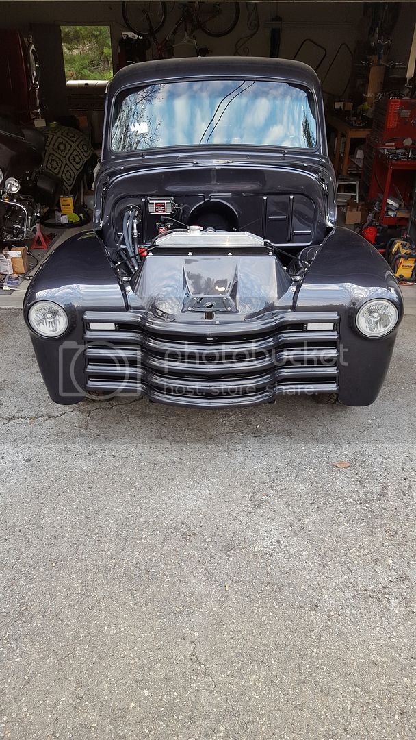

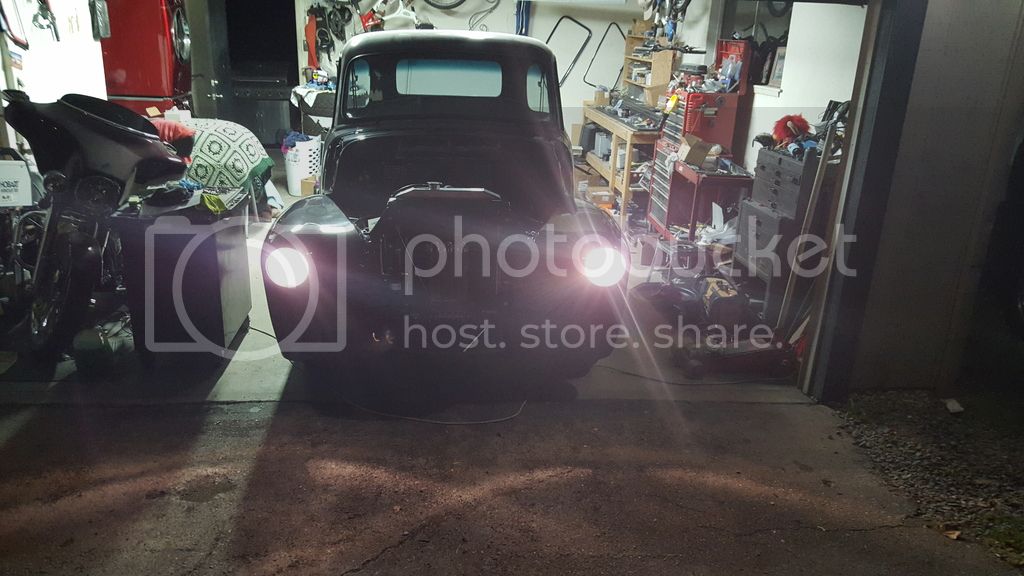

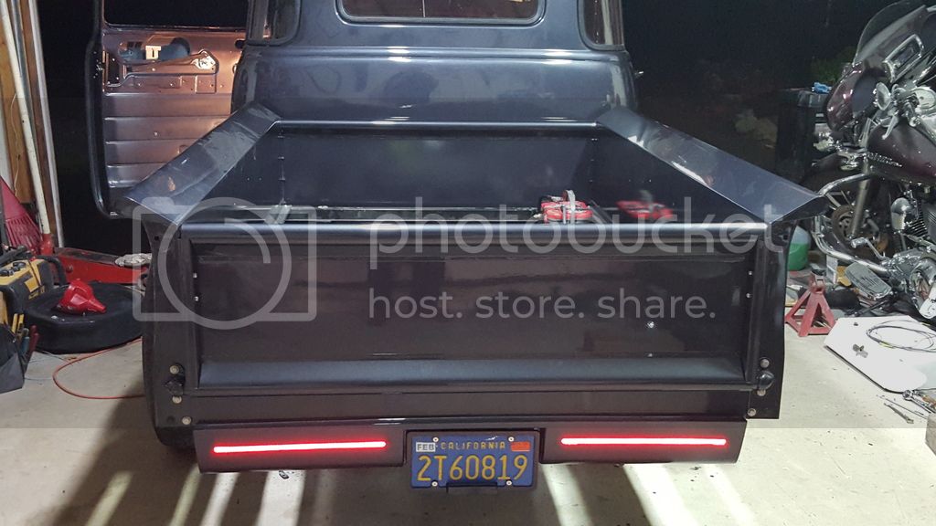

Few more things done, hook up the Vintage Air controls and installed my grill and hooked up the headlight LED's and the signal light LED's, also the bezel around the signal lights are powder coated satin black just like the license plate frame. In the picture only the LED's are on not the headlights. The headlight LED's are extremely bright. Also my gauges came with these little buttons that allow me to program everything, I fab a bracket so they would not just hang down and get damaged.

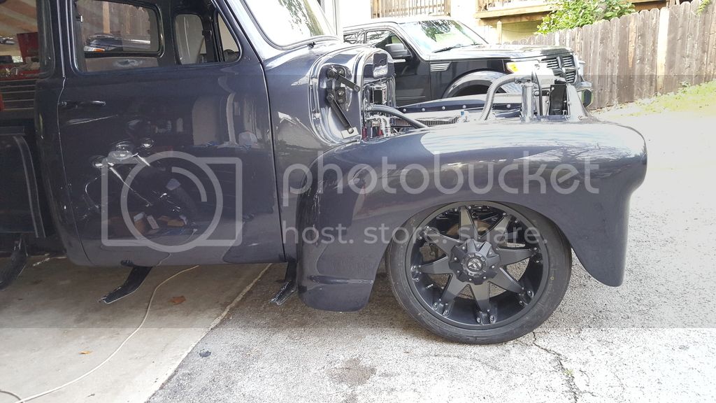

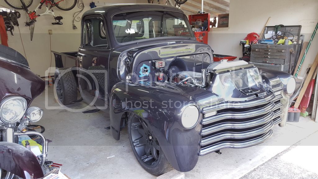

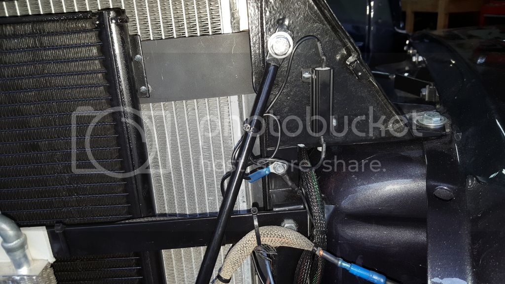

Had a little problem, found out when you only use LED's there is not enough load in the system so my flashers and turn signals did not work. I had to buy load resisters and install them on both sides at the front turn signals to make them flash. I also put my 20's on finished my A/C lines and started on the interior panels
Looks absolutely great, the color is amazing, not so sure about the wheels though, but it´s your truck of course;)

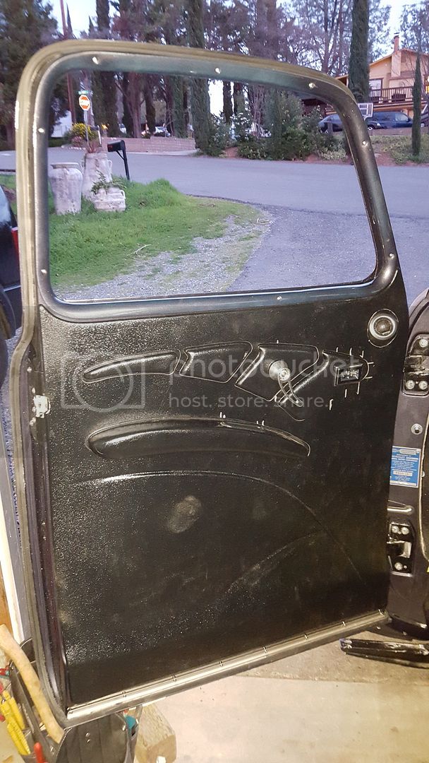

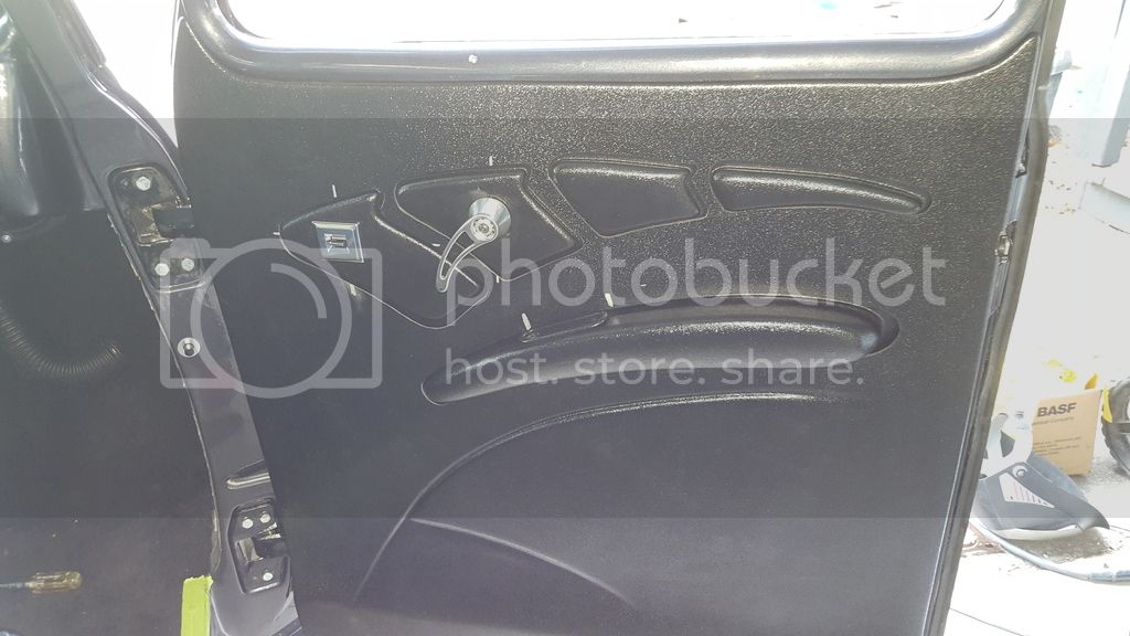

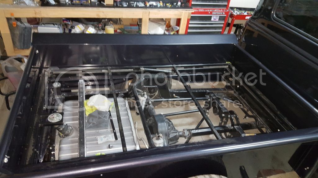

Finished the driver side panel and put the rack in the bed today!
" Finished the driver side panel and put the rack in the bed today! " #confused#
You don't let her ride in the cab with you ? My Lady would be furious #rolleyes# .
The panels I bought are not complete, they have to be fitted on the door. Then mount a bracket behind the panel cut a pocket hole in the armrest for the handle to fit inside and be mounted to the bracket. Cut and drill holes for electric switch and door latch then cut a hole for the tweeter pod before it go's to upholstery, which I dropped off at the upolstrey shop Friday. Then of course the rack is the tilt bed floor for the wood to sit that is raised to be above the c-notch.

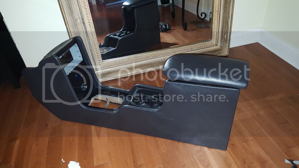

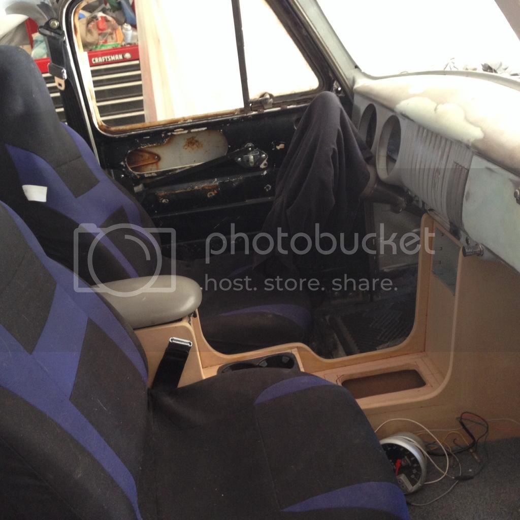

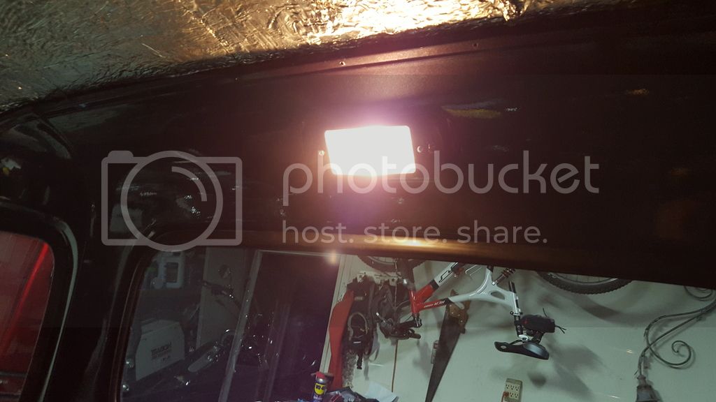

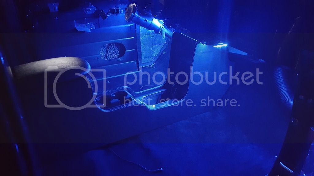

I had my middle console upholstered and installed led's that come on when I open the door.
Here's a pic of what the console looked like, I also had a sheet metal piece made that's fitted down the middle of the console I had painted the same color as the truck, the armrest and the cup holder I found at the junkyard out of a 2000 or newer (can't remember) Chevy truck.
