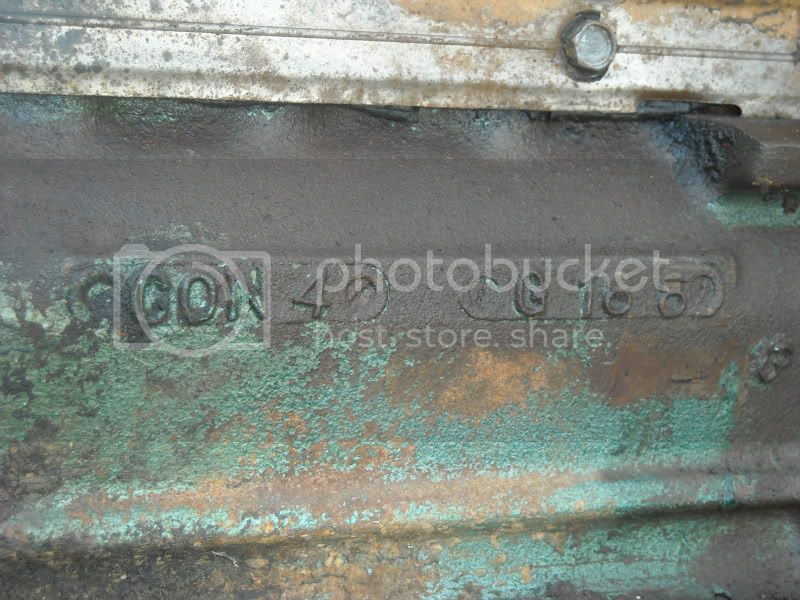

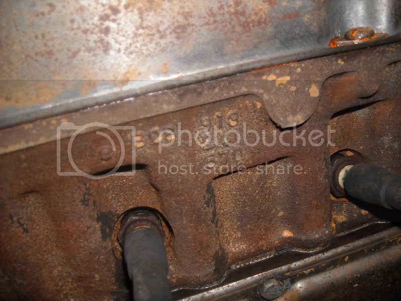

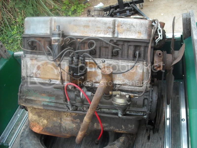

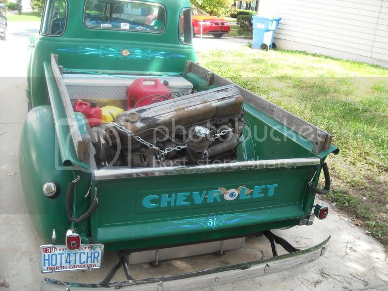

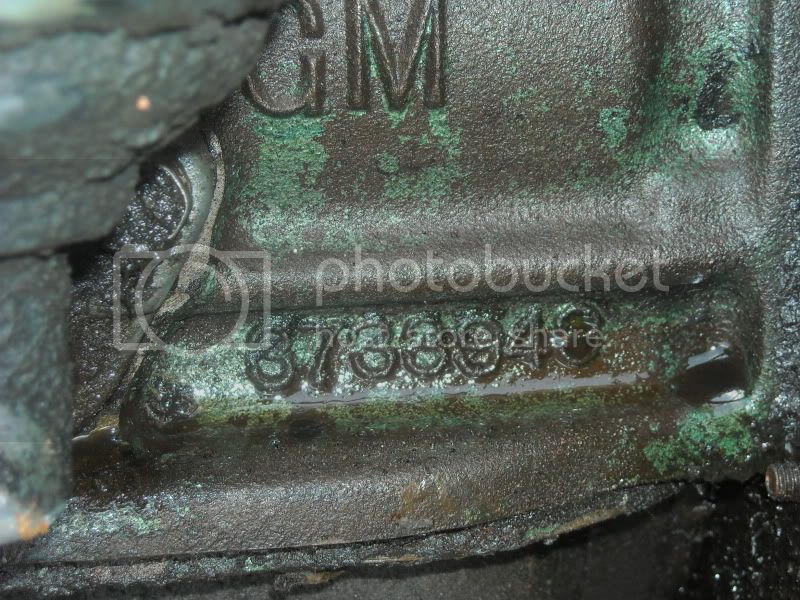

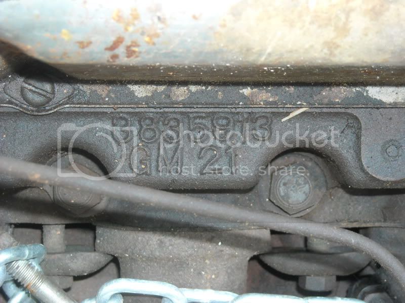

  4. ol' chebby
    3,167
    Here is mine...
    New engine...a 235.
    Casting # looks like July 18 58
    series# Inliners.org says this is a 55 block.
    serial#
    on the head..
    side of the head..
  5. ol' chebby
    3,167
    In taking it apart, I found that the oil tube to the rocker assembly is broken. Found another through Jim Meyer. Apparently I have the 54-55 block and 54-62 head.

    Actually no ~ as I read the block date , it's a '58 235 .
    I'm usualy wrong tho' so no worries .
    Now , whilst it's out, clean it and re - spray it GREY like it should be , when you attach all those luvverly black accessories it'll look sweet .
  11. ol' chebby
    3,167
    Yeah, the date does look like 58, however, the water holes behind the waterpump are the 54-55 configuration. Several sites say that the casting number is for the early block. These engines use the water pump like the 216. From what patrick's says, the 216 manifolds Fit but are too small.
