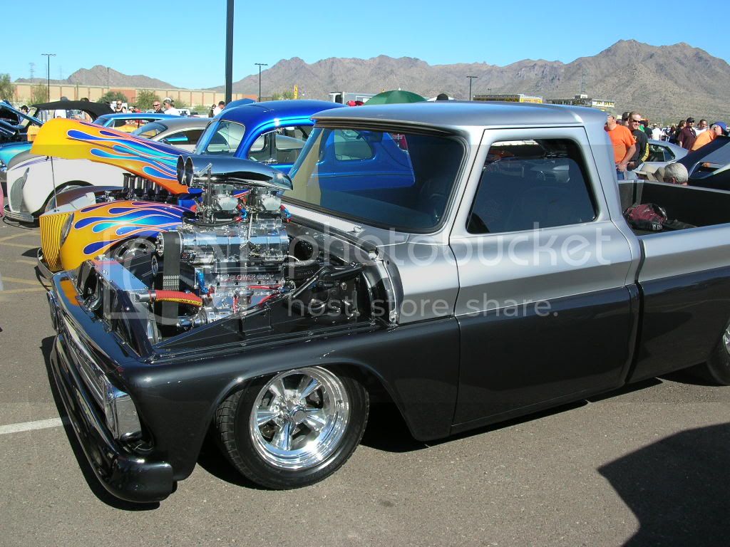

Will have to wait till we can roll it outside as the flash part of my camera gave up the ghost. We did a 66 that was loaded with options from the factory so will have something to compare the "Pricilla Factor" to. So far I kinda like the smooth one better. Pics of the 66 "with".
