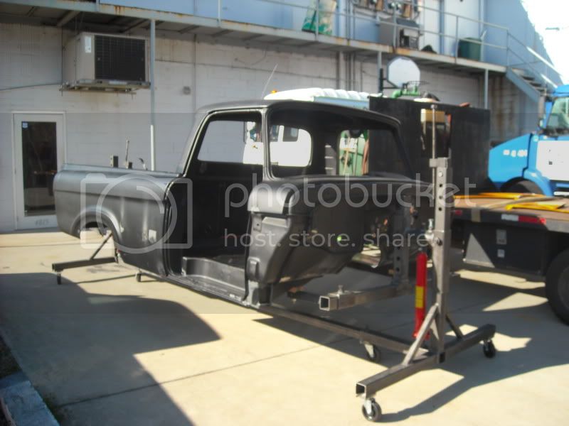

  4. ol' chebby
    3,167

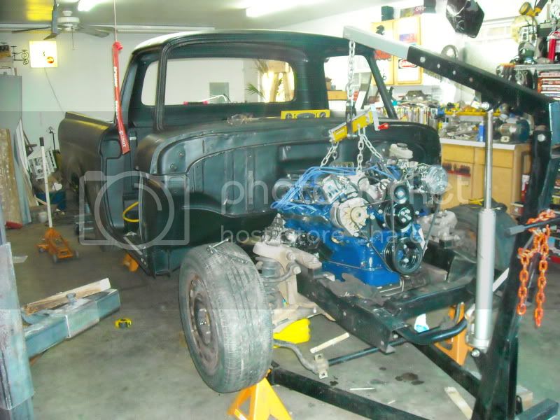

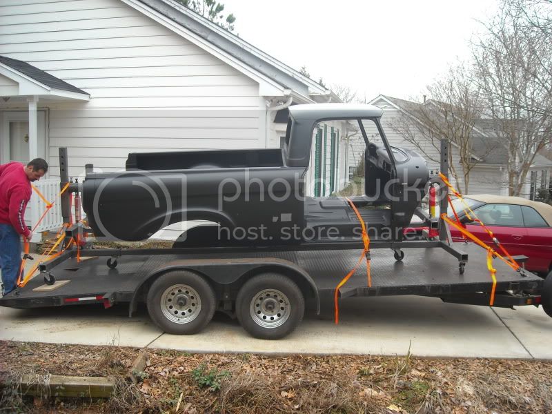

    Sooooo, the body came back from the sandblaster yesterday, the trans back from the trans guy, and back to work we go.

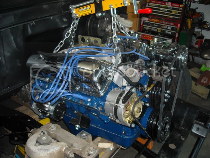

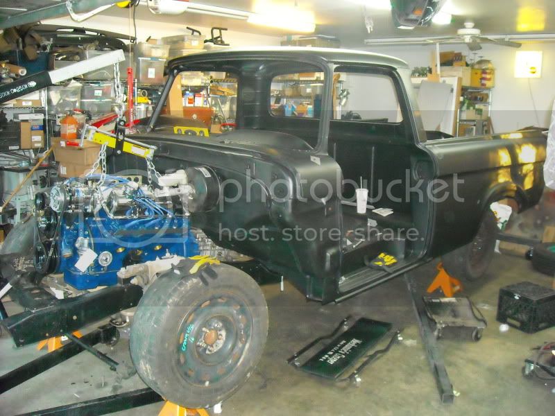

    The engine came in a week ago, it is NICE. It came from Tuff Dawg engines in Az. I would reccommend them. We got it and the trans mated up, then hoisted into place for a mockup. The factory engine mounting was over a bit to the right, so we are mocking it up close to this position. I have some Sanderson headers on the way that are supposed to be the tightest tucking headers you can buy for 390 FE. We need tight on the passenger side!

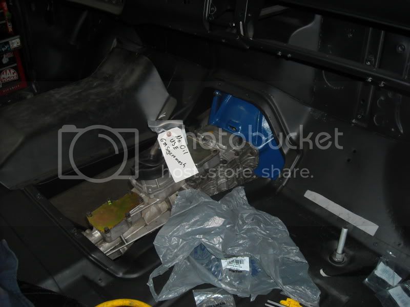

    That would be a Tremec 3550, converted to mid shift, and a shortened input shaft for the 390 bellhousing...

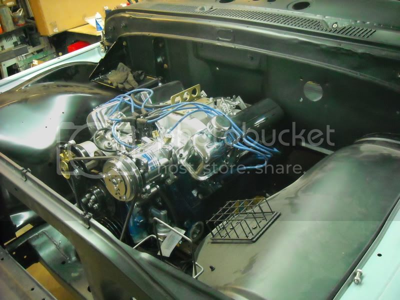

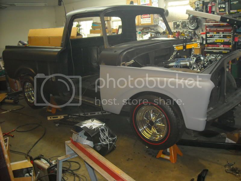

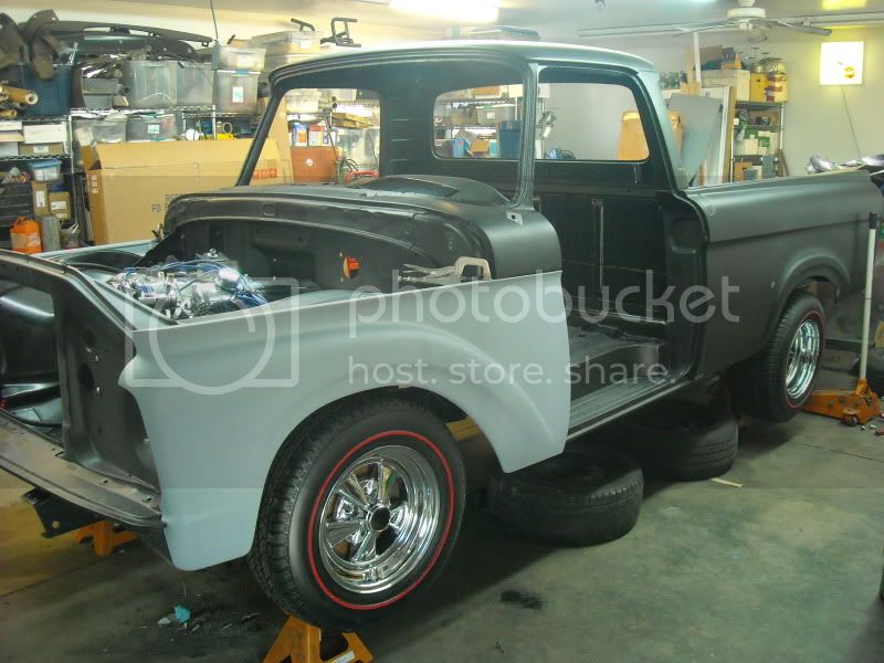

    Test hung the front sheetmetal and rims....
  9. Zig
    Looks like it's GOOD to GO. Now onto that ratrod GMC project!
    What's up with the suit feeder cage on the inner fender? I don't see how the birds are supposed to get to that. I'm sure this truck won't be rusting in a field with its hood up anytime soon, sooo.... ???
    Oh well~ ON TO THE GMC RAT ROD PROJECT! (With pictures!)
  10. ol' chebby
    3,167
    Not really shure what that is. It was there when we got the truck.....maybe its a furd thing.

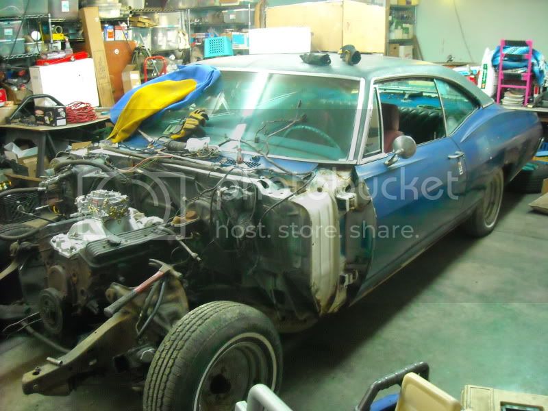

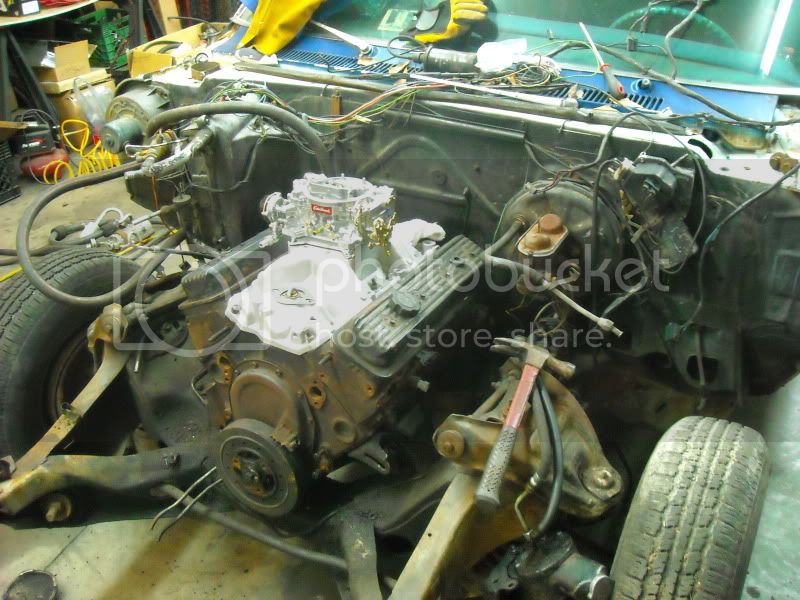

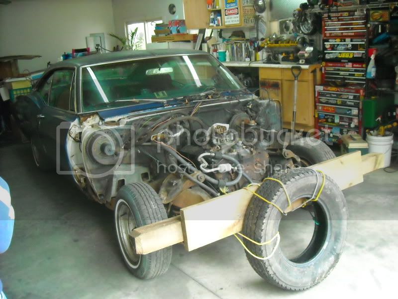

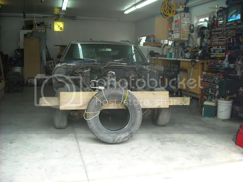

    .....and now for something completely different......we drug a 67 Impala SS from my neighbor's yard to my shop to "get her running" He is going to sell it, but wants id driveable. We have already installed a 350 from a 91 Suburban and got a clip from a 67 4 door (brought $319 from the scrapyard!) Some serious southern engineering for the push bumper to get it up the hill.
  20. federale
    federale Member
    517
    Washington C.H.,Ohio
    I hope you aren't going to use that hammer to knock off the valve covers. If you don't like em send em to me.:D
