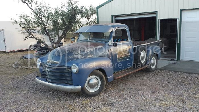

    crazy huh? i have to tilt the visor up some more. its a lil bit too far down and my sight line is at the bottom of the visor

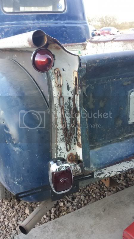

    im still here, just need tags and insurance and the truck can be on the road. i started a second job installin windshields, repairs and tint so time is limited. bright side is i can get some glass made for the truck and the boss will give me a hand installin it all.before anyone says it, havin glass cut is super cheap for me with the new job. i found some trailer marker lights and cut them off the mountin bracket and made them into my turn signals

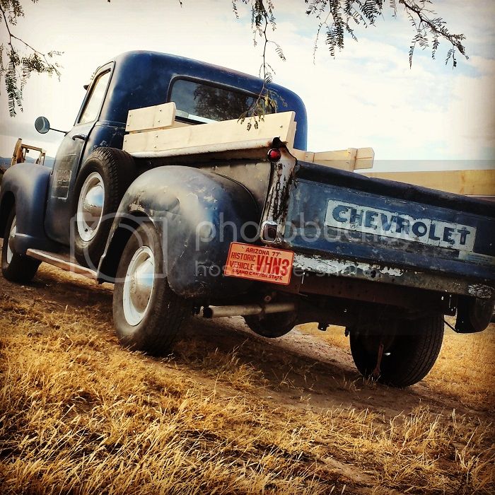

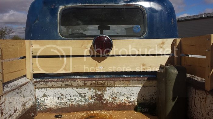

    todays project was puttin some wood in the stake pockets. came out good but i stil have to stain it or paint it. i have a 8inch-ish "stop" light ill install on the back rack.
  15. Zig
    That looks GREAT! So I think I found you adjustable wrench you've been looking for. It's hanging by some wire just inside the back passenger tire. ;)

    Stain and Tung oil that wood. I do 3 coats of 50/50 tung and turpentine mix, then 3 coats rubbed in 100% tung. Will not rot and is easy to touch up.

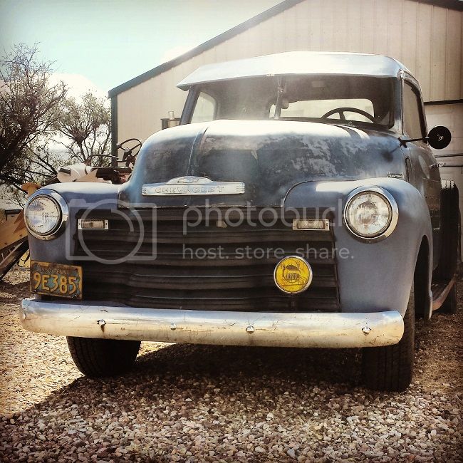

    installed my ebay stop light and ebay amber fog light up front. still need to wire them up. took the truck for a spin down the dirt road. was fun
  20. Kens 50 PU
    Way cool on the stop light! I'm loving that!
