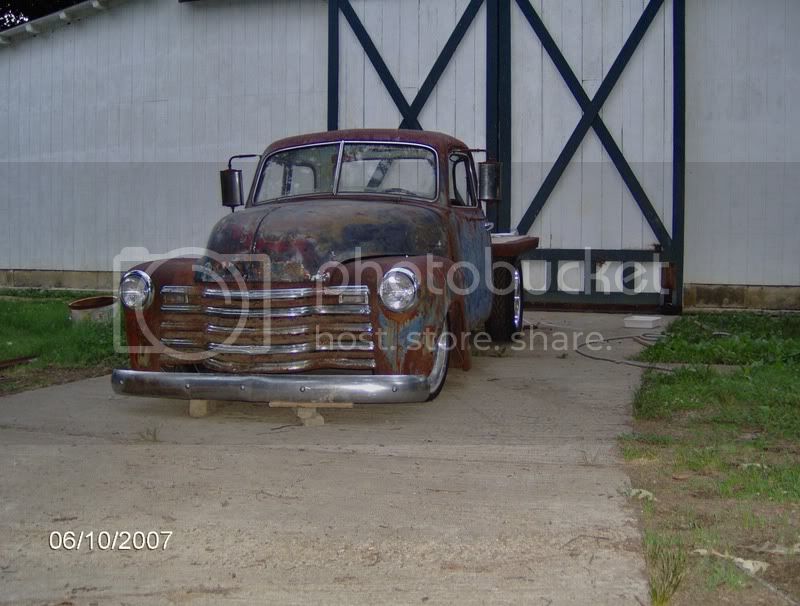

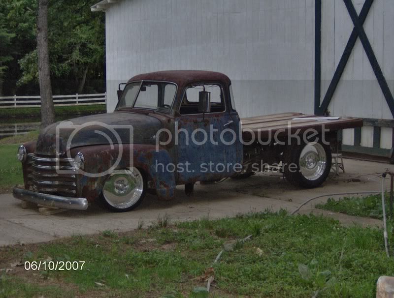

    Most recent pics.

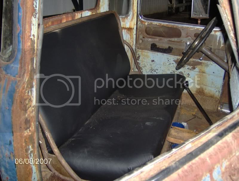

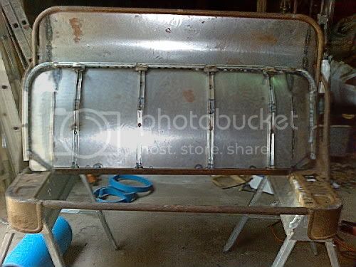

    Here is the seat. .....rust dust comes from everywhere.

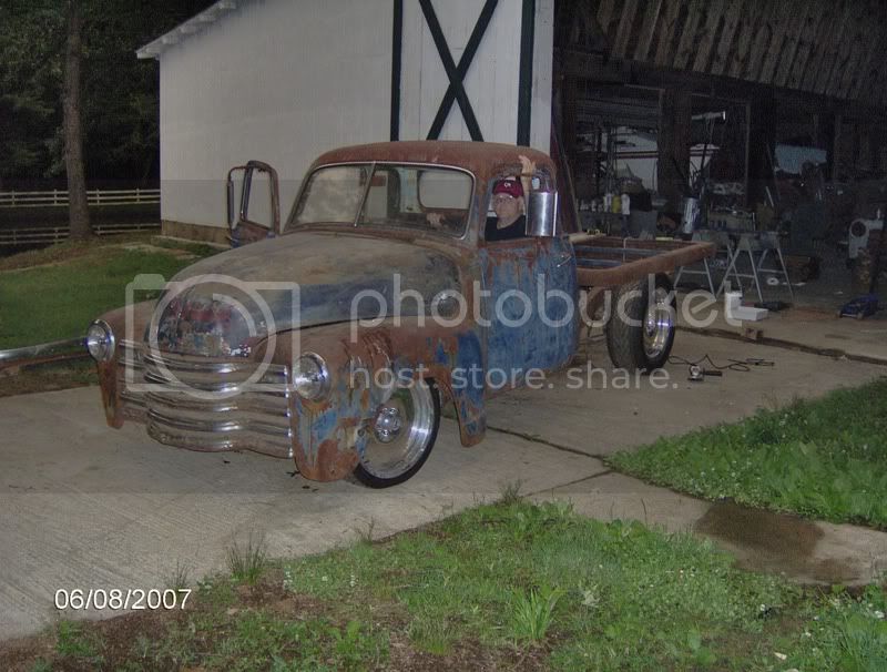

    Here's my dad making motor noises
    Workin' on the flatbed now.
    The front bumper is just mocked up for the pic.

    One question, who's in the seat? Flipper Sr or Flipper Jr? Irregardless, welcome back!!
  6. Flipper
    Flipper Member
    Oct 17, 2005
    133
    Its my dad.
    The flipper nickname started with me.
    I flipped a Suzuki Samurai 3 times in the same month and the guys at work never let me live it down (10 years ago?)

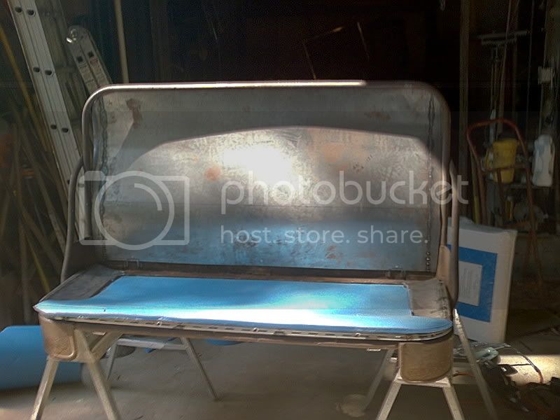

    Here's what the seat looks like under the vinyl.
    I used sheetmetal to form the seat back and seat bottom..
    There is a steel subframe under the seat bottom to help carry the load.
    The seat back and bottoms are contoured more like a modern seat and will be padded with a couple of inches of foam. (This is just the first layer. Bottom layers are gonna be dense, top layers something more cushy)
    It got 2 inches of soft foam on the back and about 5 inches on the bottom (1 firm and 4 soft).
    Doing the seat like this gains a bunch of interior space over the stock set-up. My seat back sheetmetal actually touches the back of the cab. I sit 3-4 inches lower and about 4-5 inches farther back.

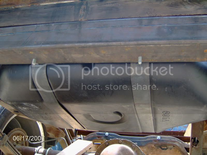

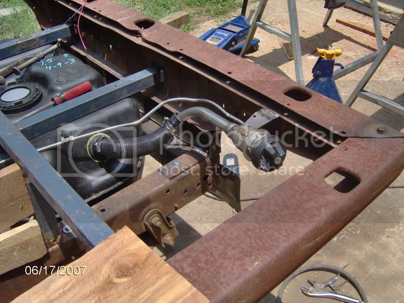

    I put some more time in on it this weekend. I got the gas tank mounted.
    It is a 2005 S-10 blazer tank (plastic tank...no rust flakes to deal with). It don't look like all that hard of a job, but it sure ate up the time. The filler neck is hidden under the edge of the bed.
    I also got the boards cut the go under the flatbed. I didn't like being able to see through the truck (under the flatbed)
