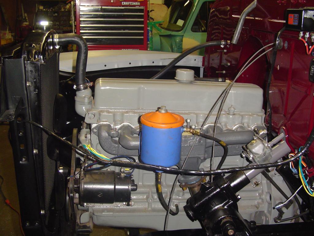

I hate to ask this question becasue it's probably simple. How the heck do you get these hoses off without kinking and tearing them up? When I took the old ones off my 216, they practally fell apart. No big deal since I was going to replace them anyway. Now, with my 235 that I'm rebuilding, I don't want to tear them up. These are practally new. Dumb question? Rick
Rick, one end of each hose should have a swivel type connector on it that will prevent the hose from twisting or kinking.
That's what I thought? Thanks Ken but no swivel on these hoses? Didn't have them on the old motor either?
At least one end _HAS_ to have a swiveling ferrule or they'd have twisted up upon installation many years ago ~ when new they're not loosey-goosey , take a close look and you should see .
I stand corrected...to a point! I went back and looked at the ones from the old motor "He never throws anything away" They had swivels! These do not. I'm wondering now if they were made up on the motor (new hoses slipped over a barbed fitting)? I'll send a pic later. I can't seem to get them out the way they are so I might end up cutting them to see what's up.

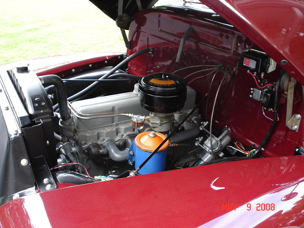

Compression fittings? Those look like some kind of compression fittings. Here's a pic of my setup on my truck. The swivel ends are attached to the canister.
Who knows Ken! Thanks Ken, They're comin off there tomorrow...then we'll know. My old ones did have the swivels. I think these were made up on the motor. Again, I'm thinking slip onto a barbed fitting...nice if you never plan to change them. I'll let ya know! Rick
Hoses Rick ; Take a look at the old hoses , the crimped part at each end can be carefully cut away and then slipped off along with the old leaky hose to reveal standard hose barbs , get some new oil resistant hose and clamps , make up your own hoses then order up a set from Chevy Duty as they sell them cheaply .
Barbed fittings Just as I suspected, these hoses were installed on the motor with barbed fittings in place. Thanks for the help, Rick
