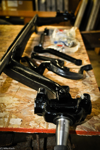

  5. Coach529
    Coach529 Member
    Oct 2, 2012
    585
    Jamestown, ND

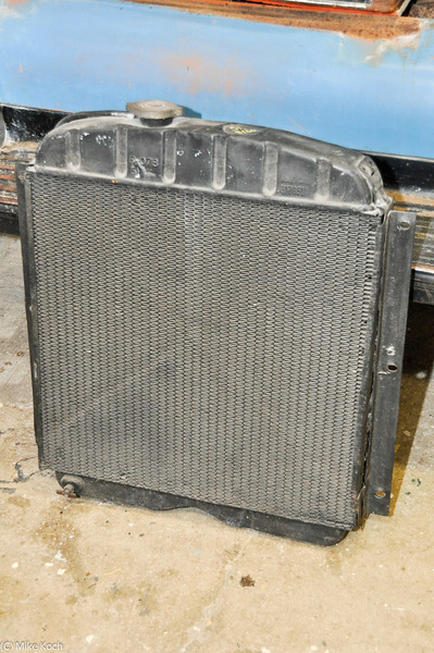

    Not much new on the project. Just stacking up parts for when I have some time to get some stuff done.
    My radiator from Gulfstream87 over at HAMB showed up this week.
    I also received my dropped axle from Sid. Everything looks great. I got the whole meal deal from Sid. All new modern tie rods ends, drag link. New installed King Pins. Should be better than new.
    I ordered my new U-Bolts online last night. Need to order some caster shims and I should be almost ready to go.
    I need to go to the local junkyard and find some Chevy 5 bolt steel wheels with some rubber on them for rollers for now until I decided on what I am going to run.
    Also need to find a rear end and figure out what I am going to do about a driveshaft. Probably end up with a 4 x 4 S-10 rear end.

  9. Coach529
    Coach529 Member
    Oct 2, 2012
    585
    Jamestown, ND
    Thanks Damon. Sid did a great job with modifying the axle and steering arms. Dealing with him was painless and straight forward.
    Cannot wait until I gte to assemble it all.

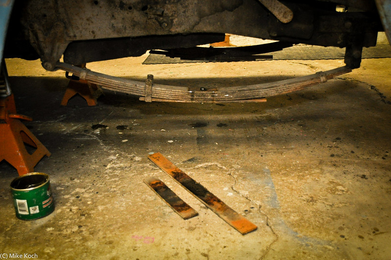

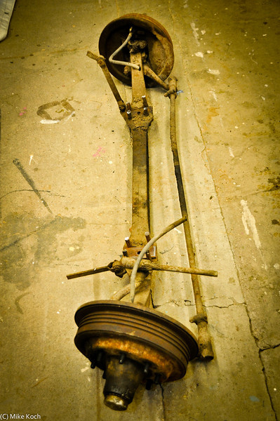

  16. Coach529
    Coach529 Member
    Oct 2, 2012
    585
    Jamestown, ND

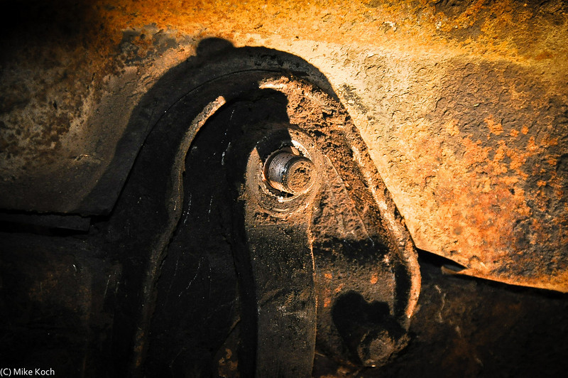

    Despite water pump issues, we are still making forward progress.
    Time to install the new Sid's lowered 1/2 ton axle.
    Height reference picture!!
    15 minutes and a grinder with a skinny wheel and the stock 3/4 ton axle was out.
    The ultimate goal is a 5"-6" drop. The axle is 4" drop, so the remaining 2" of drop will come from tires and removing some leaves from the spring pack. To start I removed 2 from the bottom of the stack. The spring retainer bolt came out easy, but I replaced it anyway.
    Today I need to round up a puller for the steering arm and start installing the new stuff!!

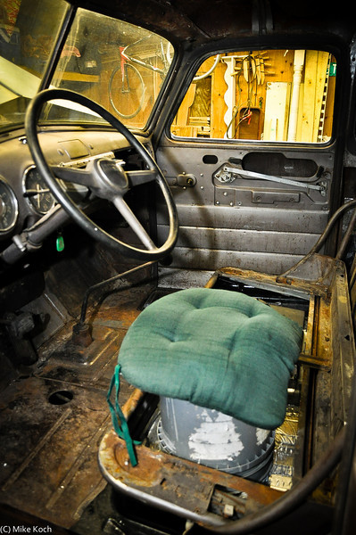

  17. Bill Hanlon
    2,792
    Morris Ranch TX
    I didn't know you were convertingt to bucket seats.
  18. Zig
    Good one, Bill! Adjustable as well~ ;)
  19. Coach529
    Coach529 Member
    Oct 2, 2012
    585
    Jamestown, ND
    High quality buckets.....with a handle. :)
