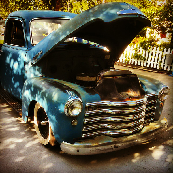

    Sorry if I missed it but can you give details on the radiator. See that's it's champion. All aluminum? Rows? Etc? Have a 350sbc with an old radiator I need to replace. Thanks
  5. Coach529
    Coach529 Member
    Oct 2, 2012
    585
    Jamestown, ND
    Champion 3 row purchased off Ebay with a 16" fan. Fit and finish is really good. I am really pleased so far.

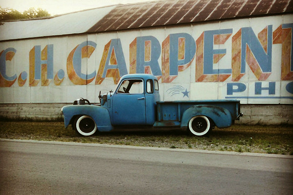

    Another huge hurdle has been crossed!! Henry is BACK on the road.
    I finished buttoning up the torque converter and flex plate issue and bolted on the brand new driveshaft. I double and triple checked everything and dropped him down on all 4 wheels.
    Fired right up and I checked the tranny fluid. After adding some I backed him out of the garage!! Huge smiles!!! :metal:
    A couple spins around the neighborhood and more checking of nuts and bolts and I advanced the timing to get rid of a pesky miss right off idle. By the end of the night I had it running really good......I am hitting up my local repair shop tomorrow and check the timing and take a look at the carb. They specialize in hot rods and race cars.
    Still not 100 sold on the exhaust.......It is a little loud and I get a resonation at certain RPM's that will drive me nuts. Hoping some dynamat on the floor will help.....other wise new mufflers.

    Congratulations! That picture is pretty cool too.

    I am hoping to get it all buttoned up and take it out with my real camera tonight.....

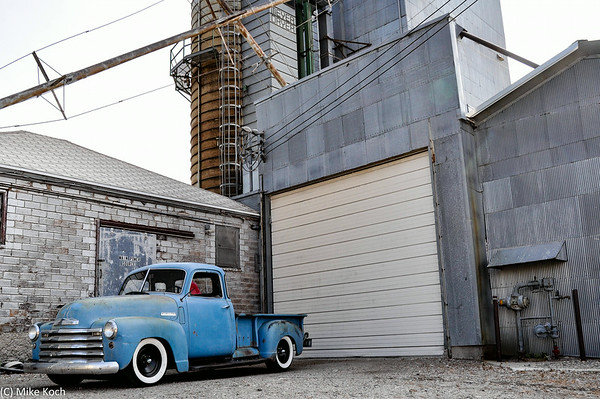

    Great news, Mike! If you have time, maybe a short video of it running the roads?
    Looks like you and your sons found a great destination! As always, awesome pictures.
