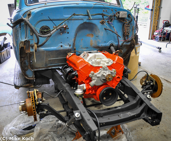

    Spent some time today cleaning up the frame for paint.
    63 years of grease, oil and dirt covered the drivers side. Between a wire wheel on my 4-1/2" grinder, a putty knife and a healthy combination of degreaser and some hot water I got it clean.
    I fought rain showers all day....
    After the degreasing and cleaning I sprayed the frame down with KBS Rust Blaster and rinsed it again with hot water.
    I rolled it into the shop and let it dry for a couple hours and brushed on a coat of KBS Coatings Satin Black. Turned out pretty good. I will follow up with a couple more coats over the weekend.
    All my gaskets and misc parts showed up for the 350, so I hope to start buttoning that up this weekend as well. Maybe even get it painted!!

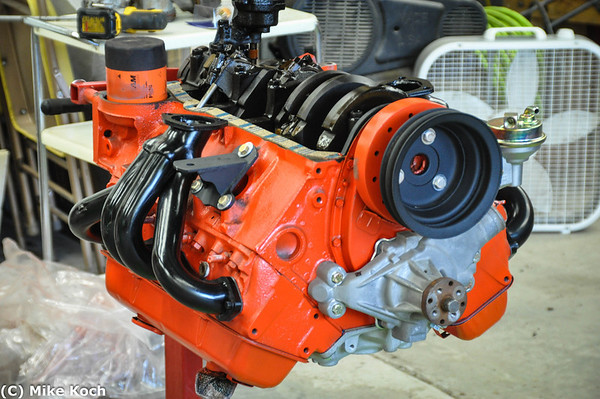

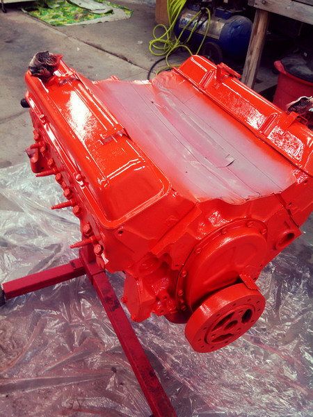

    Crazy busy weekend......but the motor is in primer.....

    what color are you going to paint engine? if your going to keep engine stock looking i have a pair of chevy script valve covers
  13. Coach529
    Coach529 Member
    Oct 2, 2012
    585
    Jamestown, ND
    Chevy Orange. What color are you valve covers?

  16. Coach529
    Coach529 Member
    Oct 2, 2012
    585
    Jamestown, ND

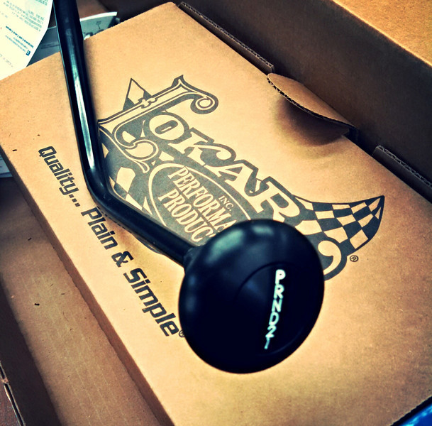

    Motor is now orange......
    And my Lokar shifter showed up.......whoohoooo

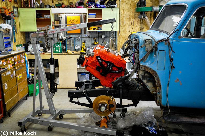

    I took the day off work and got some stuff accomplished.
    I ended up damaging the rear brake line when I put in the tranny cross member, so I re did that. The passenger front brake line was routed next to the old tranny cross member, so that had to be redone as well.
    I drilled the holes and bolted in the new transmission cross member. I bolted on the new aluminum intake to the SBC, as well as installed a new oil pan gasket.
    I installed the stall converter on the TH350, and was ready to bolt the flex plate to the engine when I realized the bolts are 7/16" fine thread. None of those in my bolt bin.
    Oh well.......I will get it done tomorrow and toss the motor and tranny in.
    My HEI Distributor and plug wires showed up from Speedway. Sure nice having those guys only 1 shipping day away.
    I am running an aluminum water pump, measures like a short pump. I picked up a pulley today at the junkyard, but it looks like I would need to space out the pulley 5/8" to match the crank pulley. Does not make sense. The pulley came off a mid 70's GMC truck with a SBC.
    Any advice on mufflers? I plan on piecing together the exhaust myself. The local muffler guy wants almost $500. I can weld and bend pipe.......only concerned about flaring.

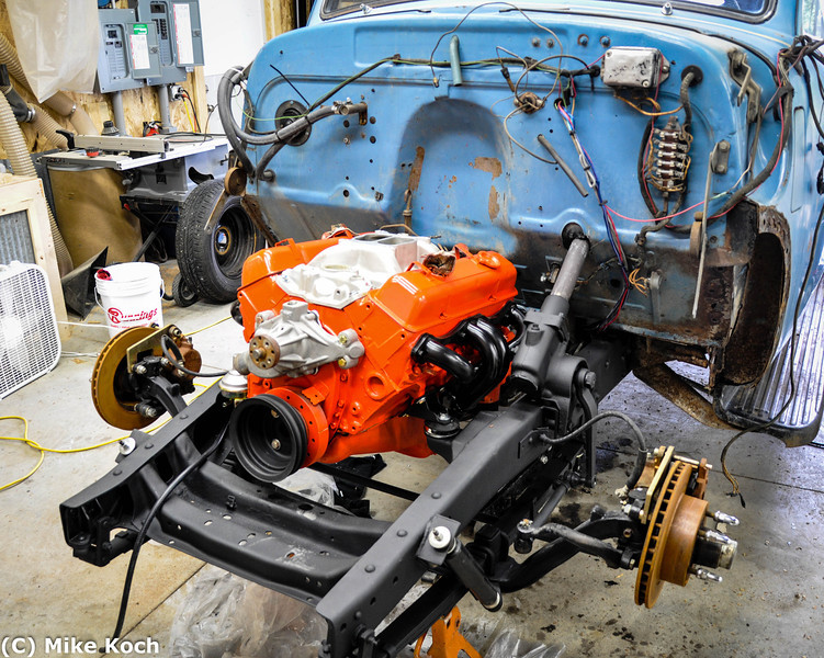

  20. Coach529
    Coach529 Member
    Oct 2, 2012
    585
    Jamestown, ND

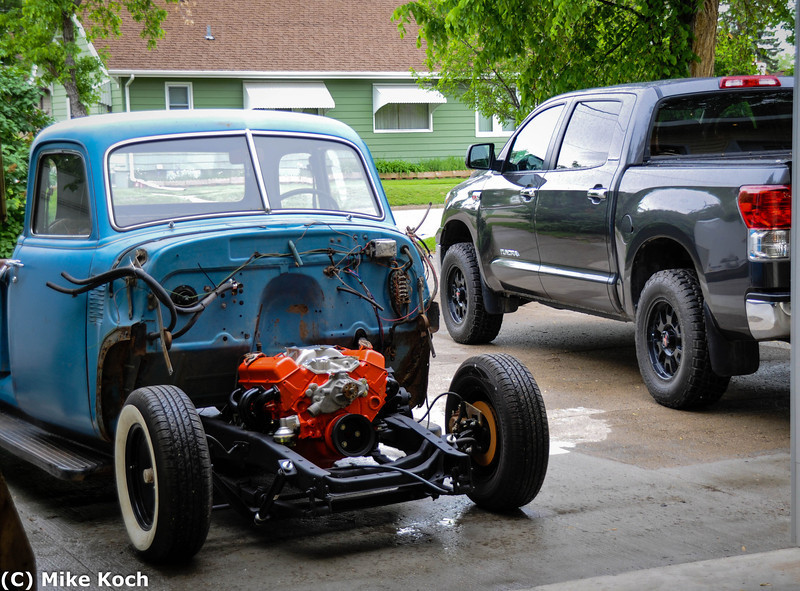

    Pretty good day despite distractions and multiple trips to the hardware store.
    Got the bolts to mount up the flex plate and got the tranny attached to the motor.
    Everything went together fairly smooth.
    I did overlook during mockup that the fuel pump would hit the frame. A quick cut with the jig saw and some grinding and it was fixed.
    Off the jack stands and pushed outside so I could clean out the shop!!
