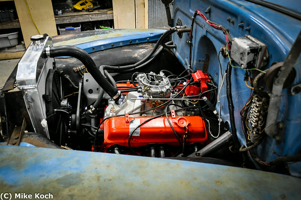

    Spent the last couple nights in the garage trying to get tings buttoned up.
    Last night I got most of the wiring done.

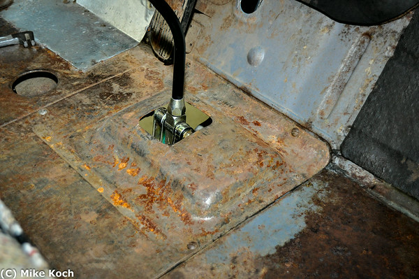

    I mounted the Lokar shifter. Looks I will need to buy the additional kit to ket the shifter a little further away from the seat. I have 3 people in the cab fairly often......the leg room can be an issue.
    Today after work I crawled under 20+ mid 70's 2 x 4 chevy and gmc trucks looking for a driveshaft and yoke for my TH350. Found the yoke, but no driveshafts.
    Also found a good donor for a long pump and alternator brackets!!
    When I got home I cleaned everything up and gave it a rattle can facelift.

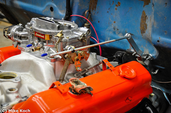

    I mocked up my throttle linkage, along with bolted up the bracket for the TH350 kickdown cable. The cable itself is short. Not the housing, it reaches fine, but the physical cable seems to short even after adjusting it.
    I assume they come in different lengths?
    I am pretty happy with the linkage, although the pedal sure feels different than compared to the old 6 cyl carb. Pedal travel is minimal.....

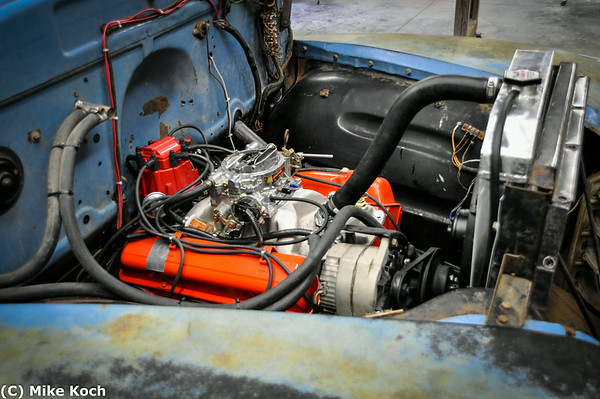

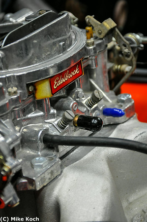

    If I may make a suggestion.... Throw a rag or something over the carb. Makes me nervous having it open to the world like that.
    You can make a nifty maintenance cover out of a piece of tupperware, I have one in my shop, fits like it was made for it.. with the wife's blessing of course. ;)

    Great advice. Typically I always keep it covered.....I just took it off for the picture.

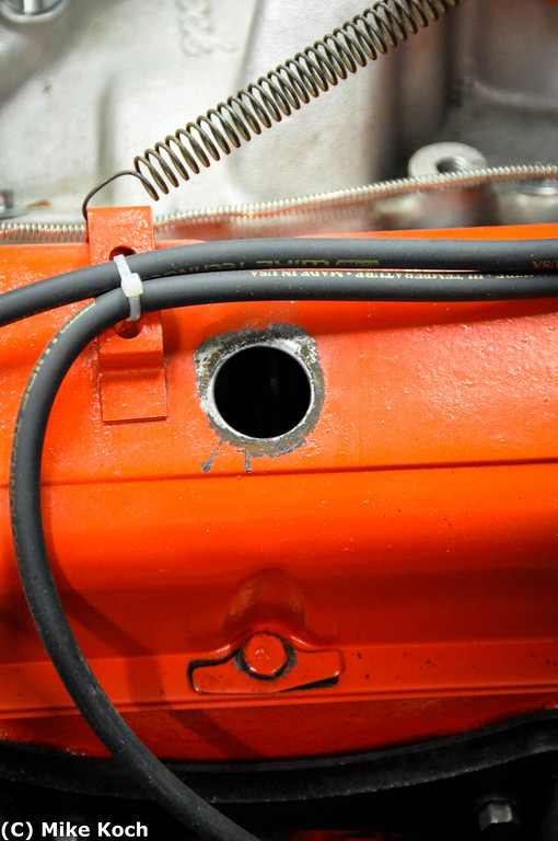

    The stock valve covers have 7/8" holes. Any ideas on breathers for them?

    Got my Lokar with Bell Crank kit all installed. Pretty slick set up. Happy with the install. Pumped it all fit through the stock floor hole.

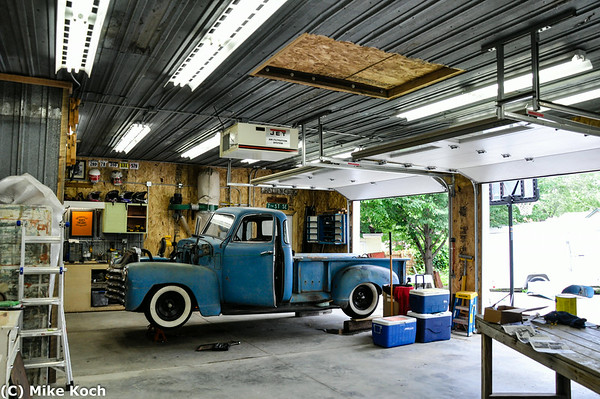

    Henry made it out of the garage tonight. Still waiting on a damn driveshaft though........guy promised it will be delivered tomorrow.
    Exhaust is done after a couple redo's......still not 100% happy with it. Sounds good, but a bit loud for my taste. Probably cut in a crossover pipe to tone it down a bit.
    http://kustomcreations.smugmug.com/Other/Old-Truck-Project/i-4X6C4Pv/A
    Timing is too far advanced, I messed with it a little bit, but still pops a bit through the carb just off idle. Once I get it drivable I will have to run it down to my repair shop and have him time it and set the carb. Also running on a bit. Not sputtering, or dieseling....just running for 5 seconds after the key is turned off. ??????
    Not getting any juice from my junkyard alternator. :-(. It is a three wire out of a 70's truck. Big red to battery, small brown to switched hot, white to nothing? Sound right?
  16. Bill Hanlon
    2,792
    Morris Ranch TX
    I think the white (#2 small connector on alternator) wire needs to go through an idiot light in order to work.
