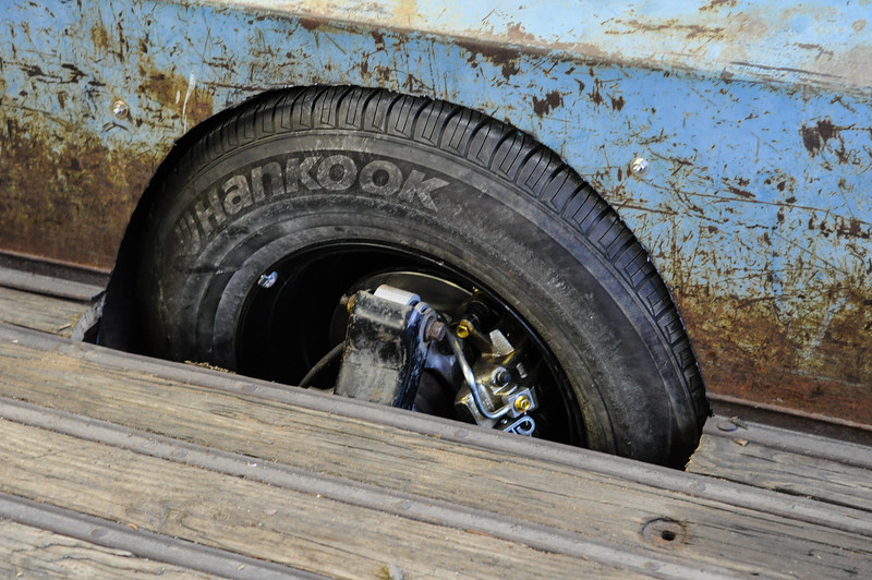

What is the item with 2 wires coming from it in the picture? The Pressure switch that came w/ my Wilwood proportioning valve has two blade terminals.

That is the pressure loss sensor, actually only one wire coming out.

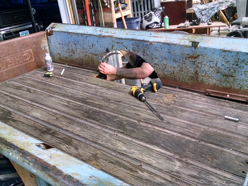

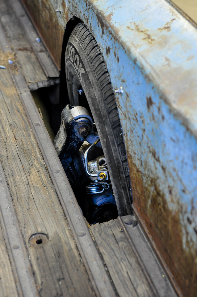

Busy night in the garage.
I had some help and we got the bed sides cut out for the wheel and UCA clearance and got the bed mounted.
I did not anticipate removing so much material. The bedsides clear the tires now but just barely. I will probably take out a bit more to have some clearance. I will also have to remove some of the fender flange.
Evidently, the wheels move a lot more inboard at the limits of the suspension arc than one would think. In retrospect, could you have spaced the wheel and tire OUT a bit, so it wouldn't get into the bedside? You aren't running a lot of rubber...
Keep up the progress!
Spacing out might have been possible, but the upper control arm would have still come in contact.

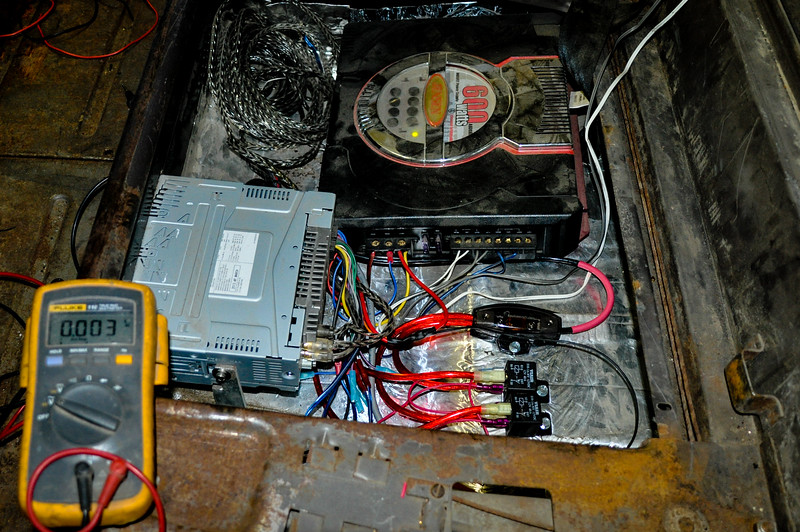

Not much photo worthy to report. Getting everything wired up. Battery will be in an old Hamm's cooler in the box. Running battery cables, etc.
Relays for my compressors are under the seat with my stereo stuff.

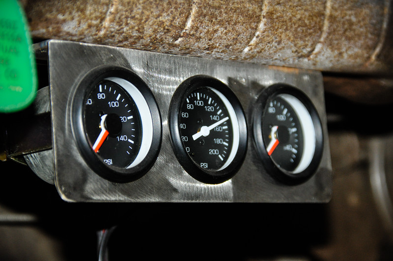

Those are dual air brake gauges , correct ? .
Why ? .
Obviously I know bupkis about air bags #rolleyes# .
O.K. , let me try again :
It appears that each side gauge has two needles......
You need to measure pressure at each bag.
Right gauge is front RH bag pressure (Orange Needle) and rear RH bag pressure (White Needle). Left gauge is front LH bag pressure (Orange Needle) and rear LH bag pressure (White Needle).

They are air brake gauges , now I know why .
