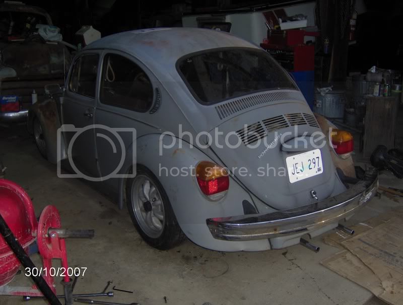

***Update (w/pics) on rusty/ratty 48 ***
Discussion in '1947-1954' started by Flipper, Jan 8, 2007.

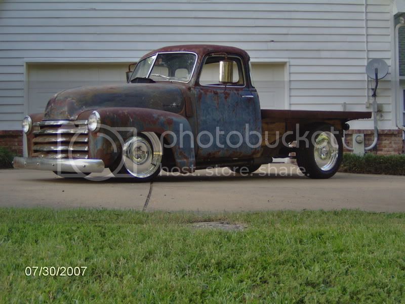

  1. Zig
    Ground hugger!
    That couldn't get much lower if it tried! Great job on that~ Now go to the lumber yard and load up!:D
  2. Flipper
    Flipper Member
    Oct 17, 2005
    133
    It is really not very low. It still has 4" or so of ground clearance.
    My bug is MUCH lower. It has less than 2" of clearance.

    This one is a remarkably solid car that almost got crushed.
    It was advertised as a rusty bug for $200. The only rust is surface rust where somebody had started sanding and shot just a little primer on the spots they sanded. There is NO rust through or even serious pitting....not even under the battery.
    I offered the guy $100 and he took it.
    I have since added dropped spindles and disc brakes on the front, narrowed the front beam 5" , put on smart car tires, and freshened the motor (new piston set and valve springs).
    I'm still under the $1000 mark!
    I would LOVE to find an AD in this shape.
  6. vwnate1
    11,703
    You STOLE It !
    VERY good deal ! so , what year it is anyways ? .
    I assume a dual port 1600 engine ? .
  7. Flipper
    Flipper Member
    Oct 17, 2005
    133
    1974.
    Way to new for my taste, but it was too good of a deal to pass on. I'm gonna make some changes to give it an earlier feel.

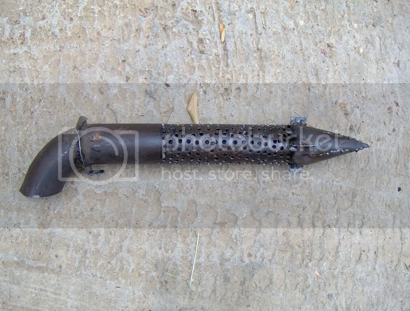

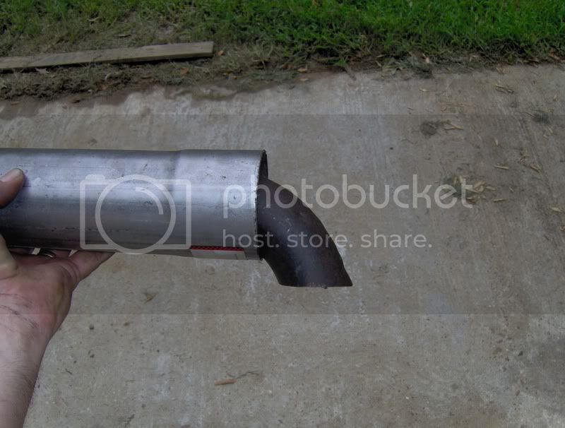

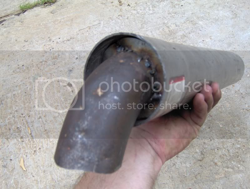

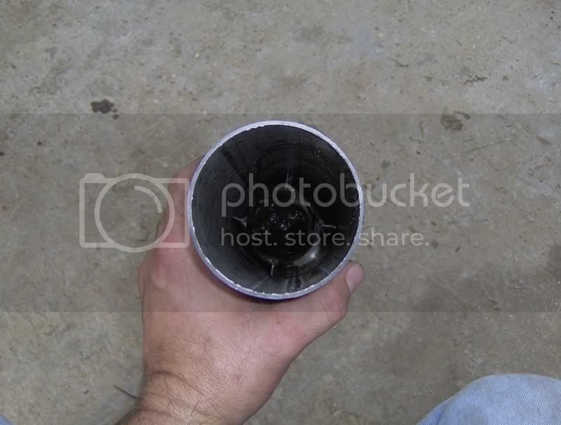

    Dad was hot rodding around the neighborhood and somebody called the cops on him.
    They didn't figure out who he was or where he lived, but they were driving around for quite a while and set up radar in the area for a couple of days.
    He dodged the bullet that time, but didn't want to get it out with the loud pipes again.............so we made silencers from left-over hearder tubes and other misc junk.
    They look like crap, but they work good and can be removed in 15 seconds.

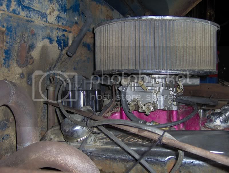

    I also modified the air cleaner base so that it was no longer low-profile...it now clears the distributor cap/plug wires.
    before:
    after:

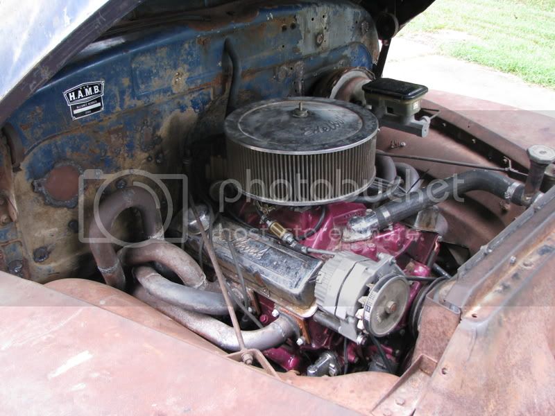

    I'm Curious
    As to why you're running a power steering pulley on the alternator and thus drastically reducing the charge rate......:confused:
  18. Flipper
    Flipper Member
    Oct 17, 2005
    133
    It is a Moroso alternator pulley. This motor has a nasty habit of slinging belts at 6500-6700 RPMs.
    It did it in the camaro that this motor used to be....and it has done it in this truck. So far the latest altemator mount with the turnbuckle for tightening seems to help. It has gone 7000 RPMs a couple of times and kept the belt.
  19. vwnate1
    11,703
    Thanx ! .
    I don't ken the belt tossing at only 7K RPM's , maybe slight alignment of pulleys ? .

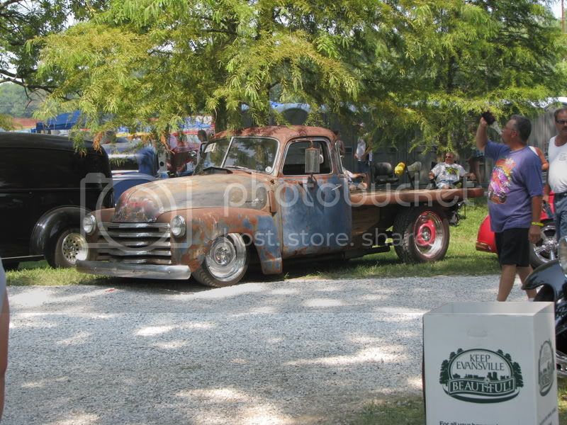

    We made it to Frog Follies ! ! ! !
