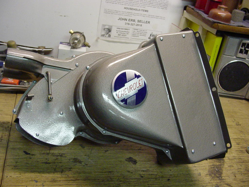

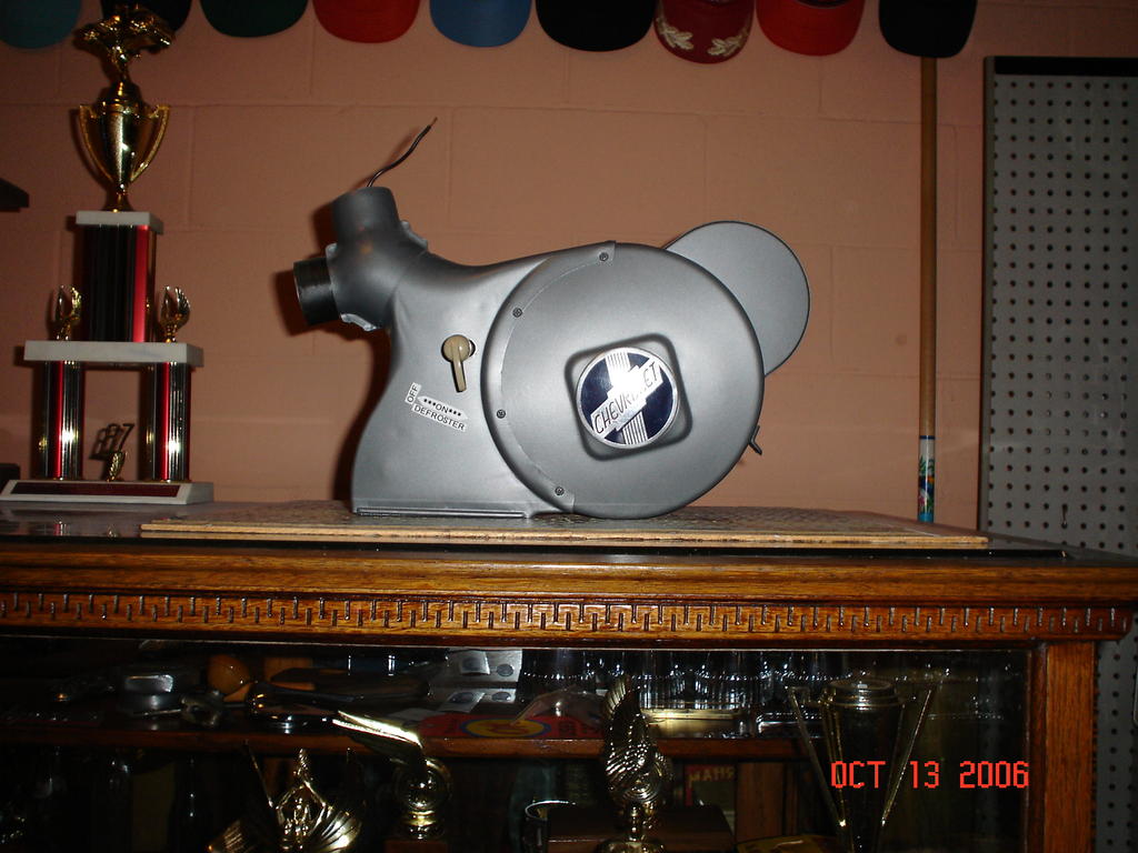

  4. Kens 50 PU
    Wolfgang, Chevy offered 2 different heaters for these trucks, but there were also many different aftermarket heaters that could be modified to fit. The first picture is of a "fresh air" or deluxe heater. The second picture is of a "recirculating" heater.
    If you have the deluxe heater, there is a good tech article on restoring one of these on Deve's website.
  5. Zig
    Nice trophy case!
    Hey big brother~ is that the Piston Cup trophy I see in that trophy case?:rolleyes:
    :D
    Well done heater, of course!:cool:
