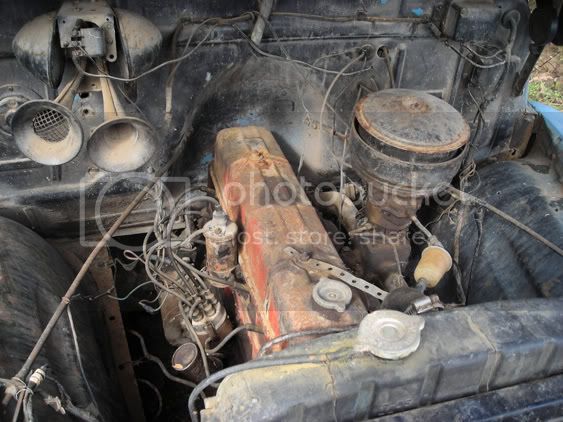

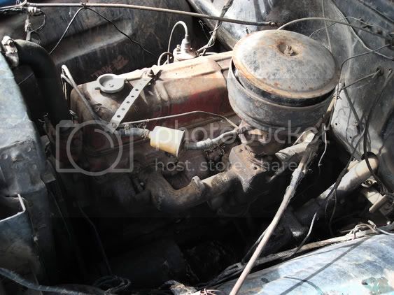

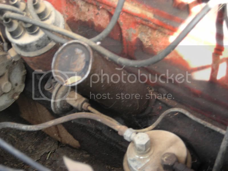

    ok, so i had no idea what thing thing was, or what it did. i noticed it in the manual, so i figured it was a standard thing, but i'm still a little hazy on why it's there, so maybe you guys could enlighten me some more. what the heck does PCV even stand for?:confused: here's a bunch of pics from lots of different angles. hope that helps.:)

    PCV (Positive crankcase ventilation) Very Very important to have. I don't know a lot about the older engines but all PCV's are the same. Without this your engine will build too much internal pressure and blow out oil at any given gasket. If you fix one leak it will create another and will be a vicious cycle from there:mad: . So whatever you do keep the PCV in. Nate will be able to go into more depth with these engines. Hope this helps.

    What it will do is : cause your engine to explode so you'd best remove it carefully and mail it to _me_ for proper disposal.... :D
    Yeah , right ! :p the PCV valve proper is the black rusty cylinder screwed into the brass elbow sticking out of the breather , soak it well to clean it out , don't be worried at the amazing amout of toxic waste that drains out of it . a PCV system keep the inside ofyour engine clean and a clean engine is a happy engine that loasts longer and rund better too .
    You should consider cleaning out that big old breather tube too ~ it's full of baffles and sludge ~ remove it and send SWMBO & the kids off for the day , drag out your old charcoal BBQ and stoke it to red hot , lay the breather tube on the grill and close the lid , let if cook for a few hours , it'll begin to smoke & stink something fierce so be _sure_ SWMBO isn't going to come home soon ! . once cooled down , tap it to shake out all the burned ash , DO NOT EVER bead blast a breather ! .
    I notice you have a " Dual Action " typ fuel pump ~ this is a great find , what it is , is this : a vacuum pump built into the lower half of your fuel pump , it will ensure your vacuum wipers run perfectly at all speeds and loads ~ obviously someone liked this truck and equipped it properly ....
    Engine idling , test for vacuum at each of the ports on the bottom half of the fuel pump . you'll be wanting to connect this and I'll tell you hoew if it still works . if not , don't panic , just mail it off to a vintage fuel pump rebuilder .

    just want to make sure....
    ok, so i pulled the whole thing out yesterday, and i'd like to make sure we're clear on what's what, so i'll post another picture.
    correct me if i'm wrong, but i'm thinking i should remove "B" and unscrew "C" from "D"??? then bake "C", right?? "A" is just a part of "B" that won't come off?? just don't want to cook the wrong part, not that anyone would ever make that mistake, i just don't want to be the first one. :D thanks!!

    I Vote for #E which is above the brass nipple on #B That is what you want to get apart. Must likely stuck but with some little Love and Care will come apart. Sometimes help's to turn some the other way then try and loosen. Other times get out the smoke wrench just be careful. Best to get the unit out of the truck and on a bench. Good Luck !
