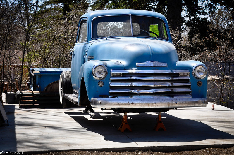

    Little or nothing in the form of forward progress this past weekend.
    RH front shock is mounted but I did not get around to the LH side.
    I drove all over town and got stuff from all three auto parts stores to get my all my brake stuff lined up.
    Thinks I have all the fittings I need to get it done....hopefully!!

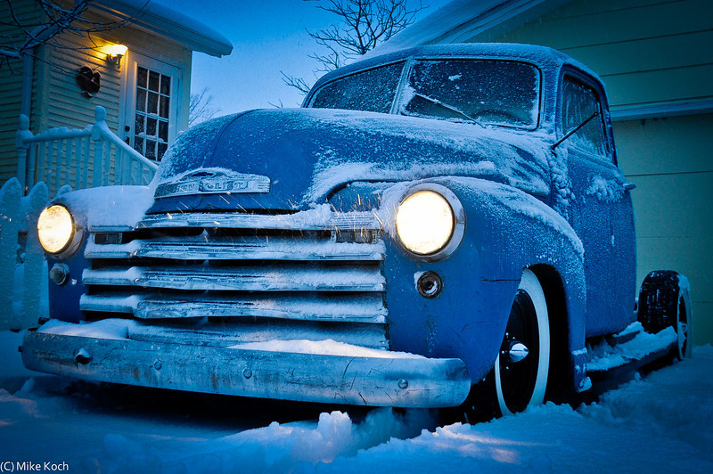

    Today I was working on some other projects, so Henry go pulled out into the driveway. 8 hours later....we had 8+ inches of snow. yuck!!
