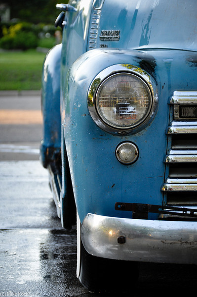

Mike, your truck looks absolutely fanfriggintastic! I get the idea that you and Russ need to put your trucks in a show together. A little pin striping maybe?
All that work you did gave it a real nice stance!

Thank you!!
Yes pin stripping is on my to do list for sure. Not a lot......but just some accents here and there. Wish Russ was closer.

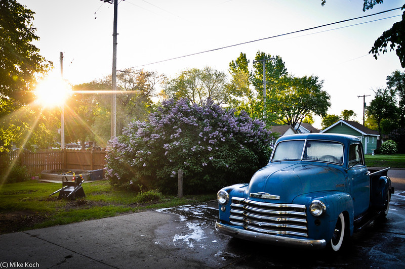

Awesome!!! I love to see it hauling stuff. That is what these trucks love. Oh to see the north side of 50MPH let a lone 70;)...
Fantastic job! thanks for all the pro pics as well. I really enjoyed them!

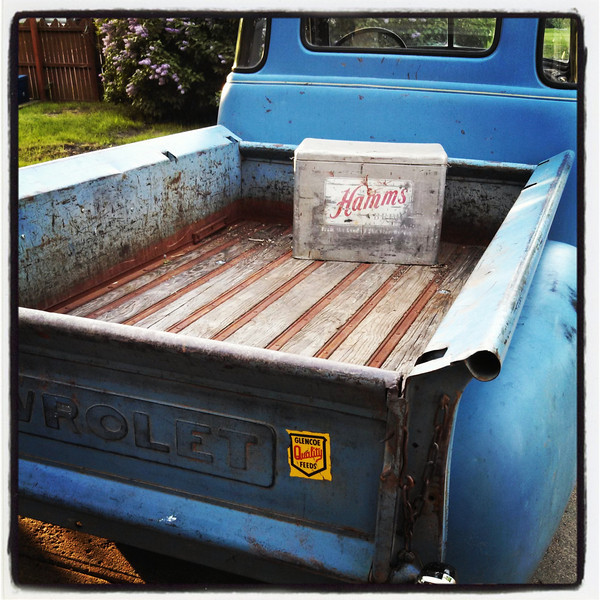

wide whites
your truck is sure looking good the wide whites sure change the look
...and for some strange reason, I really like they way those yellow stickers on the tailgate give a bit of interest.
