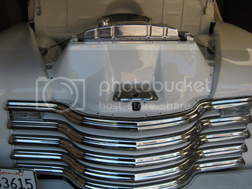

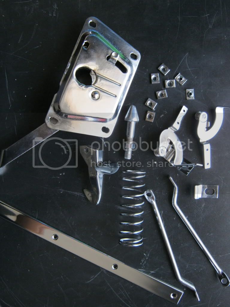

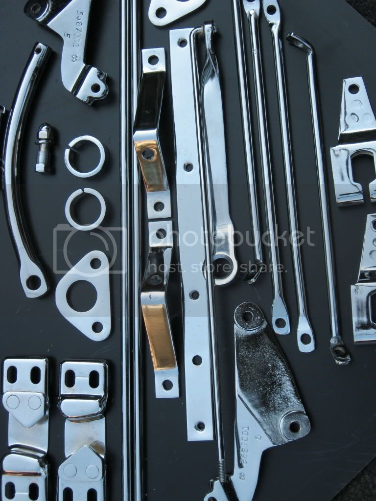

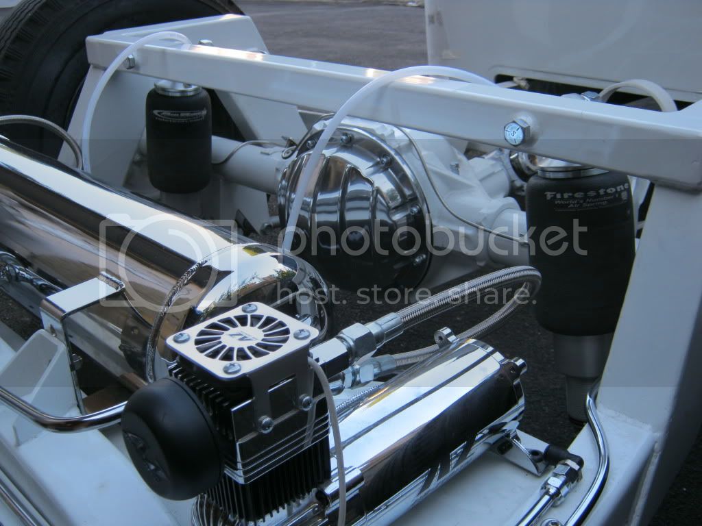

    Some parts rechromed, just handed to me
    Other parts rechromed

    Very nice work and build. You have much talent. What shop is doing your chrome?
  6. Frank64
    Frank64 Member
    Dec 26, 2011
    53
    Thanks Skipper.
    The shop that did my chrome is very expensive. For those pieces that you see in the picture (Only the first photo, not the second) and the inner windshield molding
    I waited 3 months and I spent 390$
    Frank

    Frank~ Your truck is BEAUTIFUL!!! That chrome looks fantastic, as far as I'm concerned. Pricey, yes~ But WOW!!!

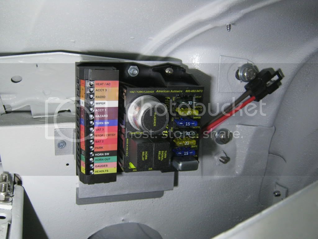

    Hello to all,

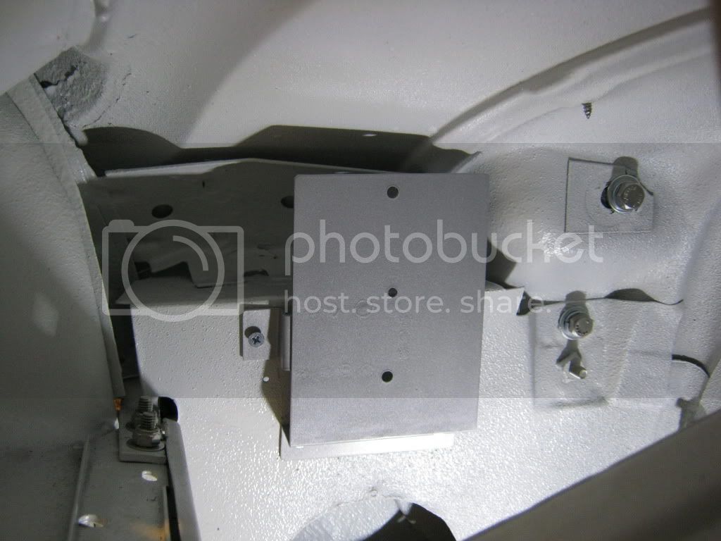

    after deciding the best place (for me, under dash, driver side)
    to fix the fuse box I created a bracket because I did not like leaning
    FUSE BOX LOCATION
    AmericanAutowire 15 way kit

    Was wondering why the use of a drywall screw to hold your bracket for the Electrical Fuse block. Do you have access to some stovebolt screws or pan head or hex head, ( http://www.boltdepot.com/fastener-information/Type-Chart.aspx) or other than? Was just wondering seeing all the chrome plating you have done so far.
  14. Frank64
    Frank64 Member
    Dec 26, 2011
    53
    Thanks Ccharr,
    the support screws are all hidden from the Dynamat insulation
    and side panel. However the ones you see now is temporary screws :).

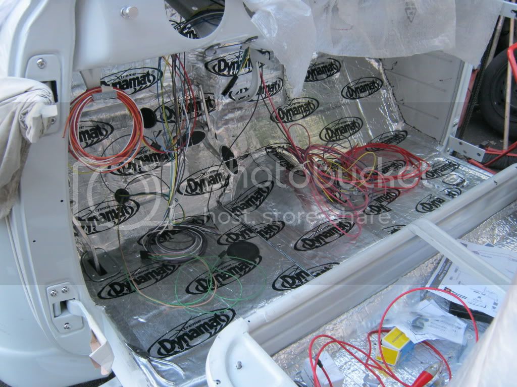

    I am currently preparing the firewall and the floor before
    installing the Dynamat
    Frank

    Are you going to Dynamat the entire cab? If so, how much did you get to cover entire cab? Good work so far.
  16. Frank64
    Frank64 Member
    Dec 26, 2011
    53
    Hi Raz76,

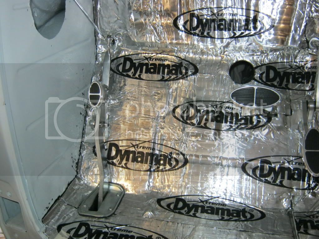

    I put the dynamat only on the inner firewall and floor.
    In the doors, below the top, under the seat bench and in the rear of the cab put another type of insulating.

    some little updates :).

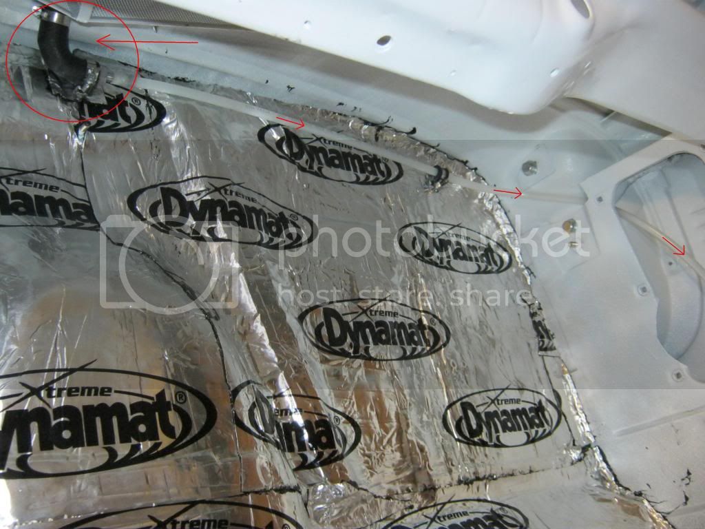

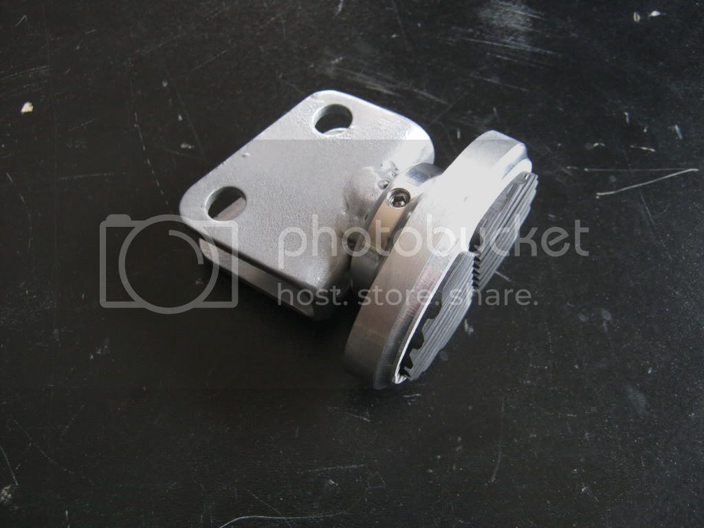

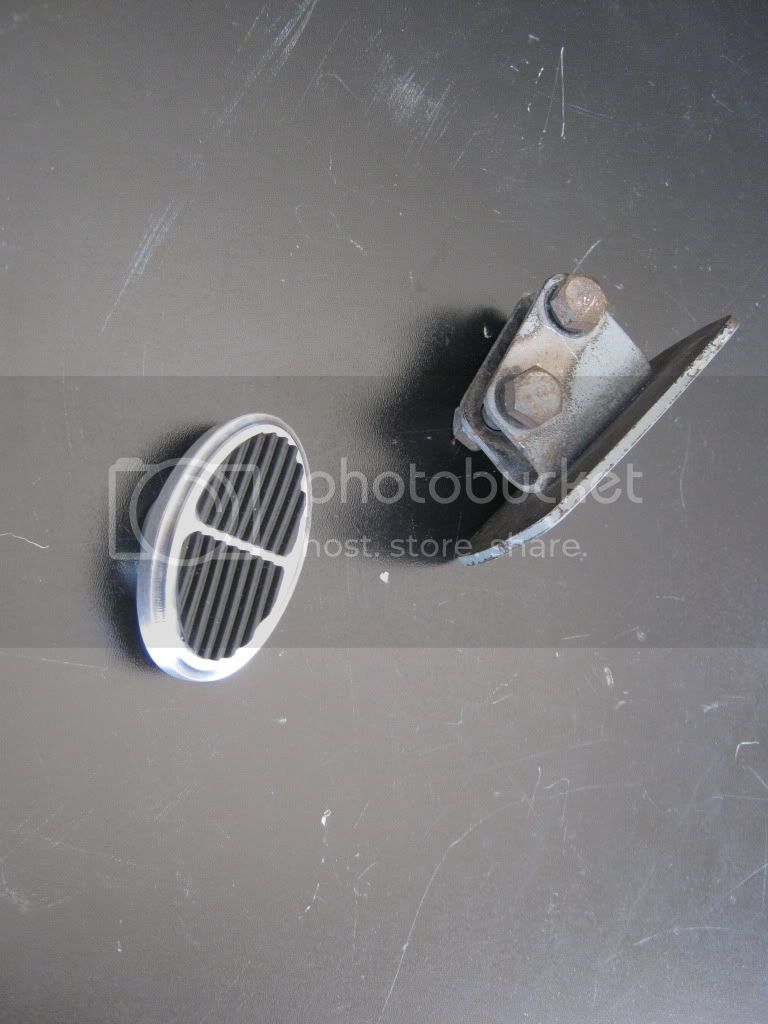

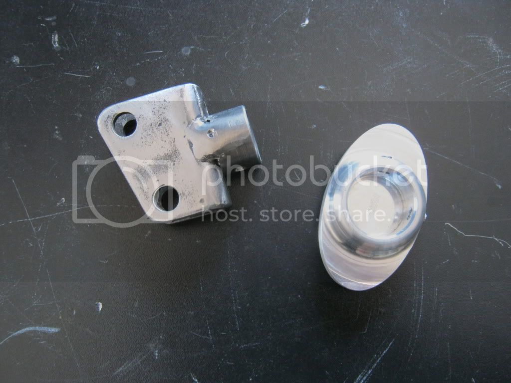

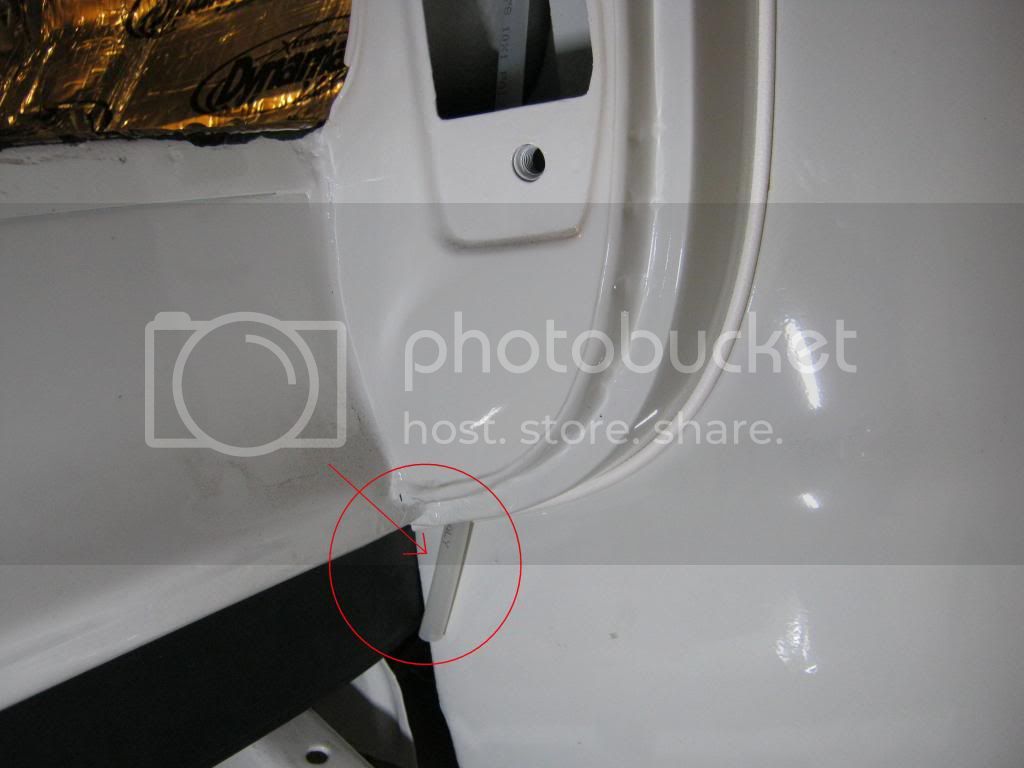

    I started to install the dynamat insulation and pedals, and for the parking brake pedal I bought a Dimmer switch Pad and I thought to do so
    I separated the two pieces
    Assy...

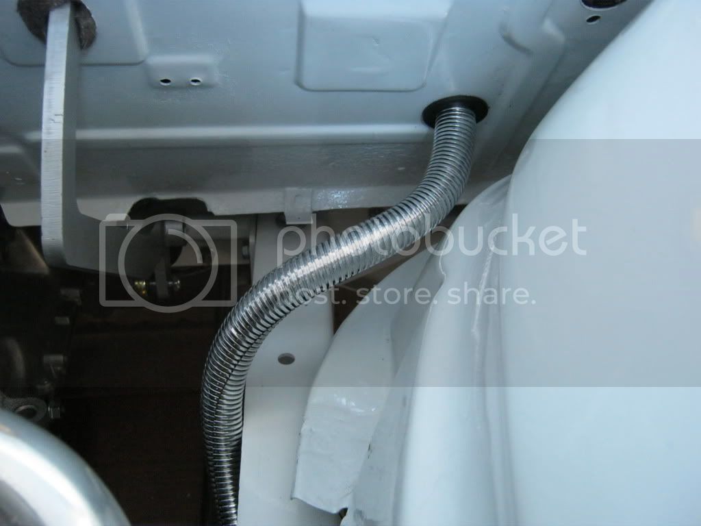

    I have also modified the top cowl vent drain hose to avoid that water falling on the engine.
    No need to make any holes I used the existing
    Now the drain hose comes out the bottom next to the passenger door
    I hope that these solutions are helpful for someone. If you have questions do not hesitate to ask

    More pics today

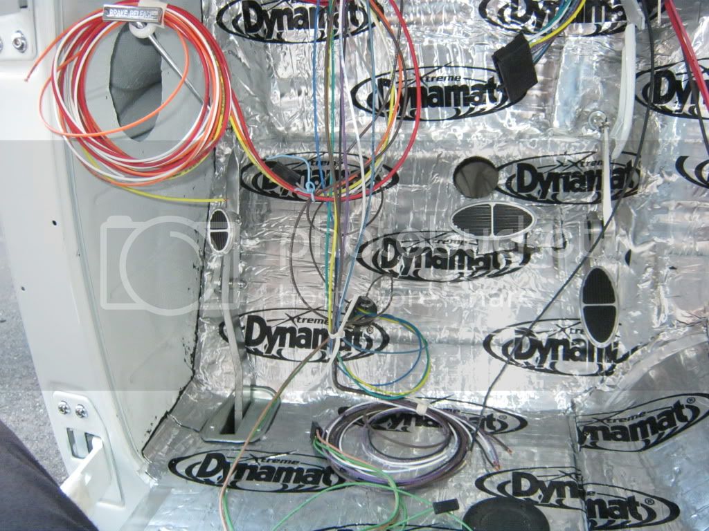

    Wiring harness assembly...will work very long
    I chose to route the wirse down and pass them within the frame rail

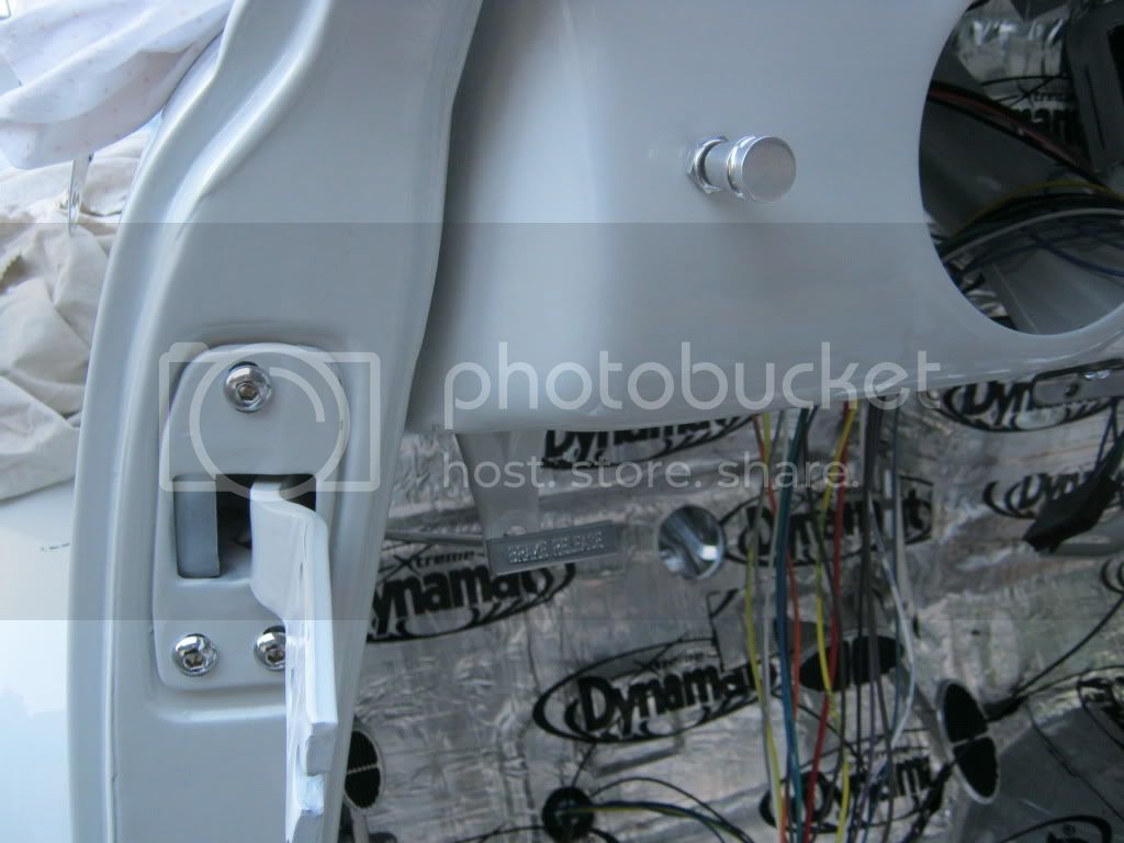

    Details. Today I tought to install the door but I decided to wait until I finish
    the wiring harness

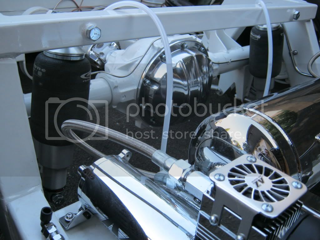

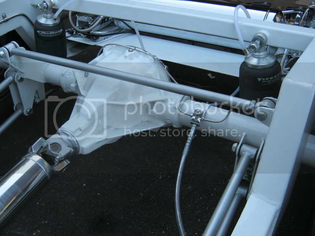

    I installed also the rear shockwave and rear brake line
    Latch panel with rechromed parts

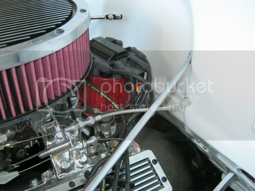

    Throttle and kickdown cable installed

    MAN! That wiring sure looks like FUN!!! ;)
    I like what you did with the parking brake!
