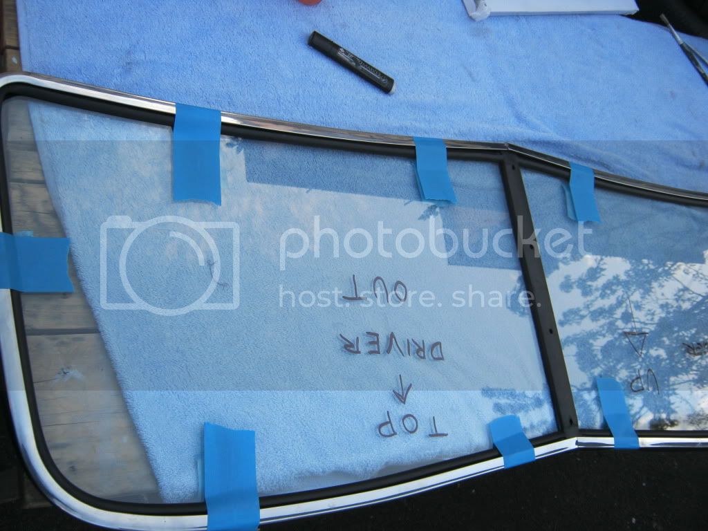

    Hello guys,
    I will also share with you the pain, not only the joys that
    a restoration can give :).

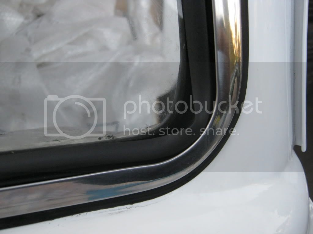

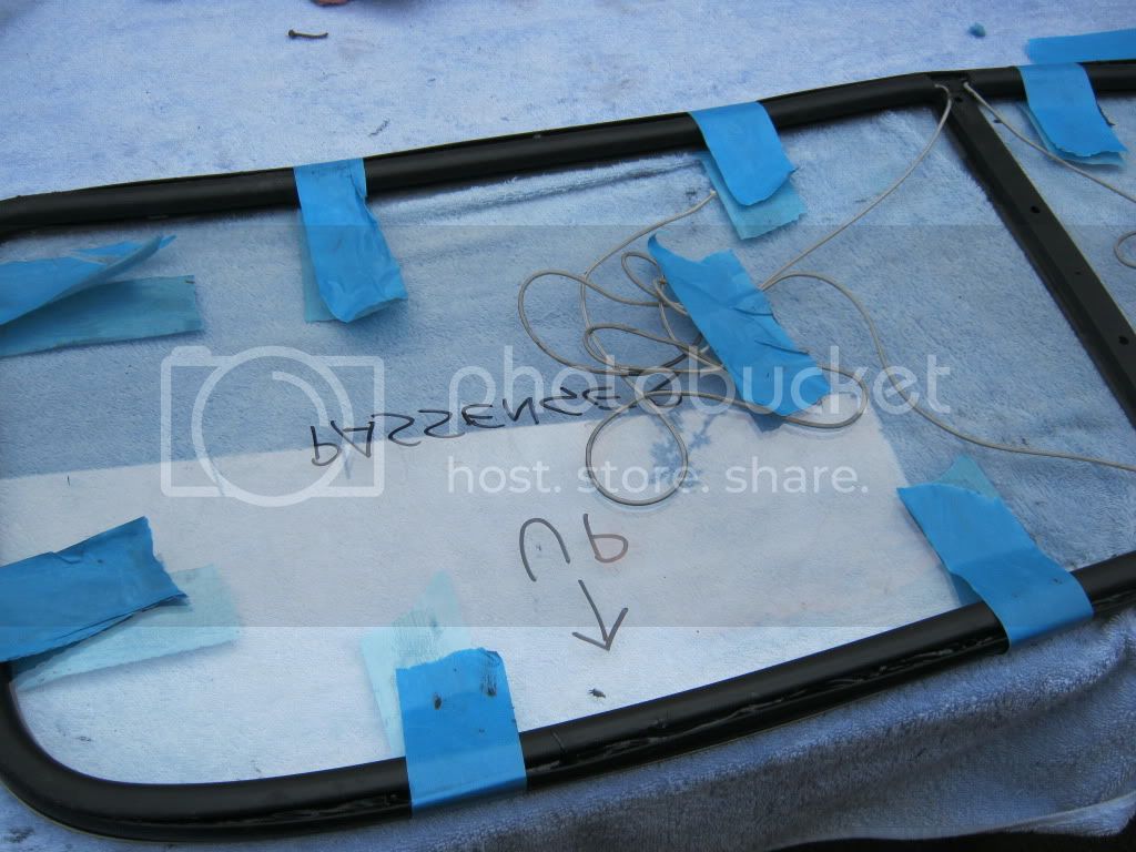

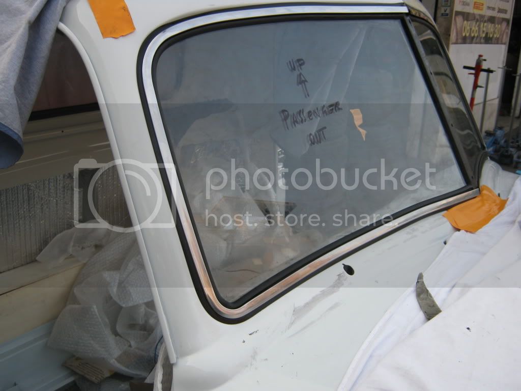

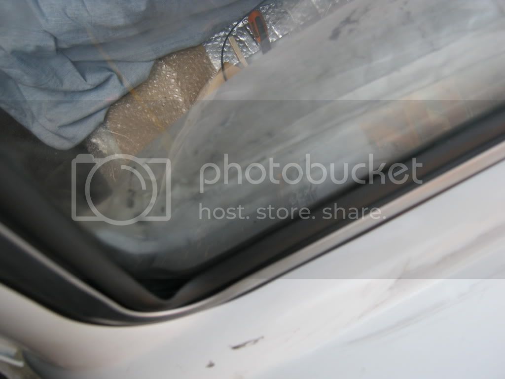

    I have a problem with the windshield, my truck is born without the Deluxe SS Trim but I decided to install this because I like the most.
    I followed all the instructions I found on the web but the rubber in the corners at the bottom does not fit well.
    I bought everything new, glass, rubber and SS Trim.
    What do you think? Why I have this problem? Perhaps the windows need a small cut in the middle? Please someone who has passed this difficult time can help me understand?
    Any help will be appreciated. Many thanks

    Rubber window seals !
    Frank good day to you.
    Using soap and a peace of rope is the way to go when installing the window rubber seals. Either you have moved the corner under install or the rubber seals are to long ! These molding are pressmade to fit , means they have a lenght and form that is a snug fit. Take the glass out and se how it fits in the corners , ask a friend to help you to keep it in position. It will show at once how the rubber reacts when pressing it in the corners. If this is the case return it to the vendor and buy rubber window seals at another vendor. Ol`chebby on this forum is the guy to ask , he has done a great job with his truck (ground up restoration) Ask him for more information and an adress for the correct rubber seals.

    You're using Chinese rubber there , it's crap and this is a common problem .
    Buy the correct one from Steele Rubber Co. , it's American made and top quality .

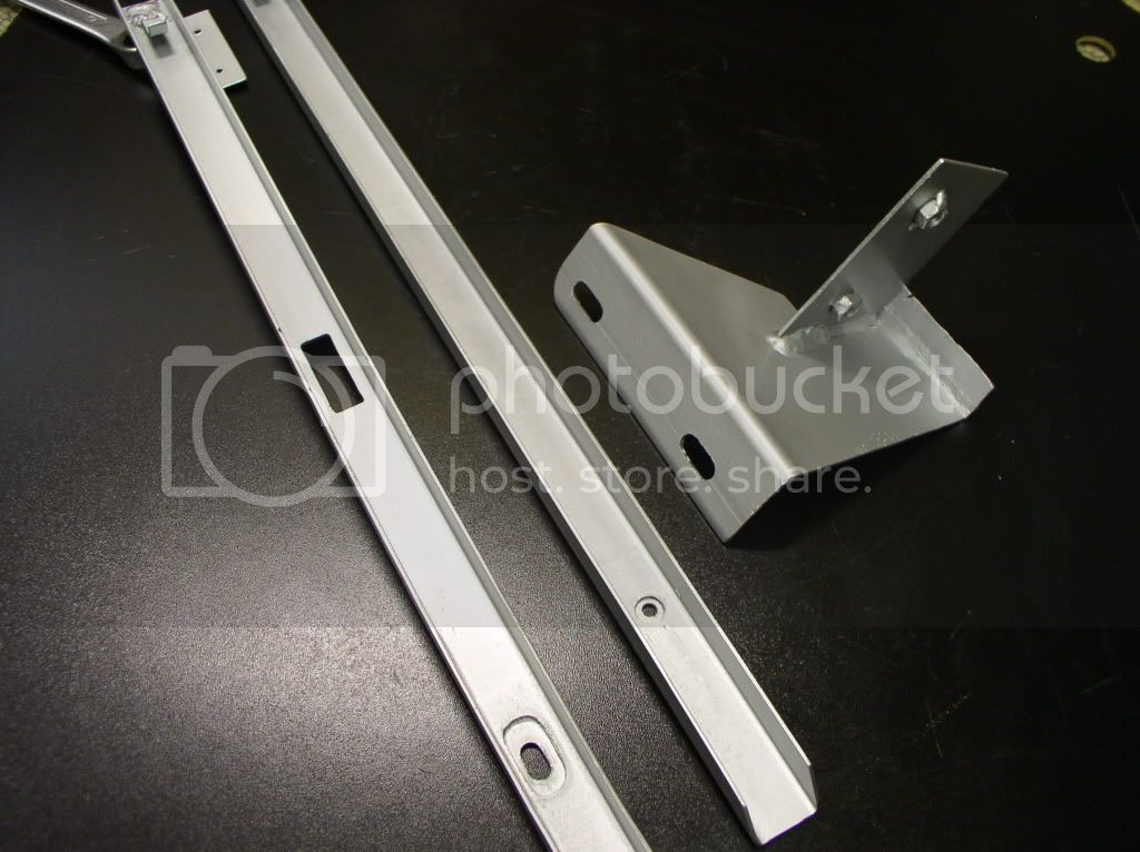

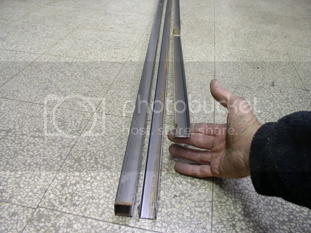

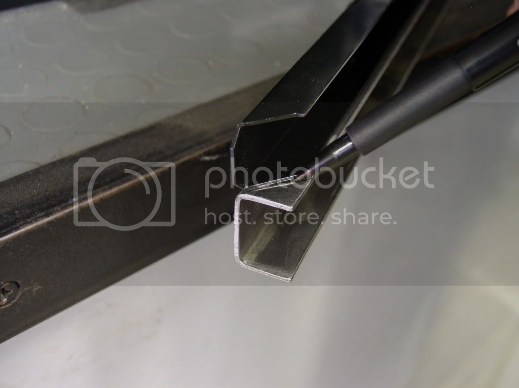

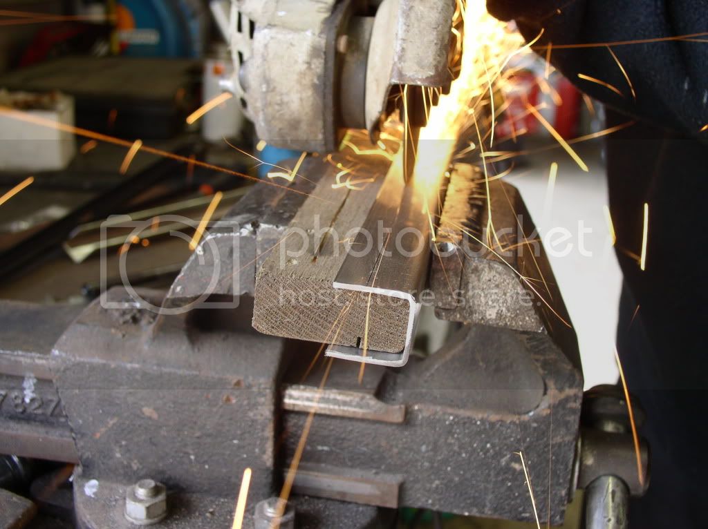

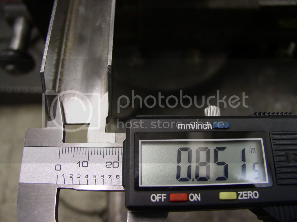

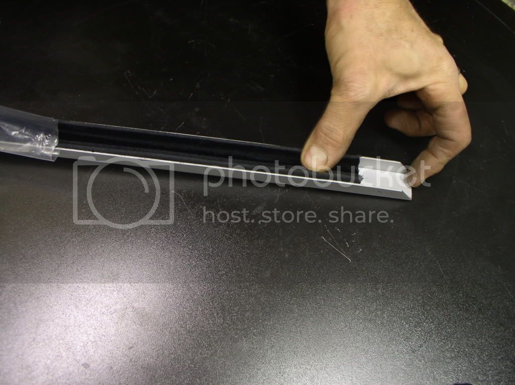

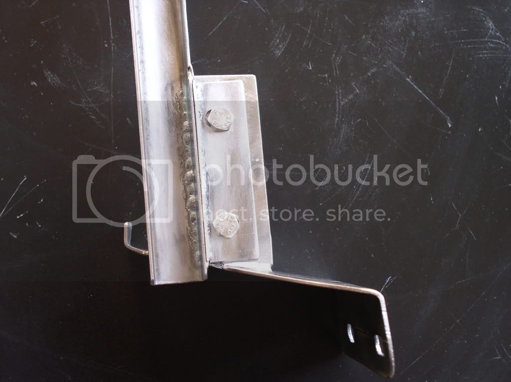

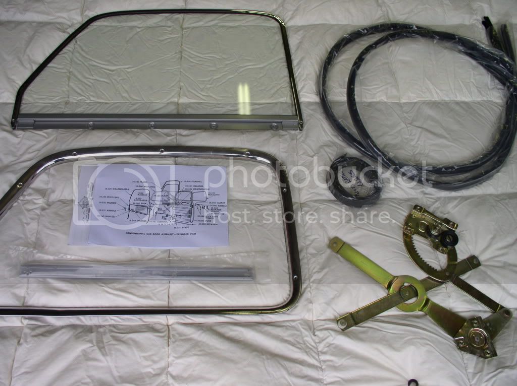

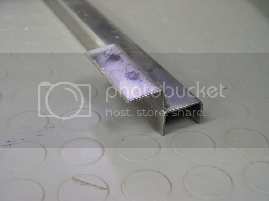

    If someone were interested, I will post some pictures of the glass conversion to a piece
    Parts from Classicparts:

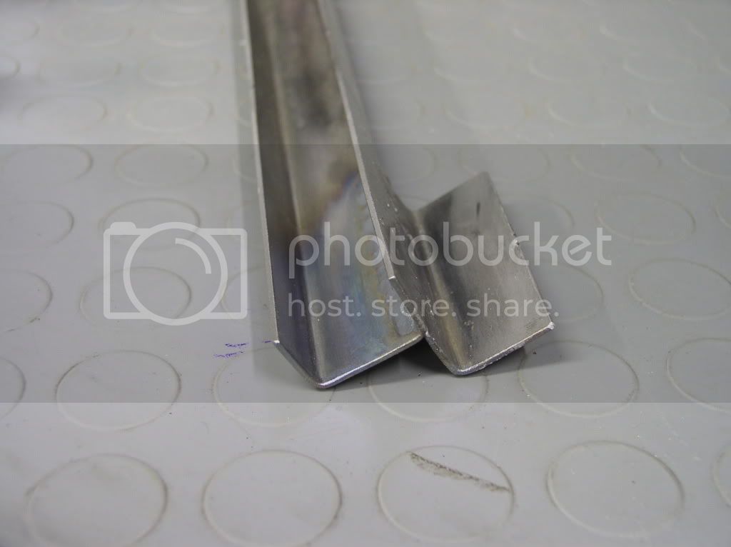

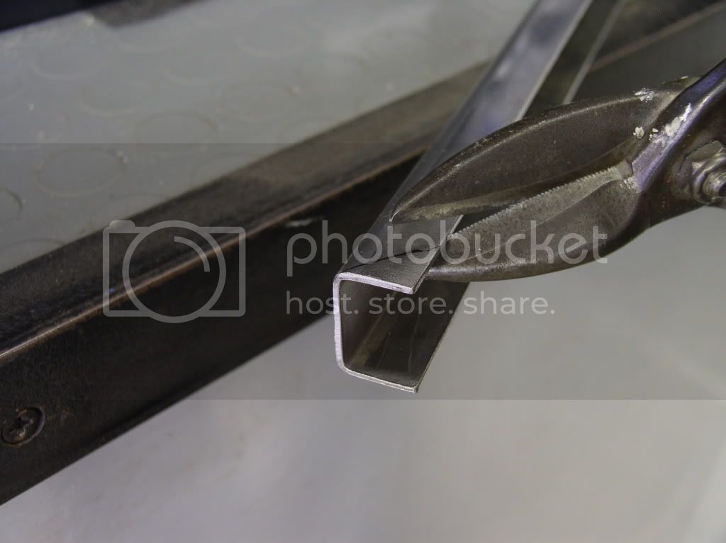

    I started buying a U-iron for the reproduction of the glass channels....

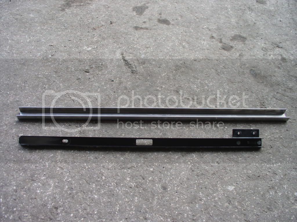

  12. Frank64
    Frank64 Member
    Dec 26, 2011
    53

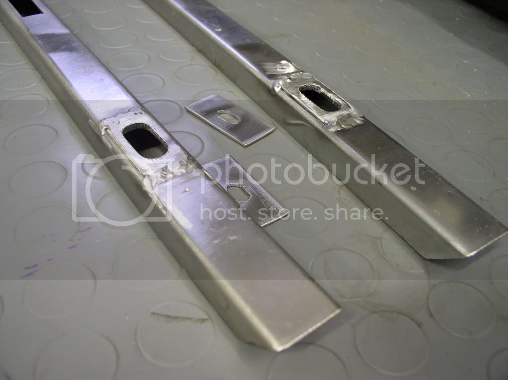

    Follows....

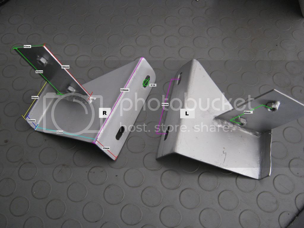

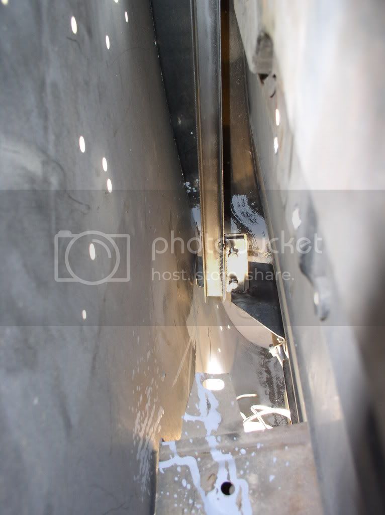

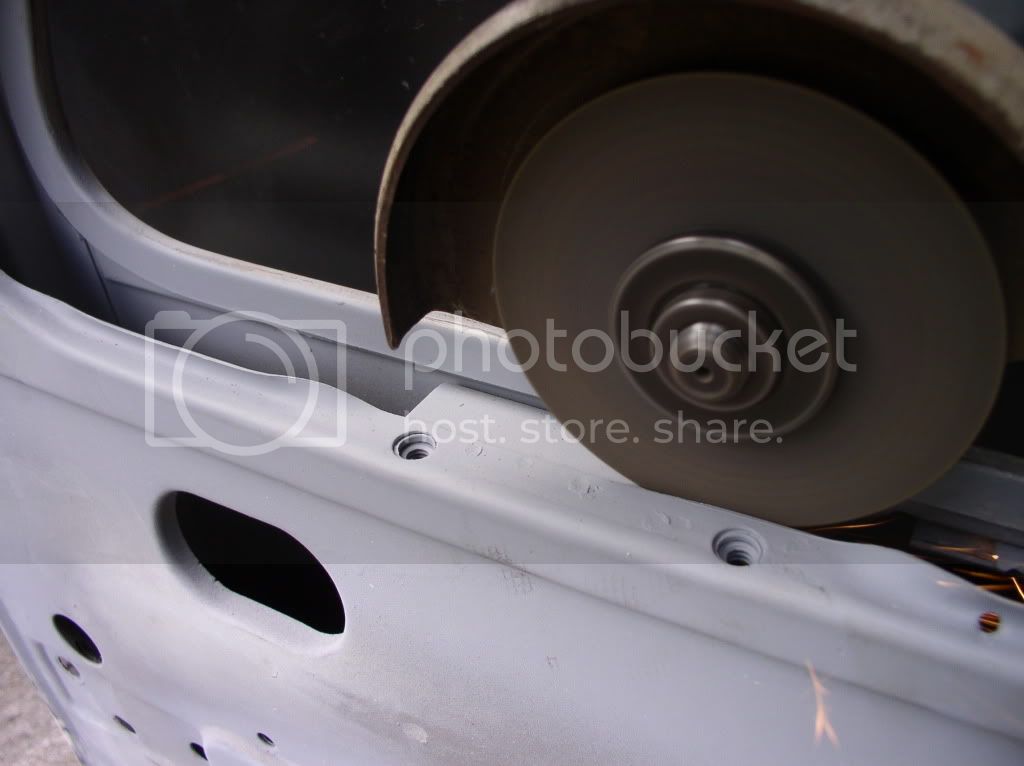

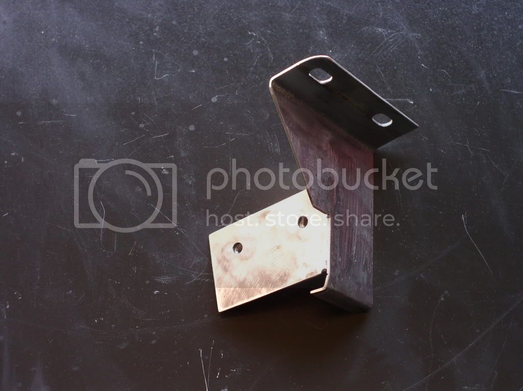

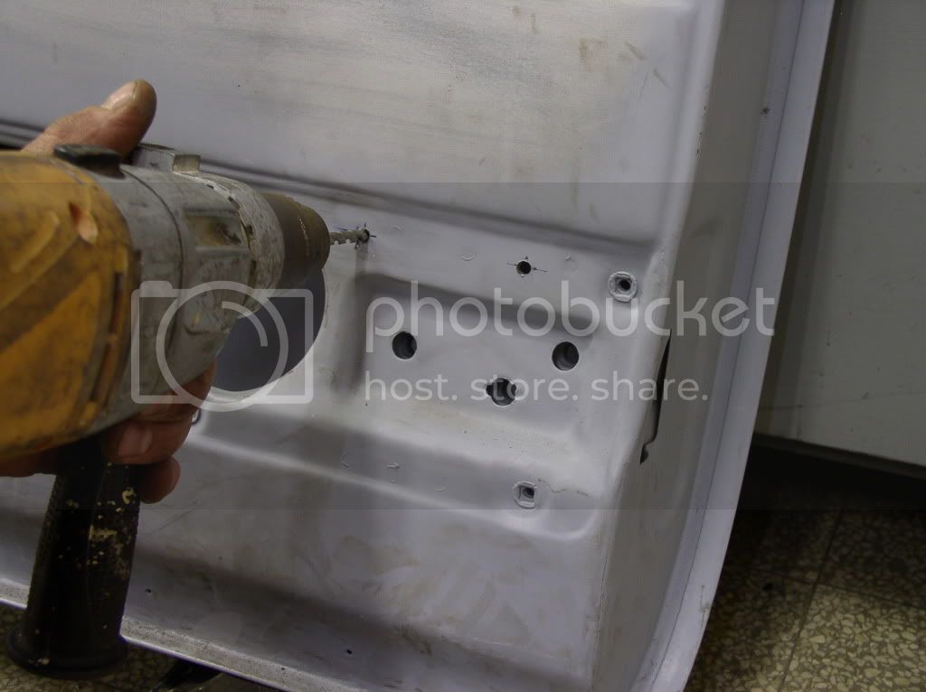

    Front Channels brackets.
    I wanted to hide the screws to make a clean and invisible work.
    For you would be much easier to replace the doors with the '50 truck
    but for me it was the best solution
    Inside door

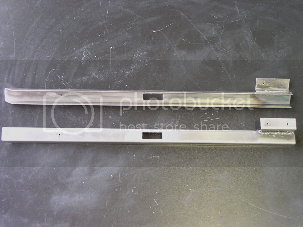

  16. Frank64
    Frank64 Member
    Dec 26, 2011
    53

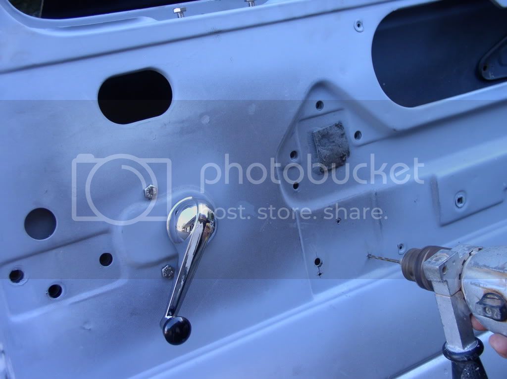

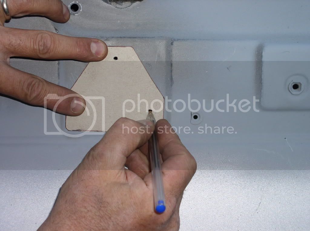

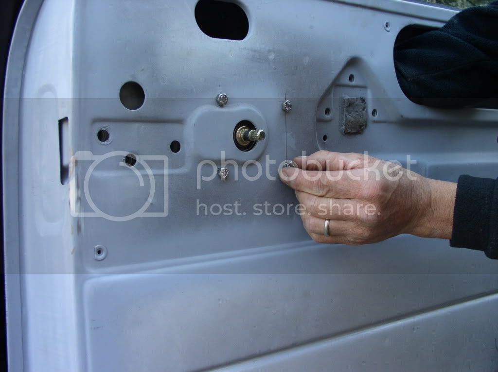

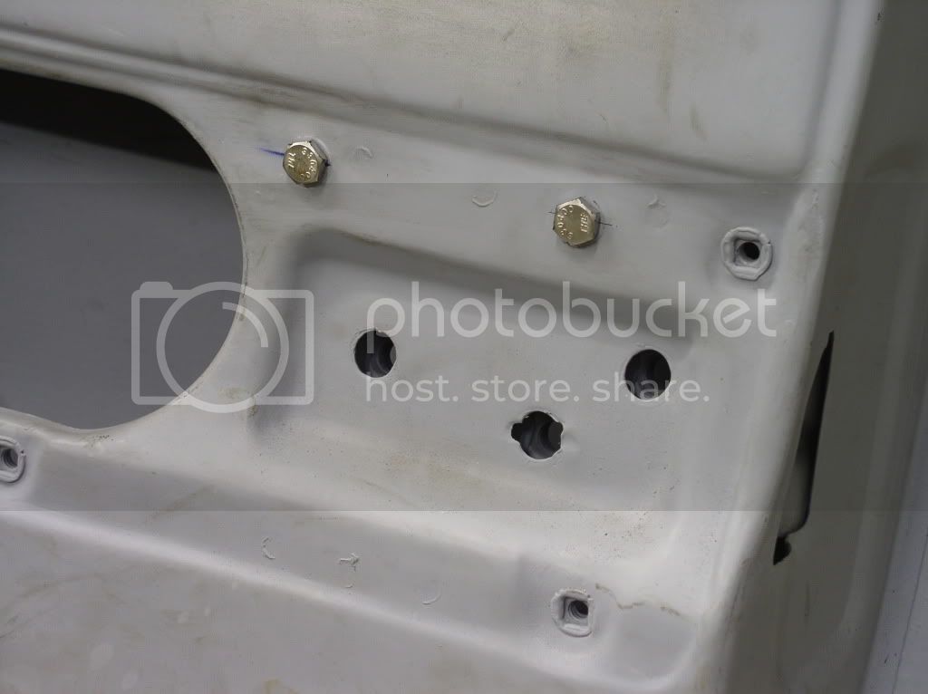

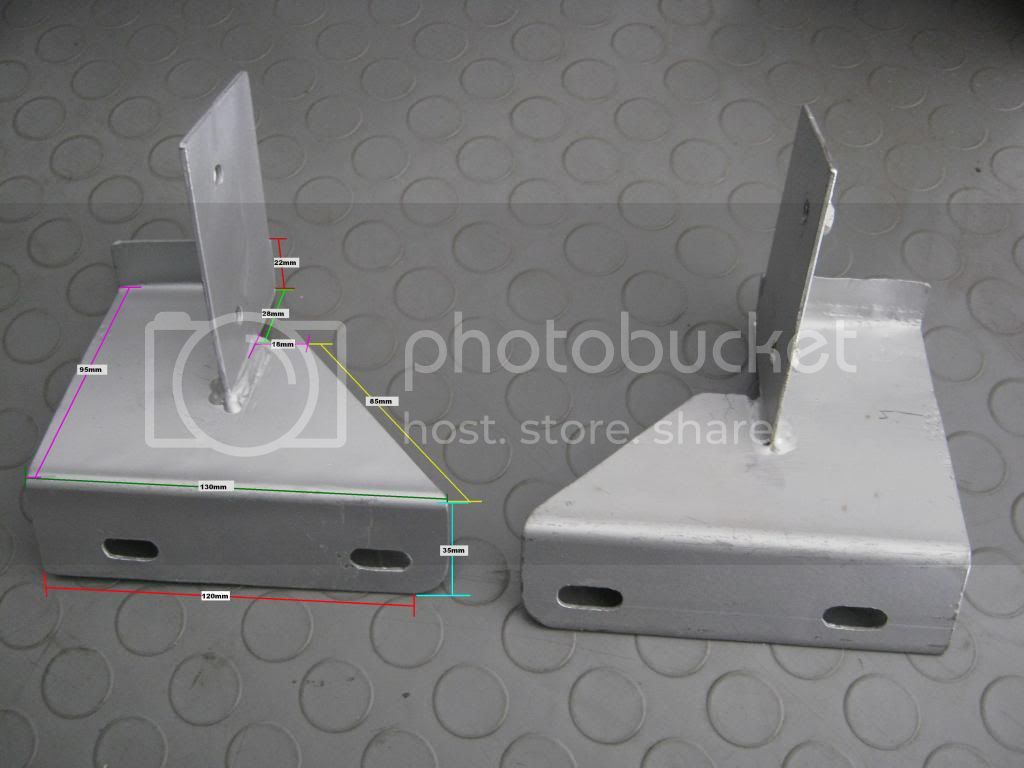

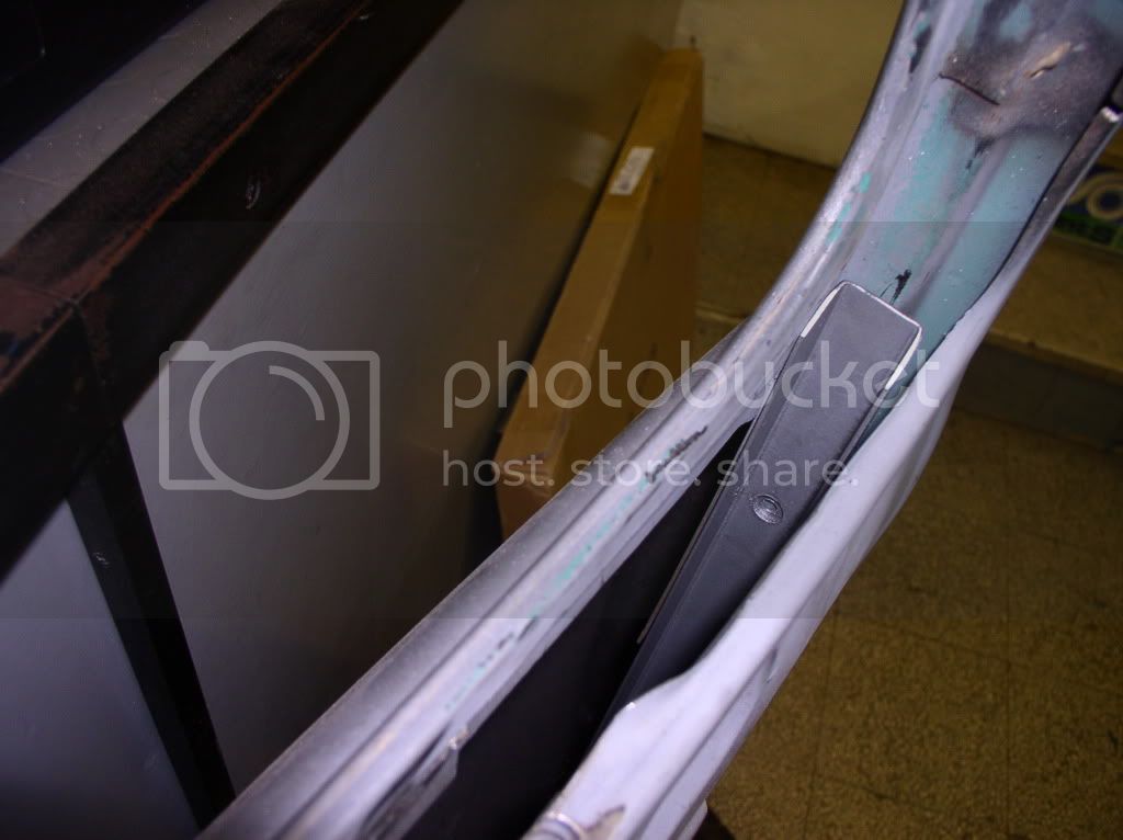

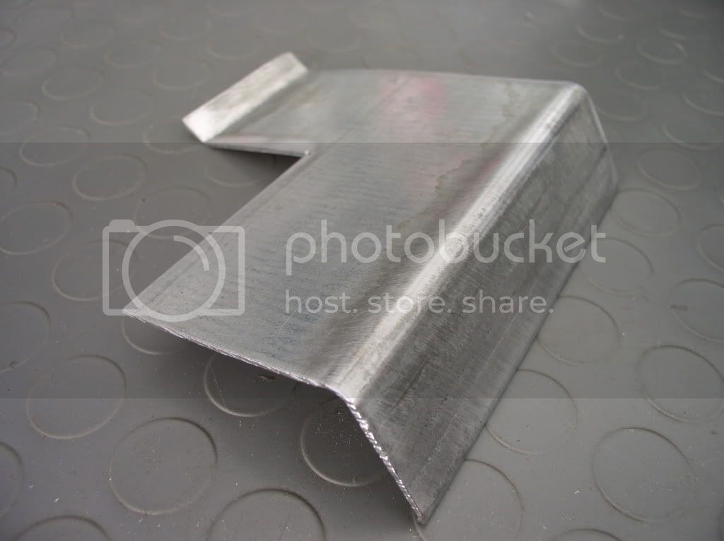

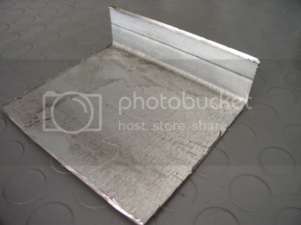

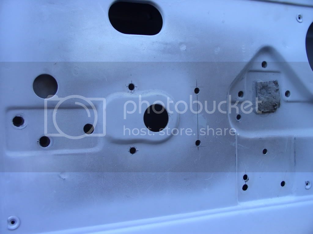

    More Pics about 1 piece glass door conversion
    Glass channels and brackets ready to install
    Window regulator positioning
    To drill door
    Brackets measure
    For any questions please ask, I am always at your disposal :)
