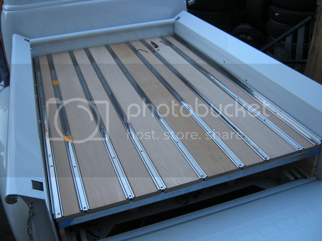

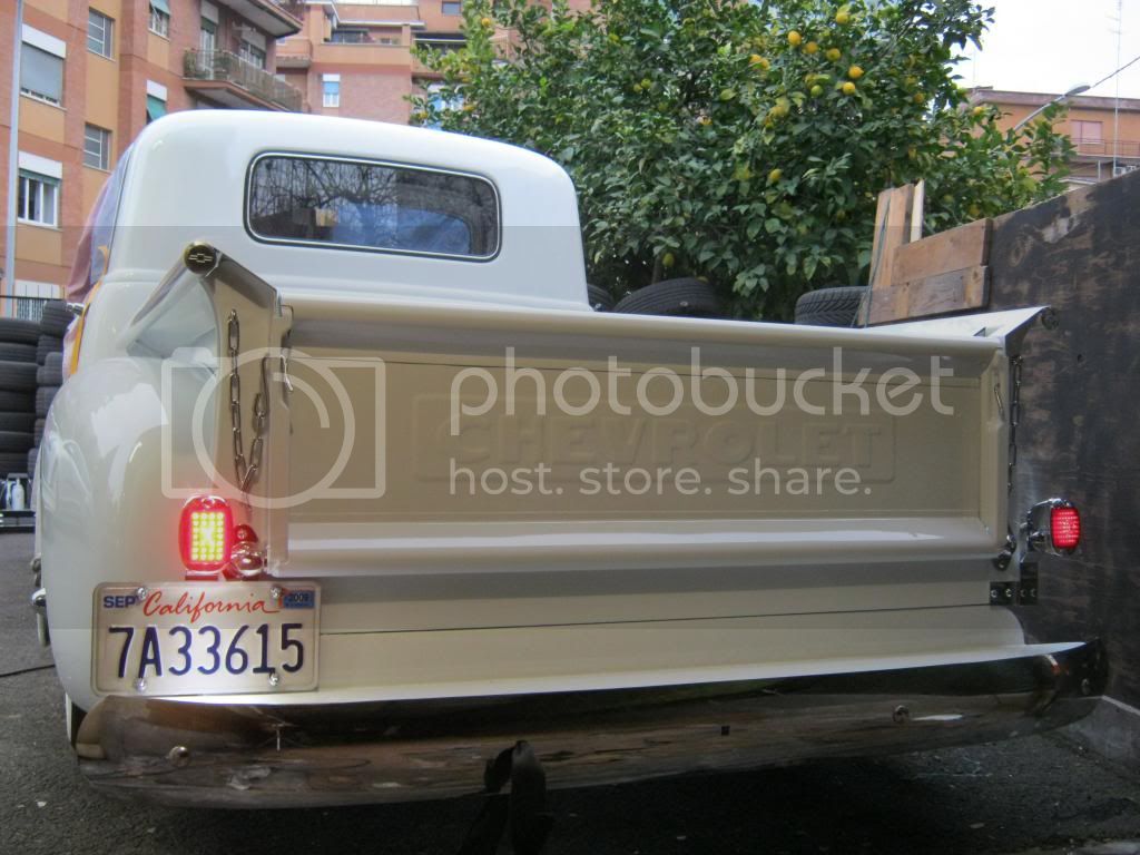

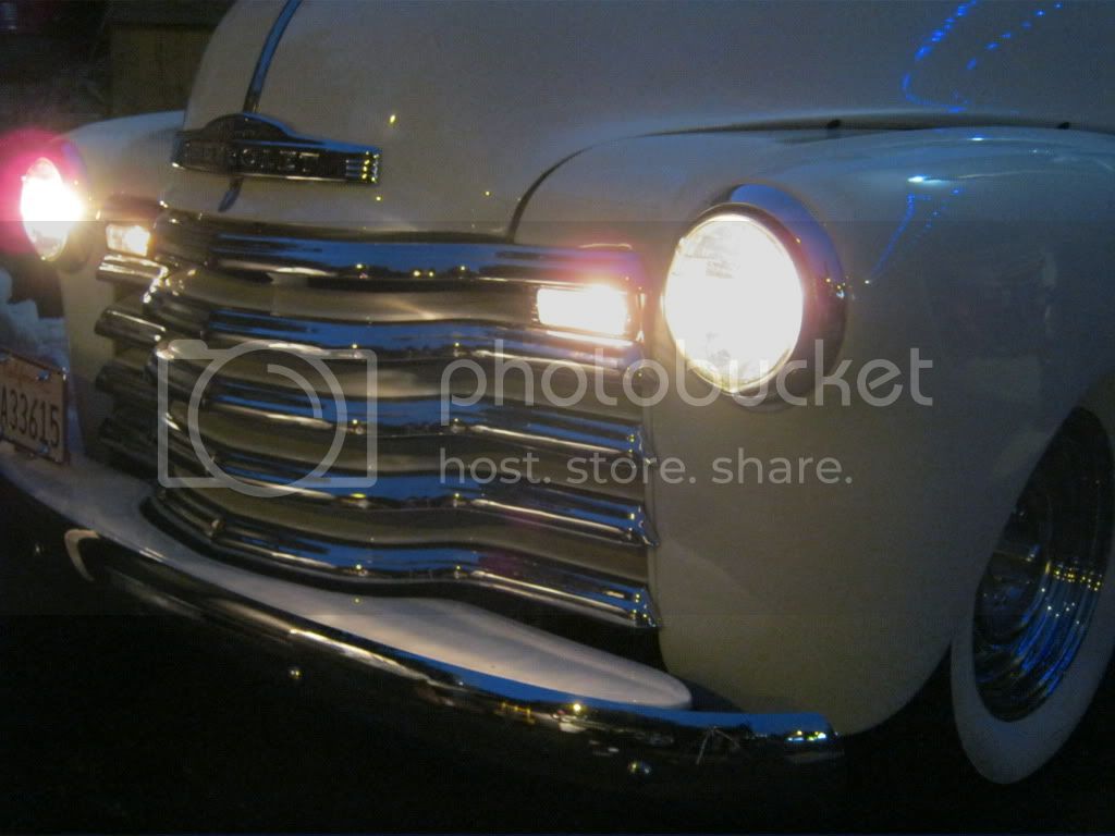

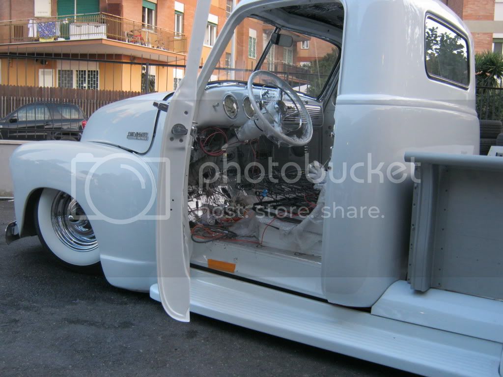

    electrical connection all working perfectly, new Bedsides (Usa Made) painted and assembled, the upholsterer is preparing the upholstery,
    and lots of other work done
    This is my American dream and finally arrived....:)

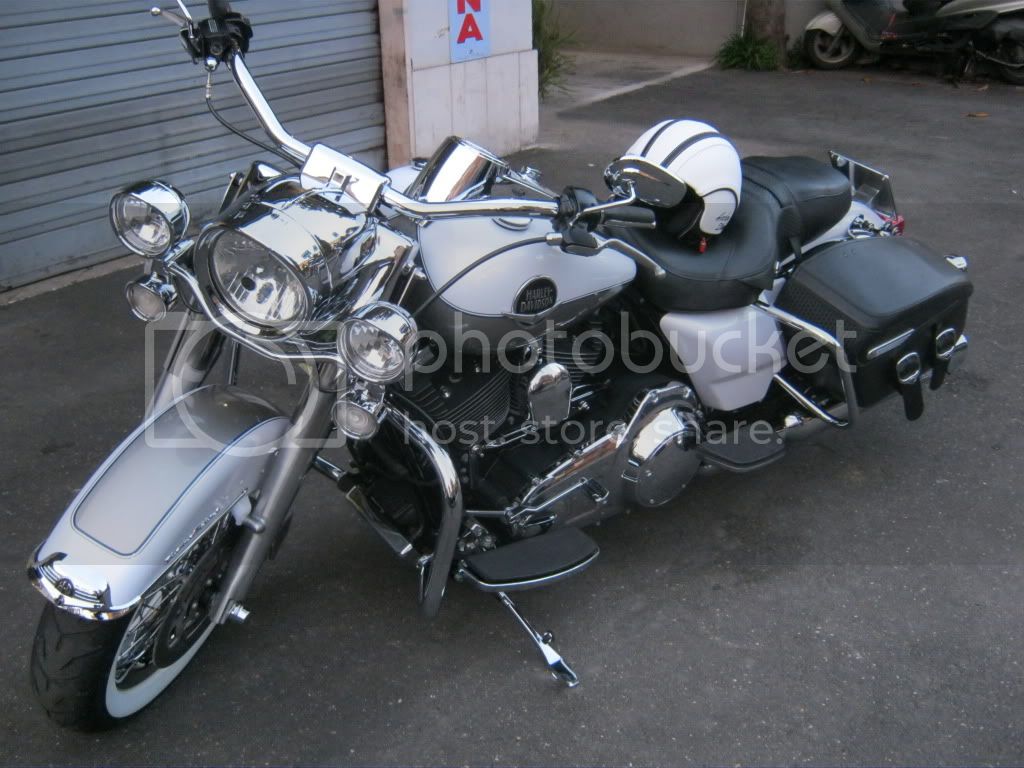

    I love the matching Harley~ Looks like someone has claimed it already, however...

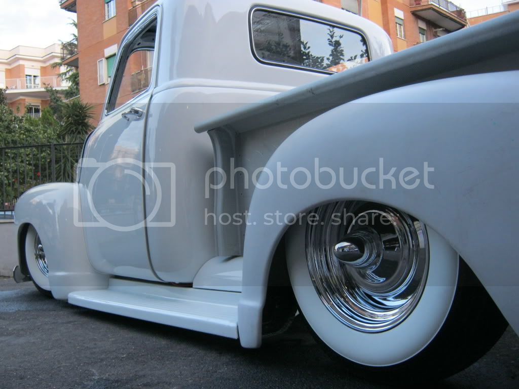

    Wheels
    Frank - where did you get those center caps for your smoothies? I bought some smoothies and the cap is not deep enough for my front wheels.

    Its good to see your mc intrested aswell that is a beauty , i remember the old models Moto Guizzi very well as-spesially the classic Falcone with its big turning wheel on the outside of the engine! Is Moto Guizzi still in production ?

    Hi 58,
    I bought them here, but watch that can be adapted to your wheel rims
    http://www.summitracing.com/parts/wvi-5029-1
    If you need further information please do not hesitate to contact me :)
    Frank

    Yes, the Guzzi is still in production but the name of the new model,
    the manufacturer has inspired the U.S., it is called California :).....
    but.... I prefer the legendary Harley Davidson :):):)
