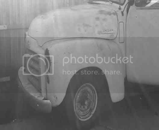

I know for sure that I want to be lowered at least and I want the white walls on my tires with the factory hub caps. I want the chrome rear bumper like I see on chevys and want the interior to look like it did. Im guessing that I will need a new steering column to have turn signals, right? What wheels do you guys recommend, what are the specs and from where? I want my truck to look like this,.

Then I would say...
Look at what Russ did. What you have a photo of, he already did. You have the much better GMC, but rumor has it, he has one in his shop. It'll probably be tricked out like the photo you posted.
Great goal, No?~
Great goal, No?~

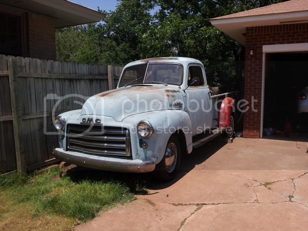

I cleaned up the grill a little today, the hub caps and installed the headlights. I guess Im gonna get a wire harness kit and do that soon and I already ordered the Master Cylinder to get the brakes working. I guess my next step would be to replace everything that is rusted out, like the driver side cab corner, the floor, front bed panel, do the body work, primer it, clean up the frame. Not in that order but that's what I want to do for now.

I was there once
I came up with the same plan when my truck was dropped off. It had no brakes, so I figured I'd get those back to good so I could drive it! I just rebuilt the master, found brakes shoes for it, (not easy, since it was a 3/4 ton. You can find half ton stuff all day, but...) then fired it up and took it for a drive.
Man, that thing wandered all OVER the road. Bounced like I was riding a horse! (I had split rims like you have. They may have had something to do with the quality of ride.)
Anyway, I found out PDQ that this just wasn't going to work. When I took the old brake line off that ran around the front end of the truck, I was standing there holding it when I saw this little stream shooting out of the line. :eek: The line had all but rusted through. I am ever so glad God was watching out for me and the others on the street.
I guess what I'm saying is new lines may not be a bad idea either.
Looks like you have a great place for it to sit for a while.
