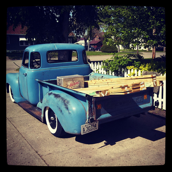

Henry is still alive and living a life of leisure. Daily cruises to haul the kids around, or a milk run.
Hangs out on the curb sometimes and attracts all sorts of attention!!
