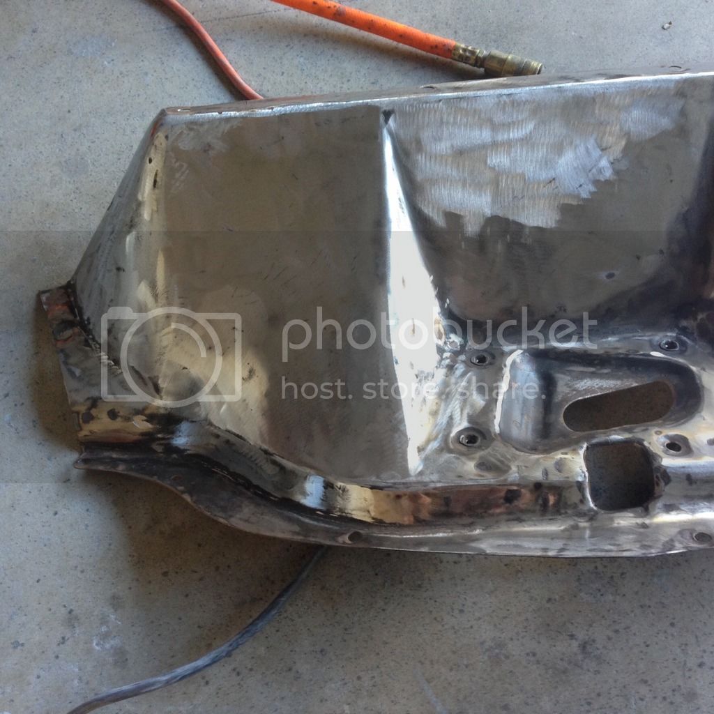

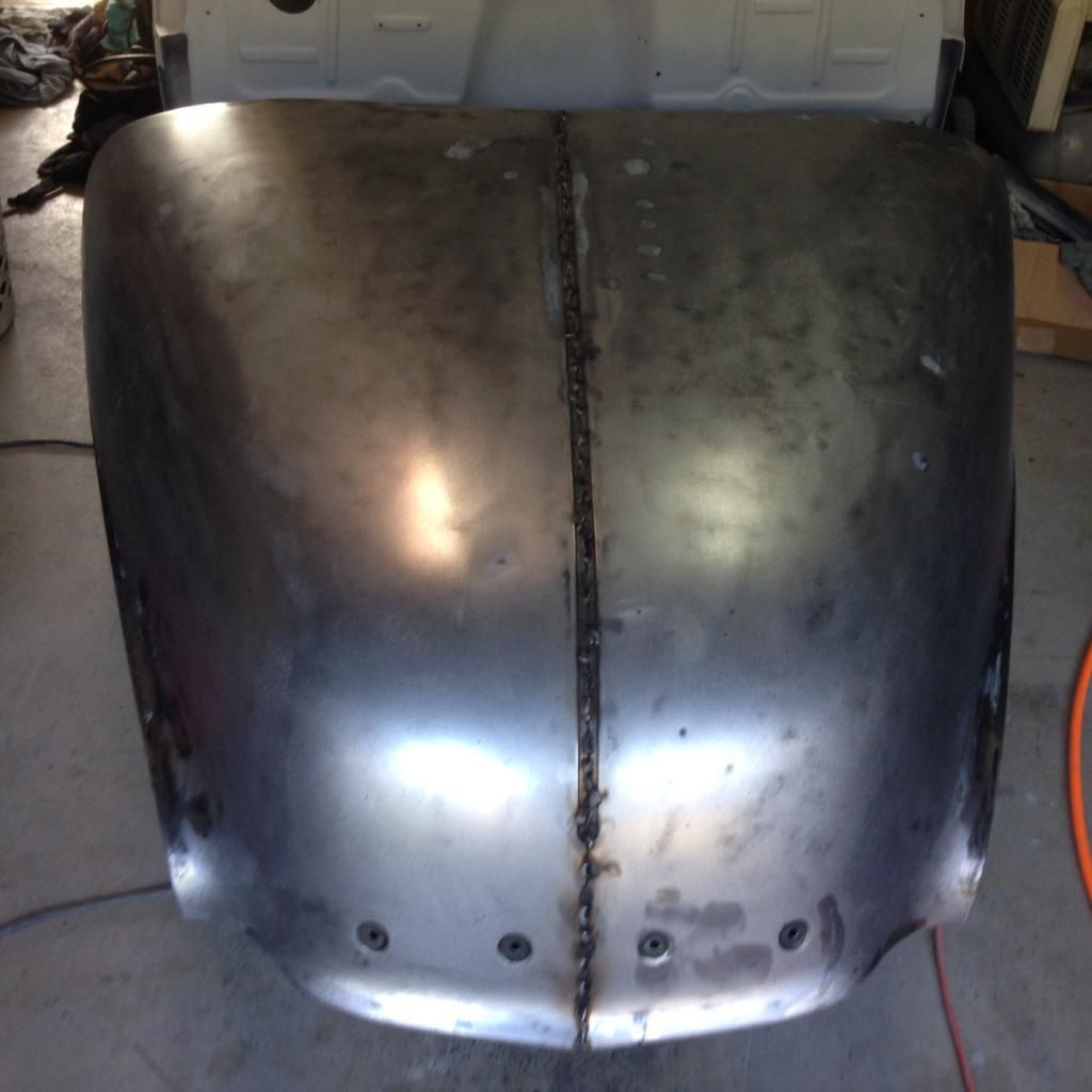

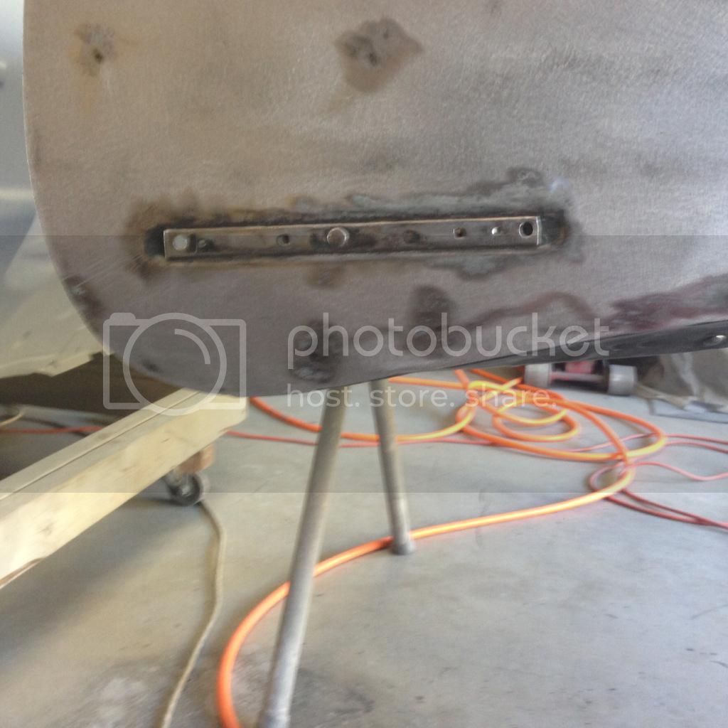

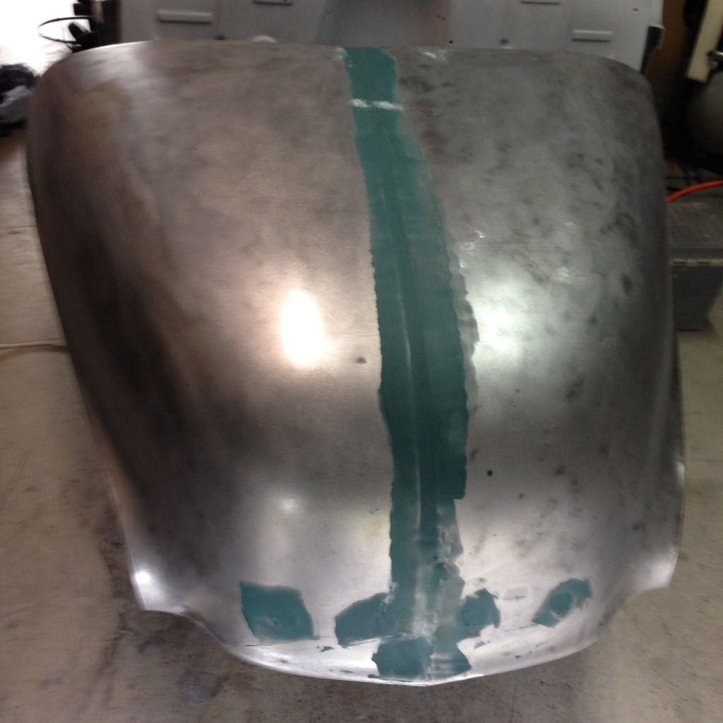

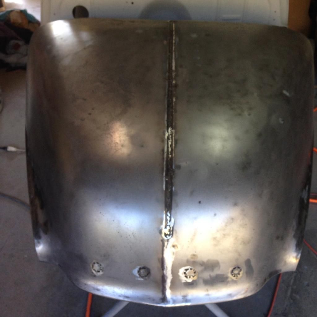

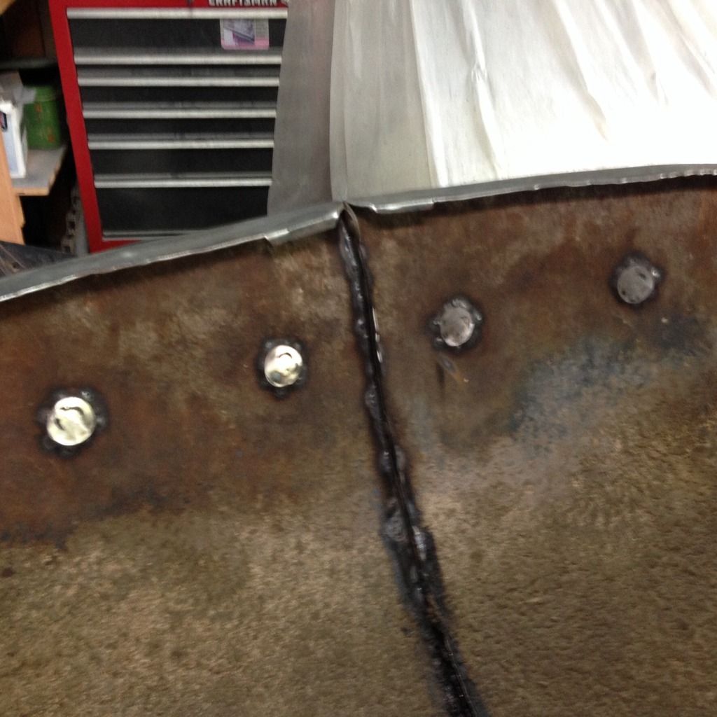

Thanks for the encouragement on my build, I decided to weld my hood myself and I took my time welding up the center. So far I have 10 hrs and plan to spend 2 or 3 more on the center before grinding it. The hood looks great and it did not warp. I only put 4 or 5 welds a 1' a part every 10 to 15 minutes and that did the trick.
It took 12 hrs,but my hood is welded and straight. I sandblasted my doors and primed the door jams and back side. Now to start on the body work on both

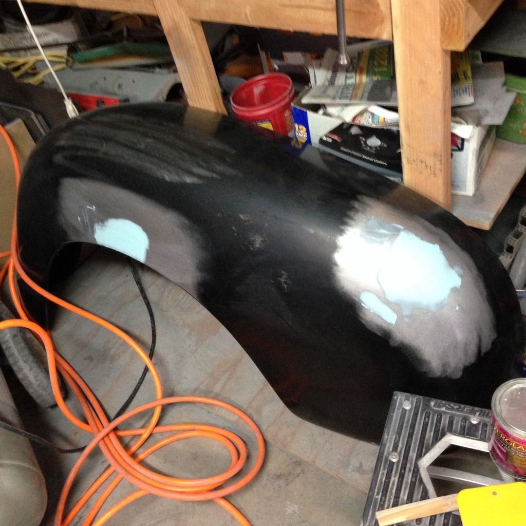

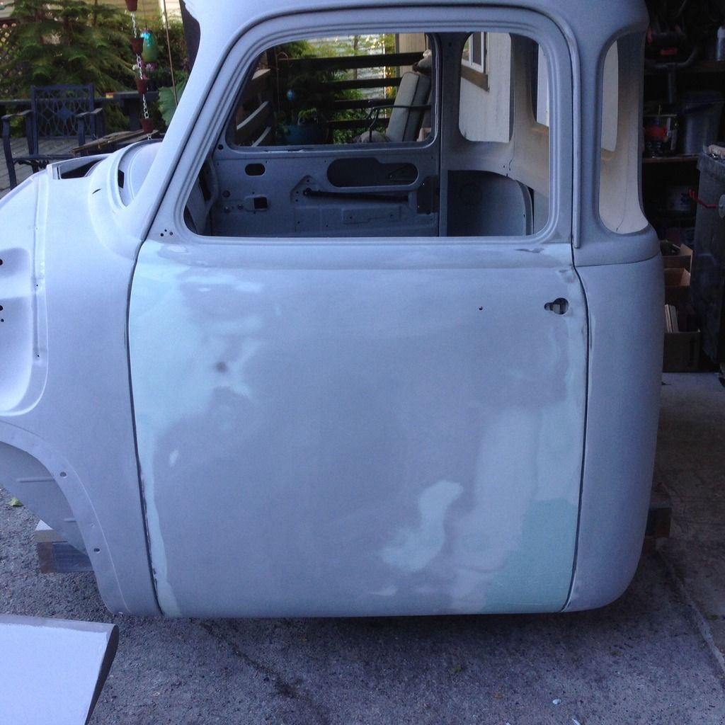

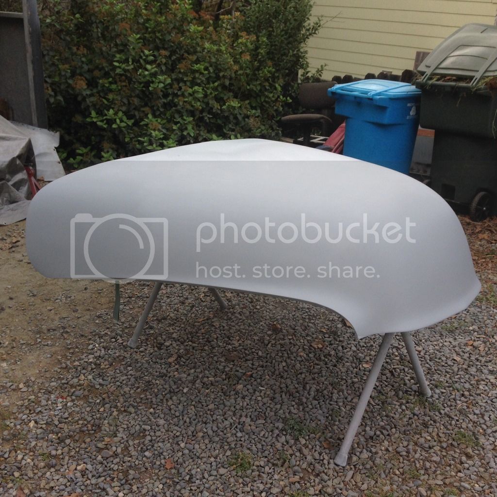

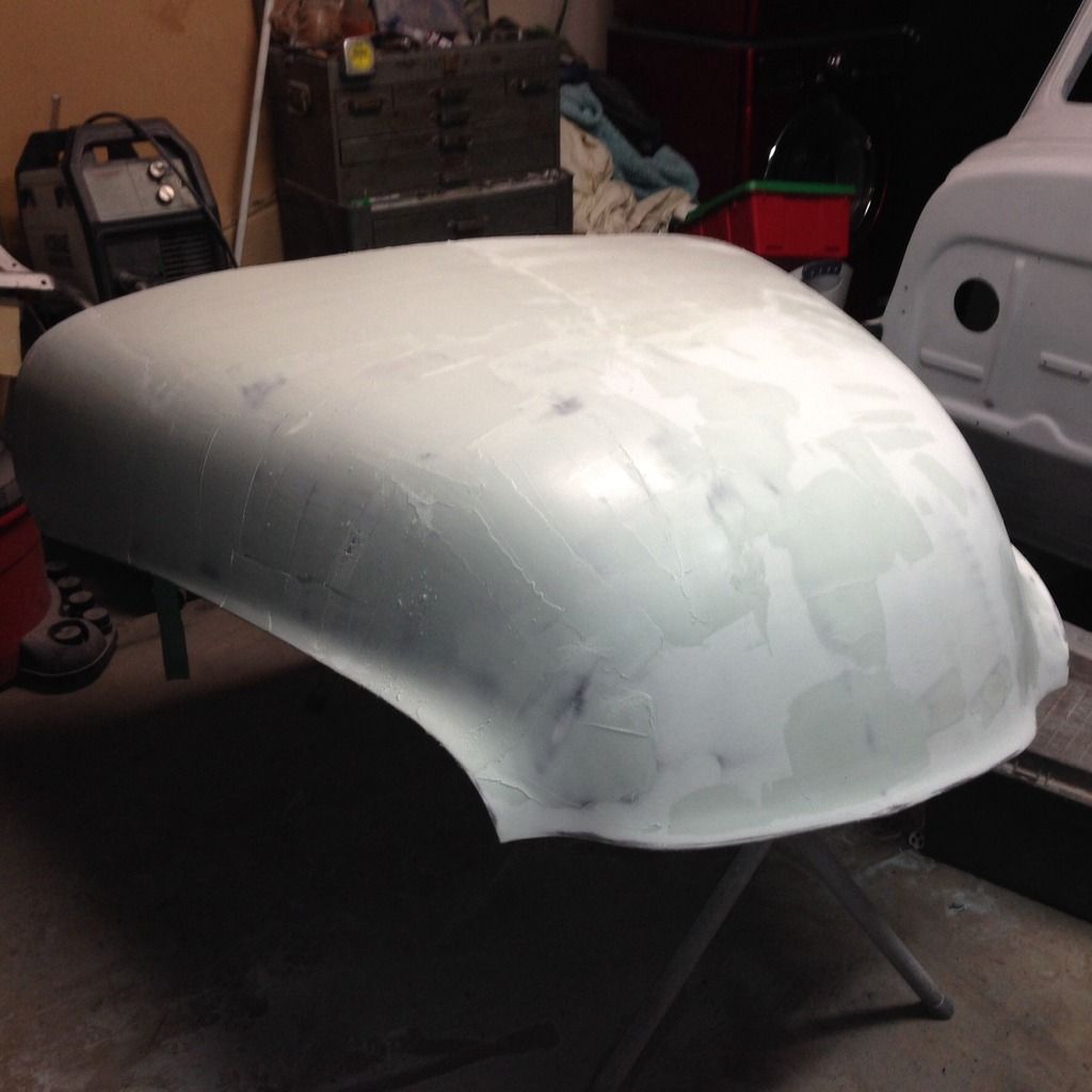

Skimmed the entire hood this weekend sanded it down and sprayed the first coat of finish sand yesterday. Now to blocked it.:D

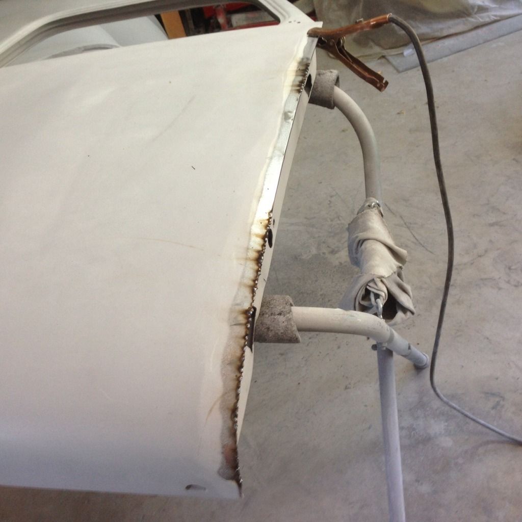

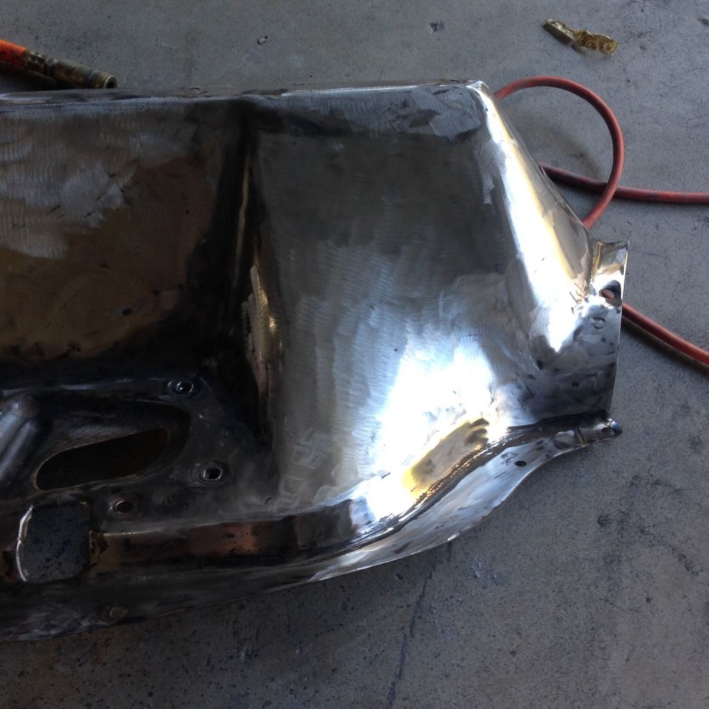

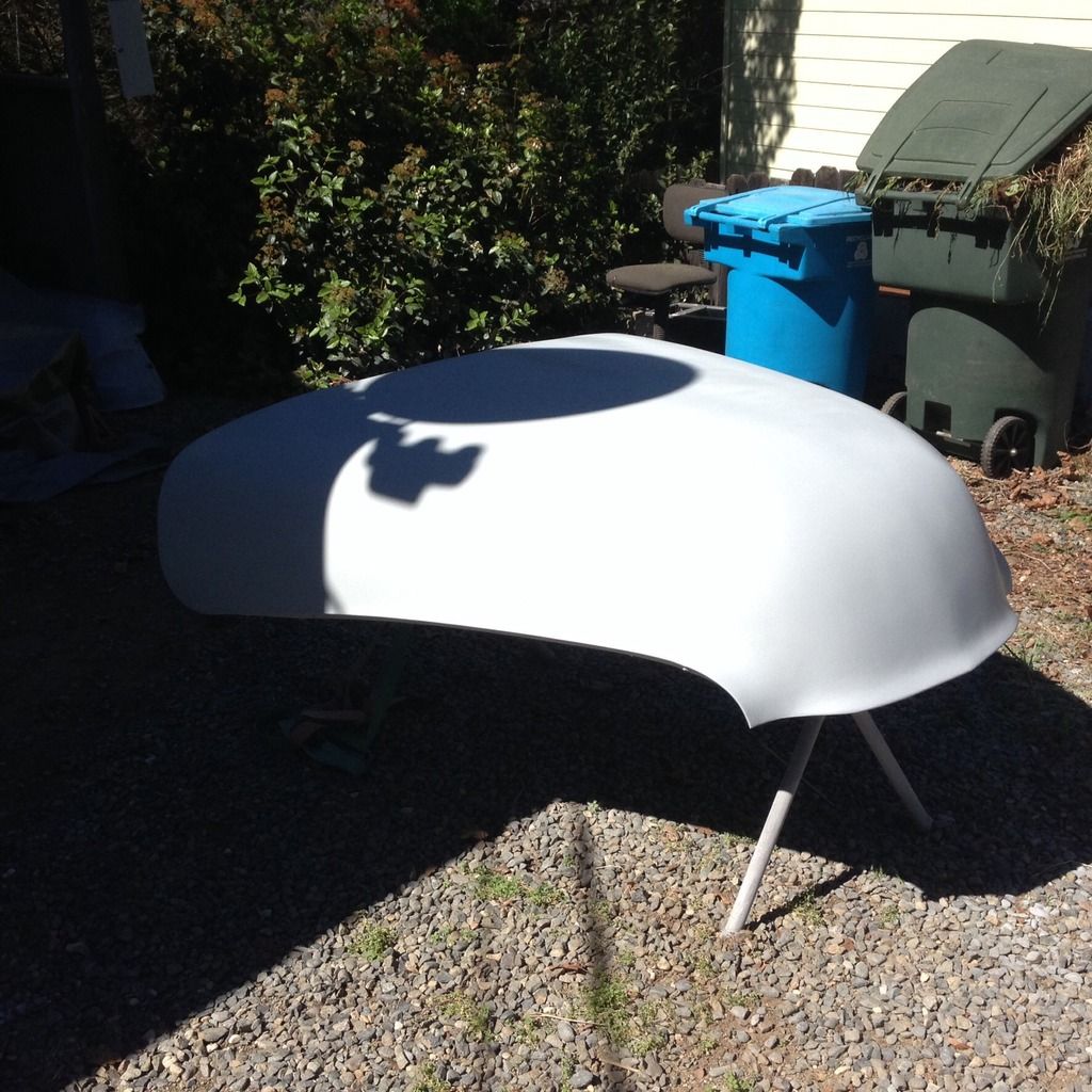

I finished my hood and also the hood latch, last night I skimmed both doors will be sanding on them today. After going over the hood 4 different times it's finally straight

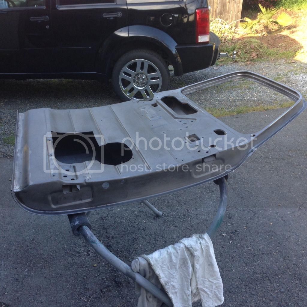

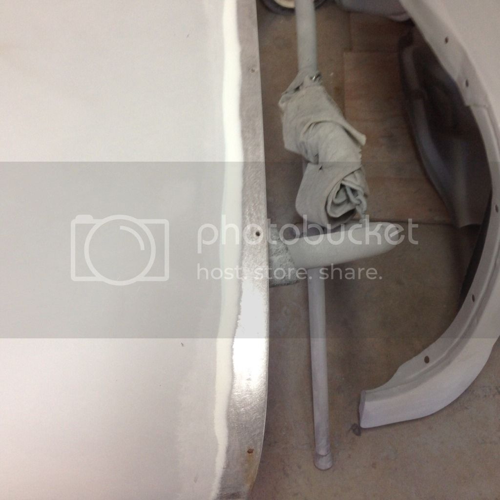

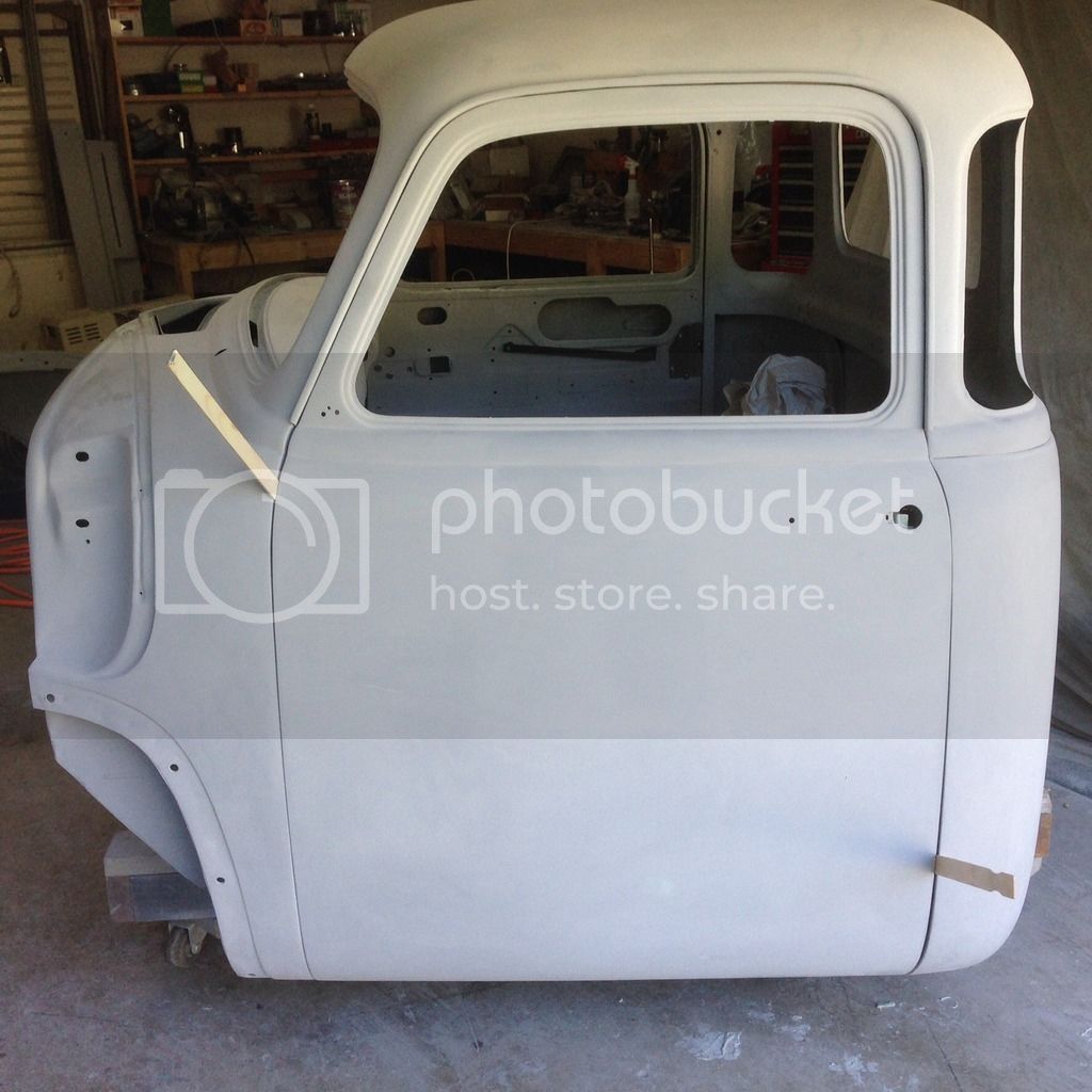

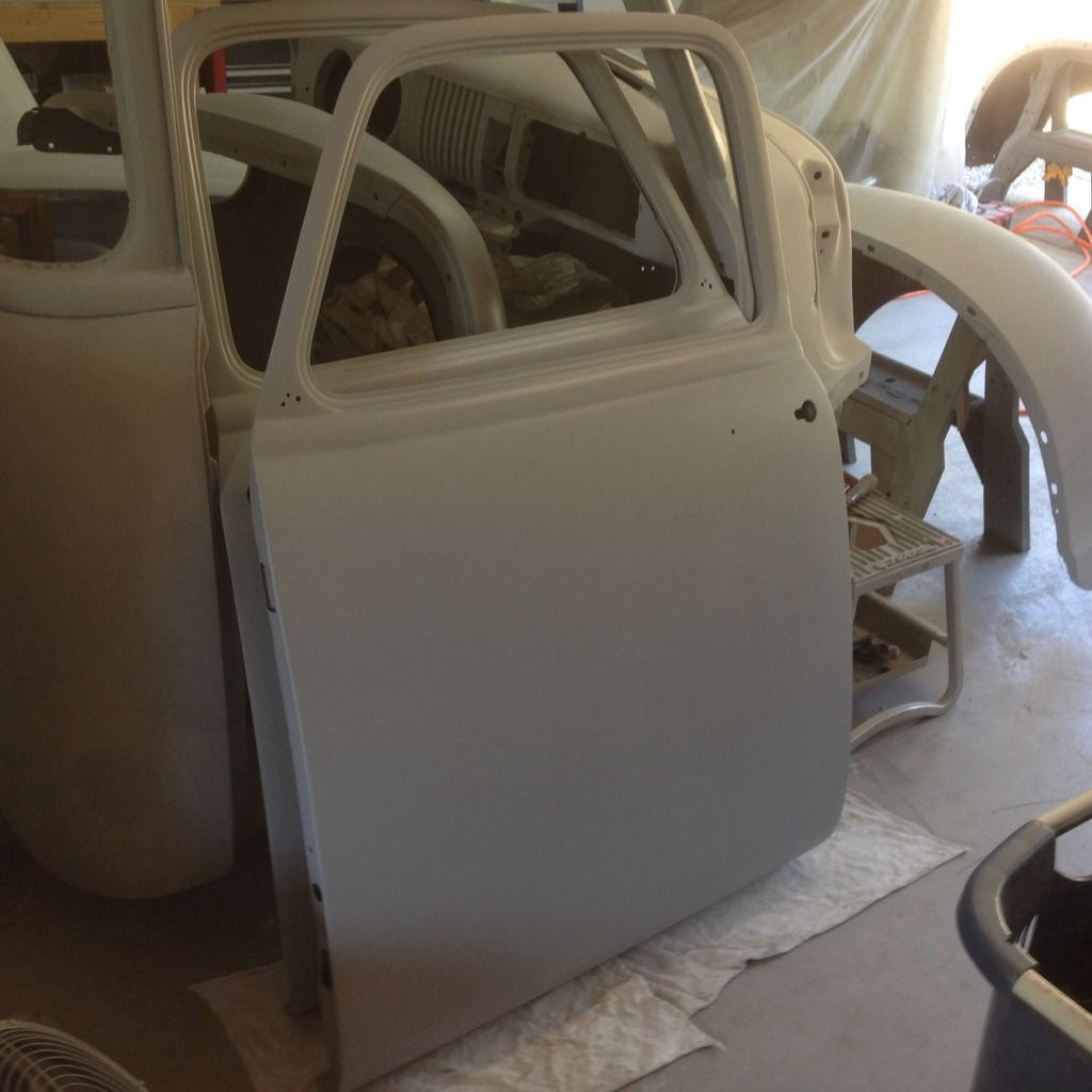

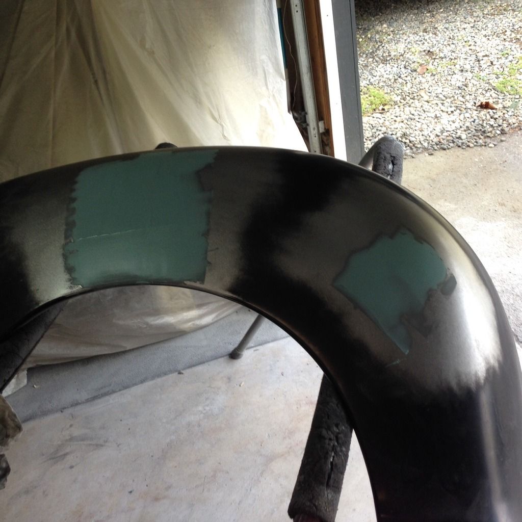

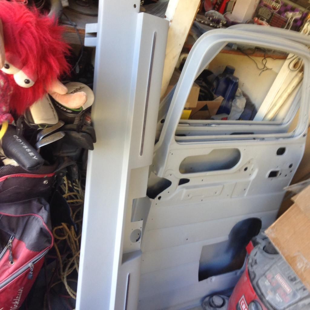

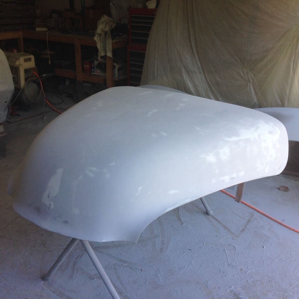

Well more set backs, found out you should be able to run a 1/8" paint stick down both sides of the door in order to clear for opening and paint. Mine did not. So after all the bodywork I had to sand both sides of both doors, drill 1/4" in every 6" down with a 1/8" bit and then weld the holes so when I grinded the side of the door it would not separate. Then after I got my 1/8" gap I had to weld the seem of the doors then redo the bodywork. MAN what a project.

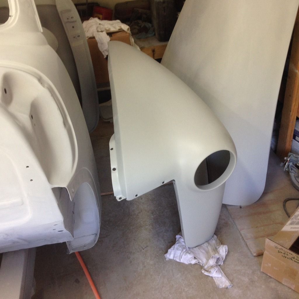

Finished the bodywork again and finally moving on to the priming stage

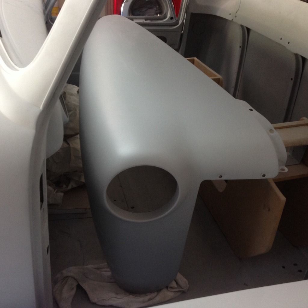

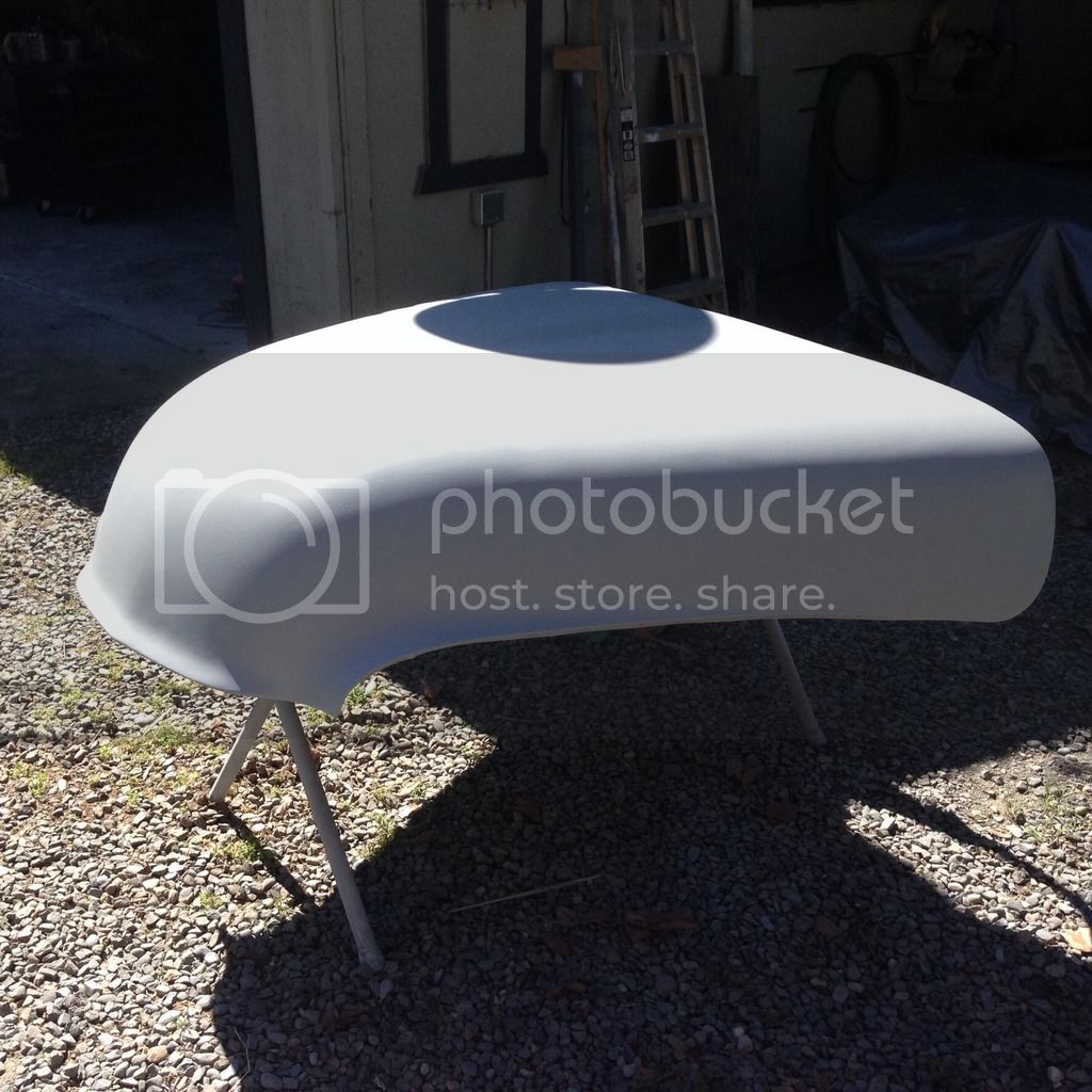

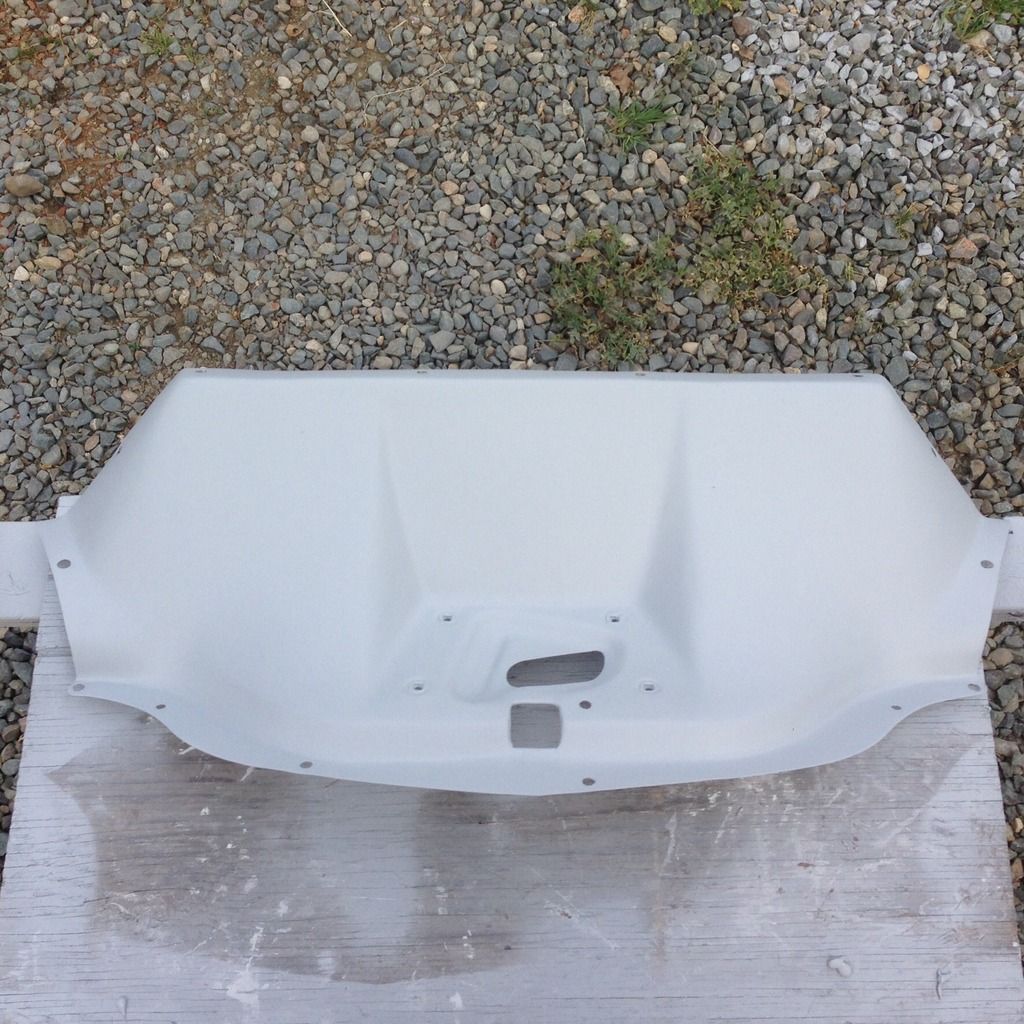

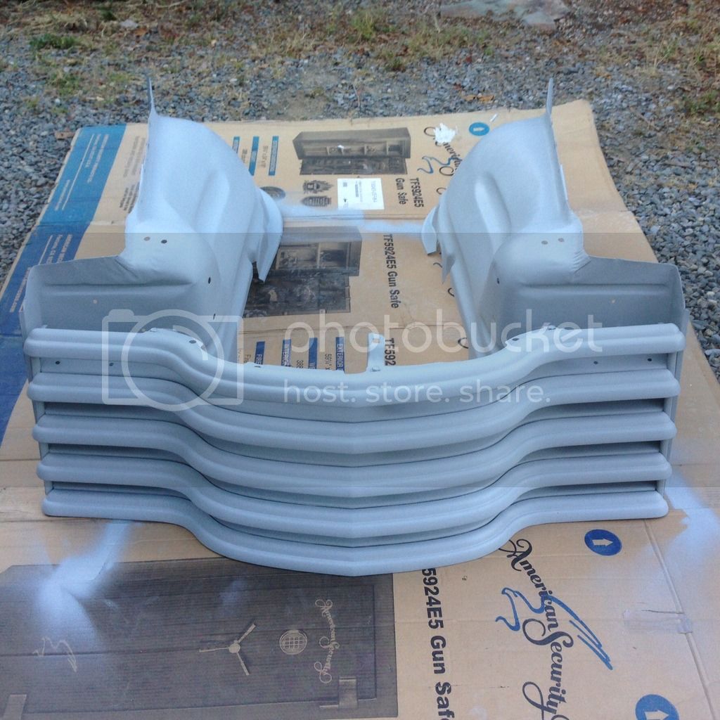

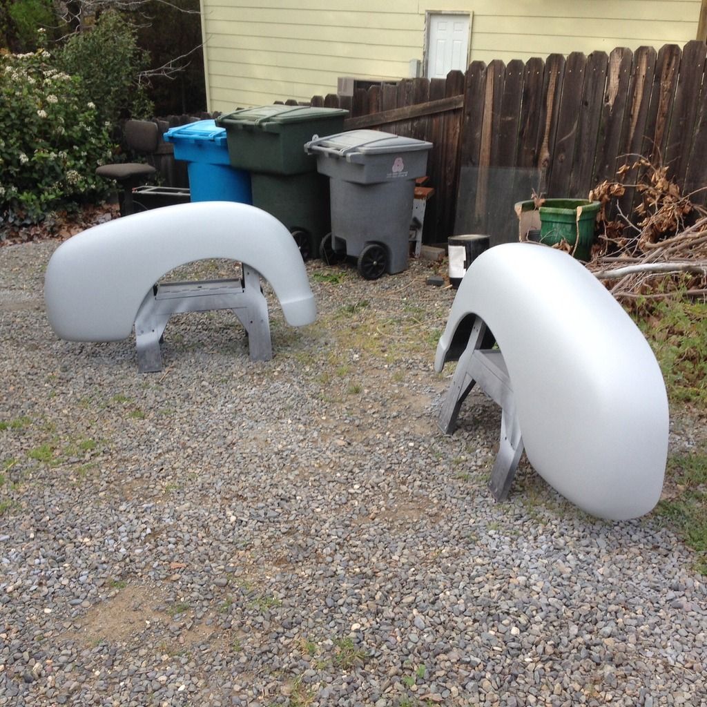

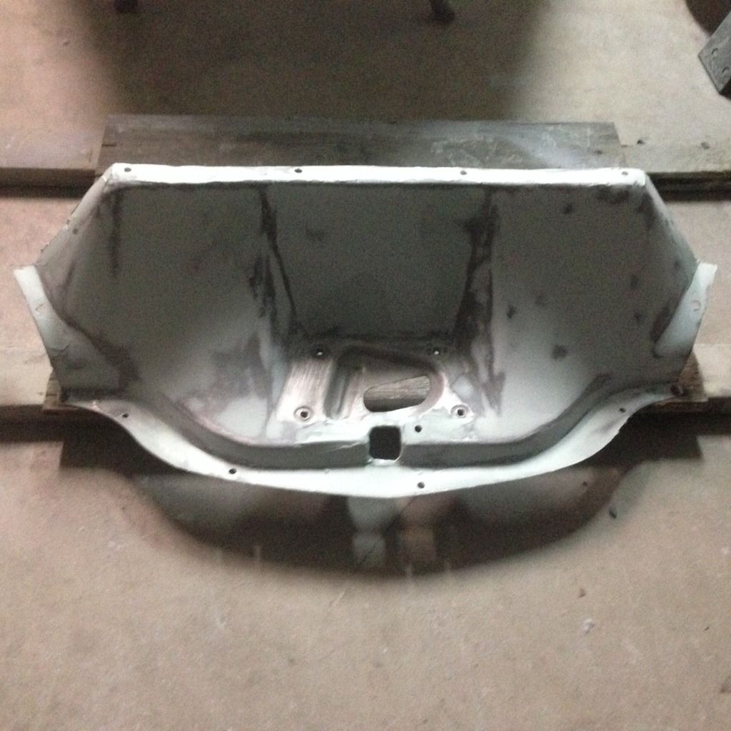

Front fenders, grill, inner fenders and front roll pan all in primer.

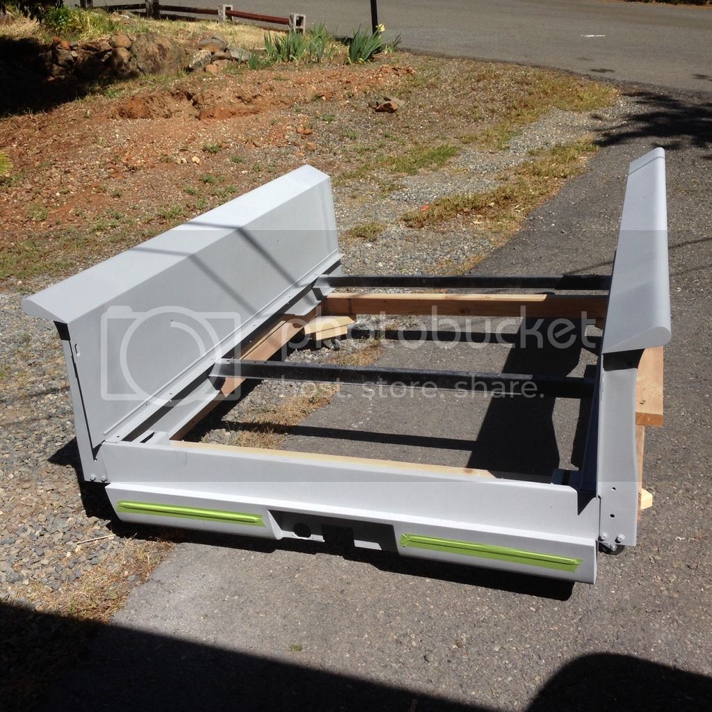

I also received my bed sides from Mar-K I liked them so much I order a black tailgate with hidden hinges from them

Thank you guy's really do appreciate the kind words. It is slowly coming along, I had no idea the amount of work I was going to put into it. There is so much to do, but I starting to see light at the end of the tunnel even though it's a very small light. Hopefully I will have everything in primer in the next 2 weeks then I have to put the truck together to make sure everything fits. I also ordered running boards from the guy on eBay. His name is Tony,very nice guy to deal with. Once I mount everything then take it apart finish the wet sanding and get it painted.
