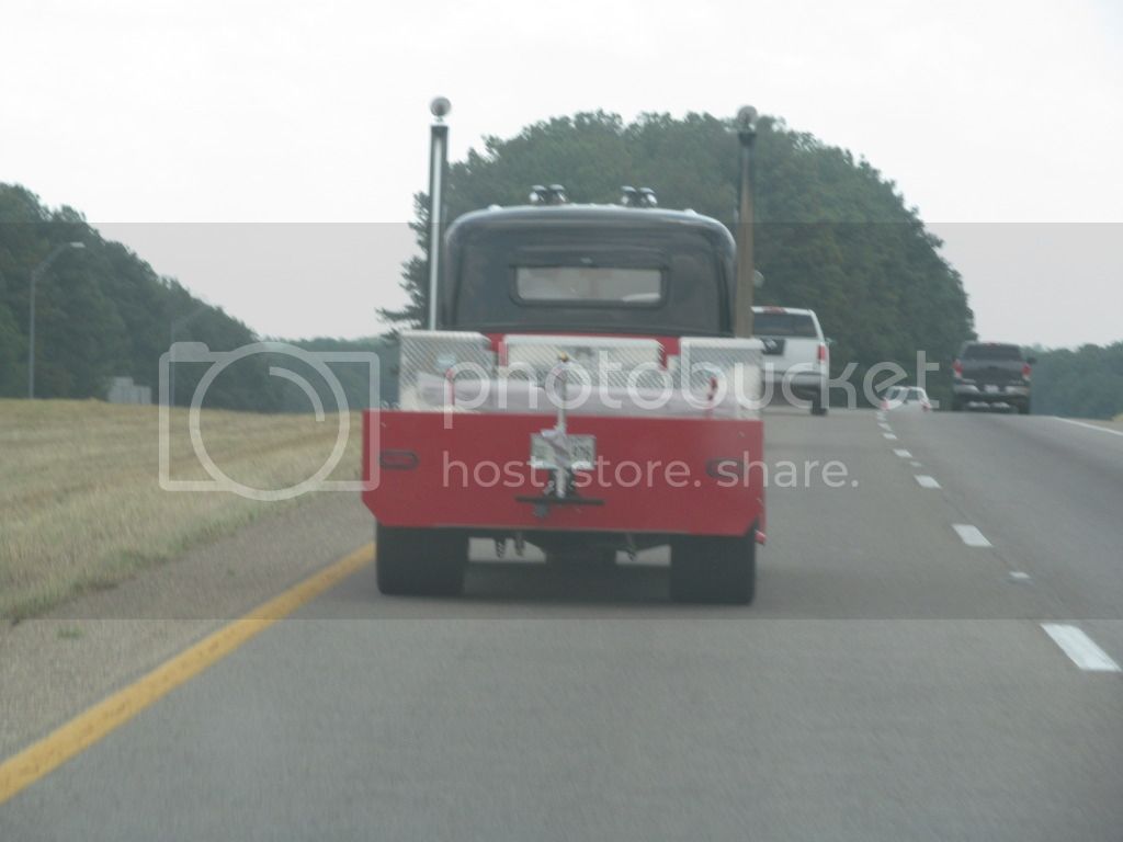

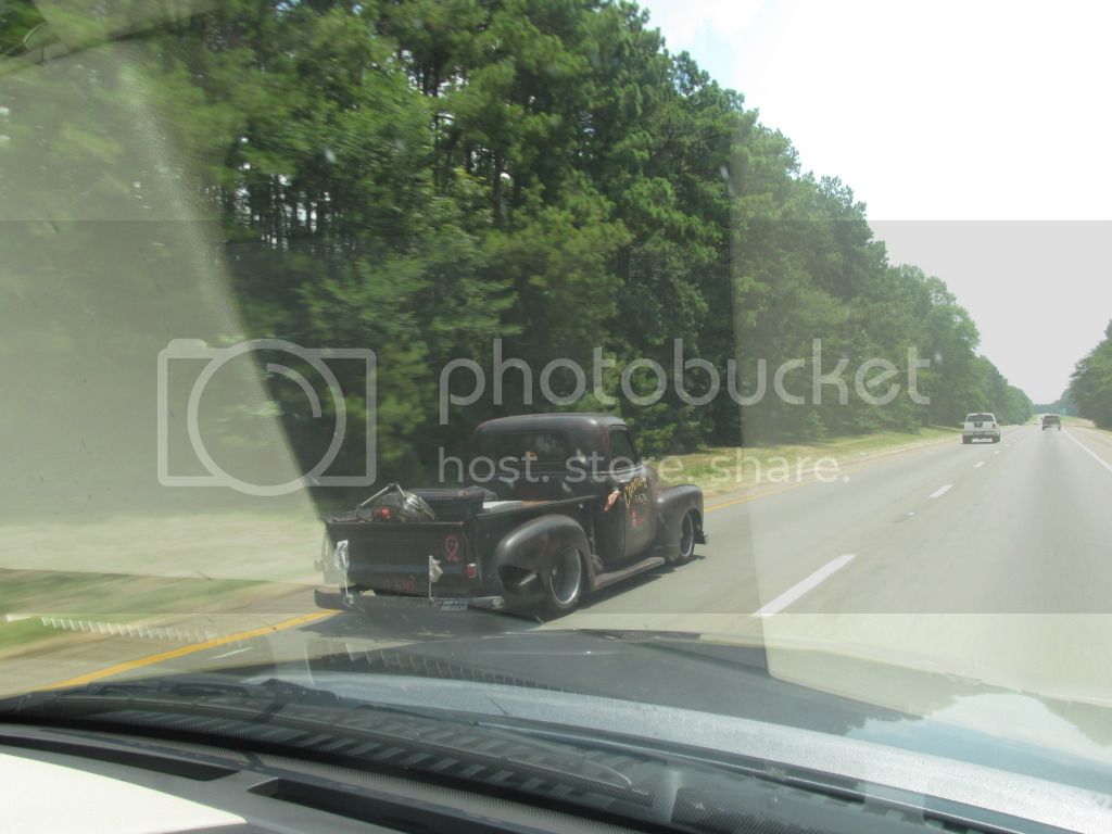

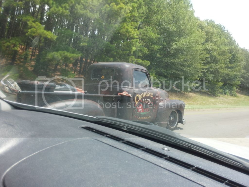

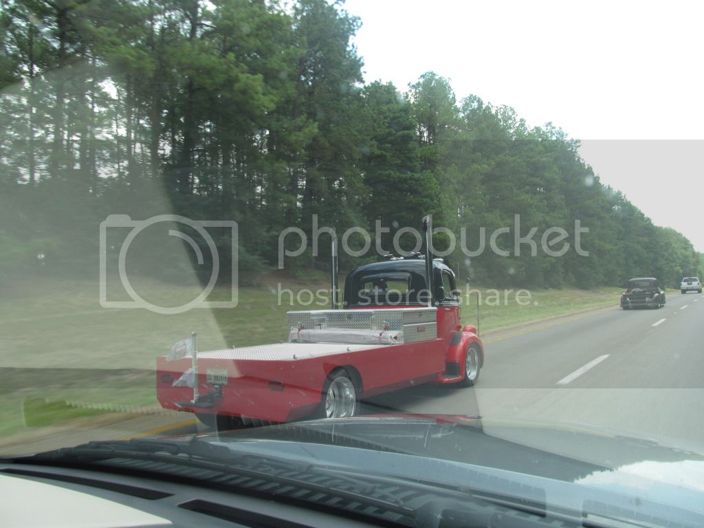

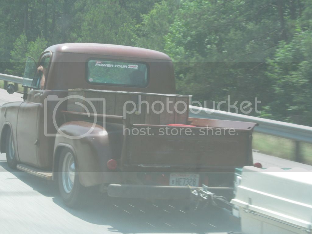

    I was in Florida on Vacation this past week. On my way there I saw this beauty on the I-20 E, I believe I was in Mississippi or Alabama, dont recall. Just wanted to share.
  6. ccharr
    That is a great looking truck traveling down the interstate, Thanks for sharing Ray.

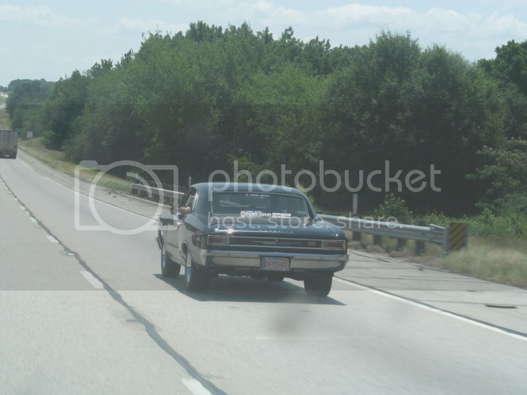

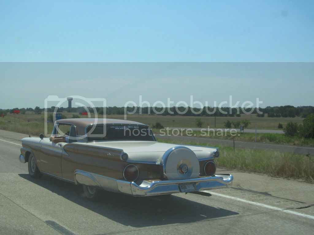

    Found more pics, same day.
