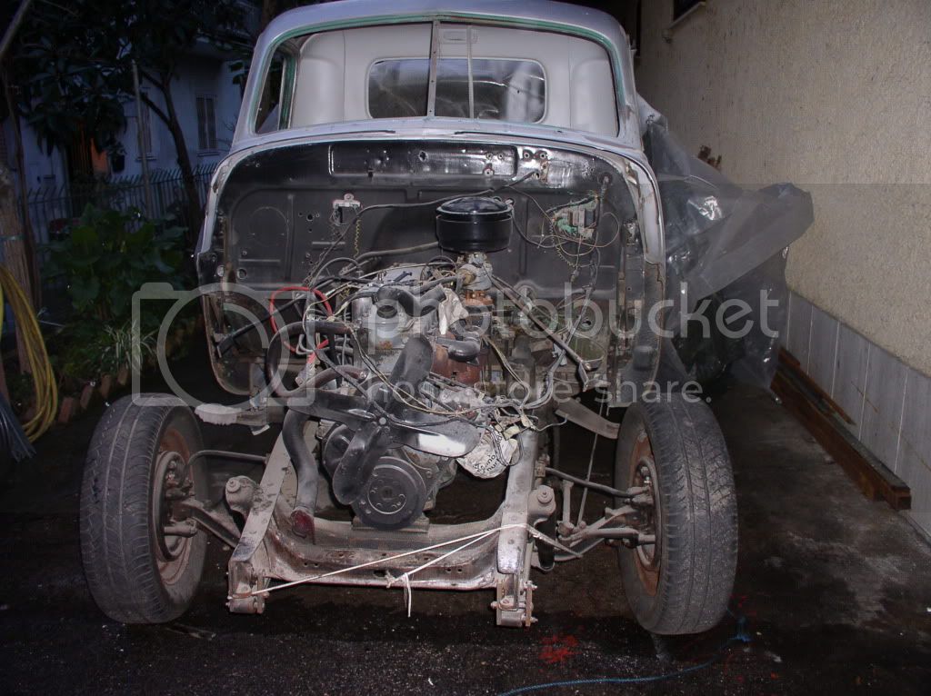

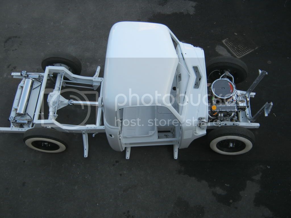

    After introducing myself I want to share with you my adventure.

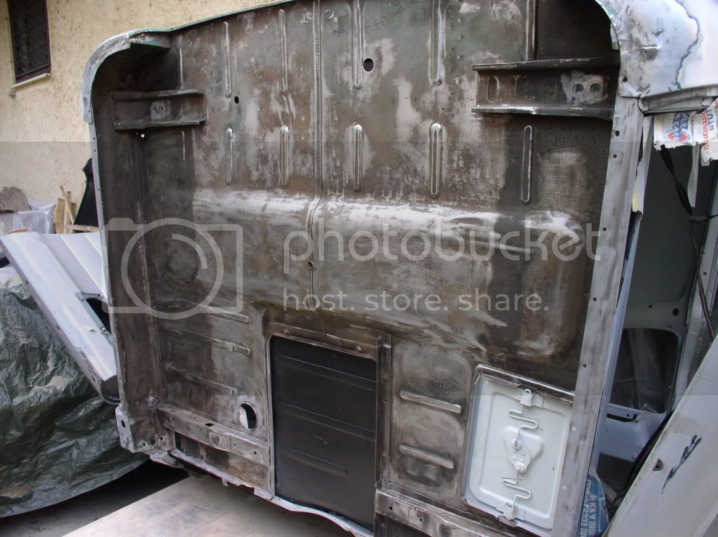

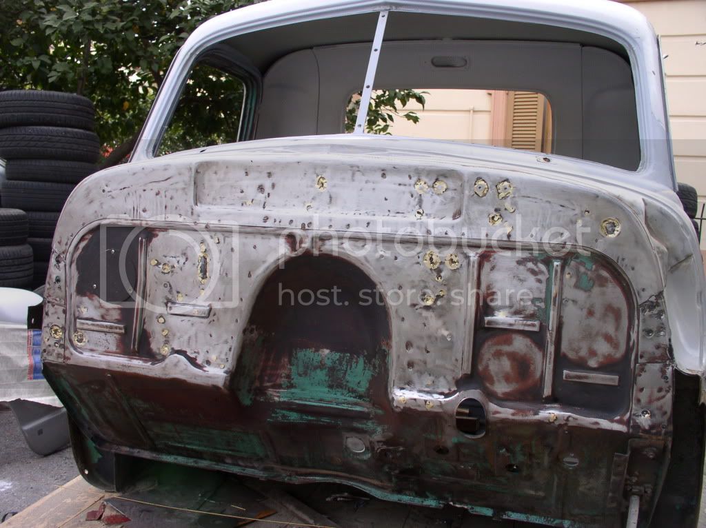

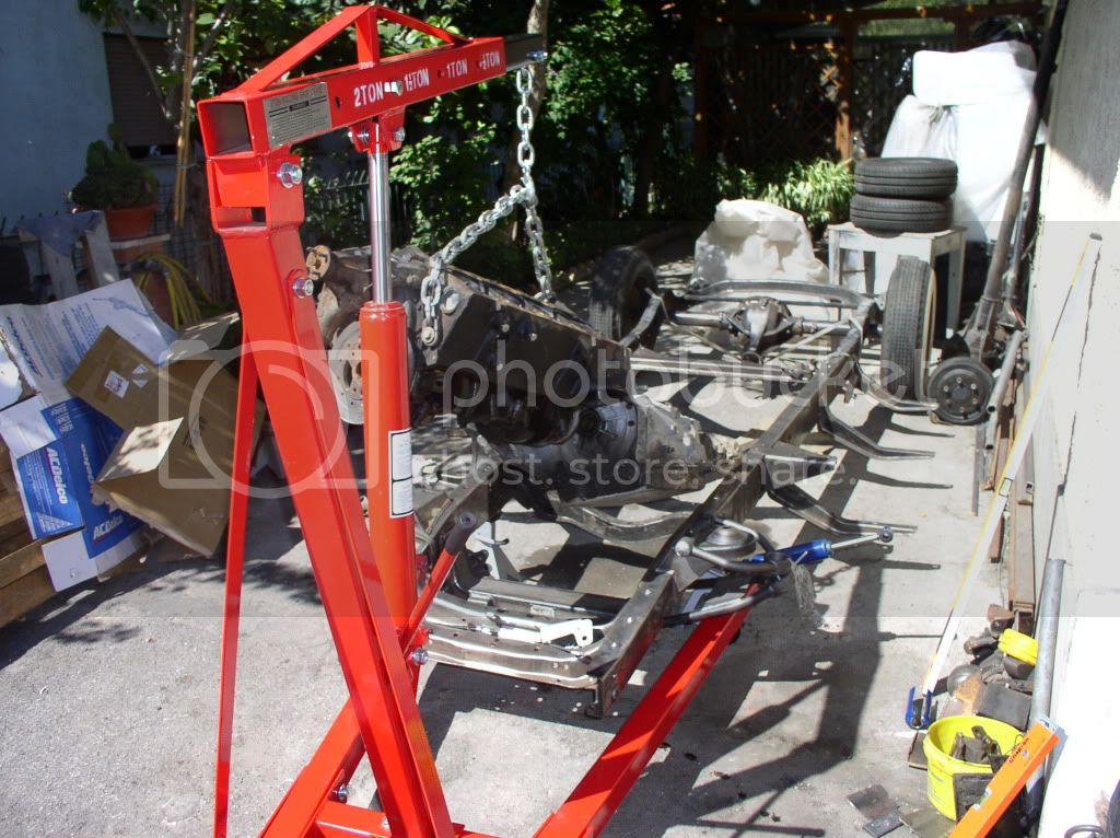

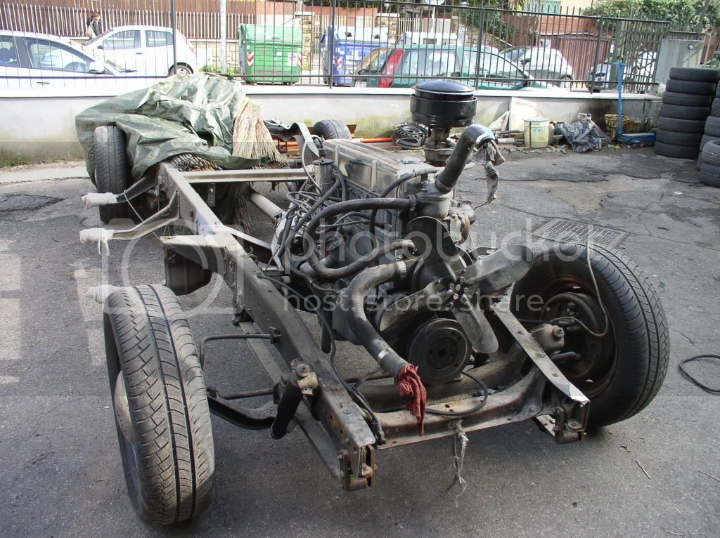

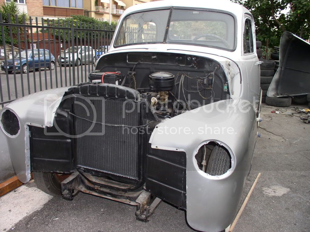

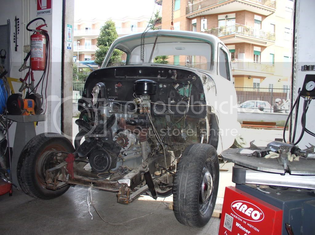

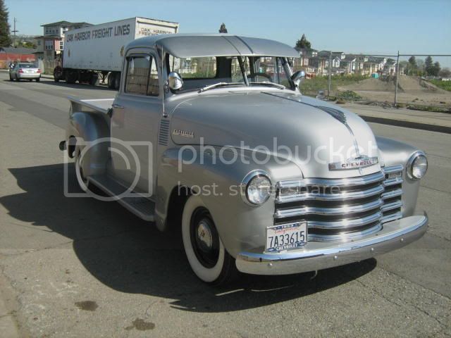

    This is my 53 when I bought it, but seemed in very good condition .....
    was in need of a frame-off.

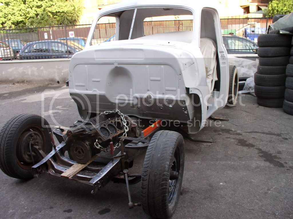

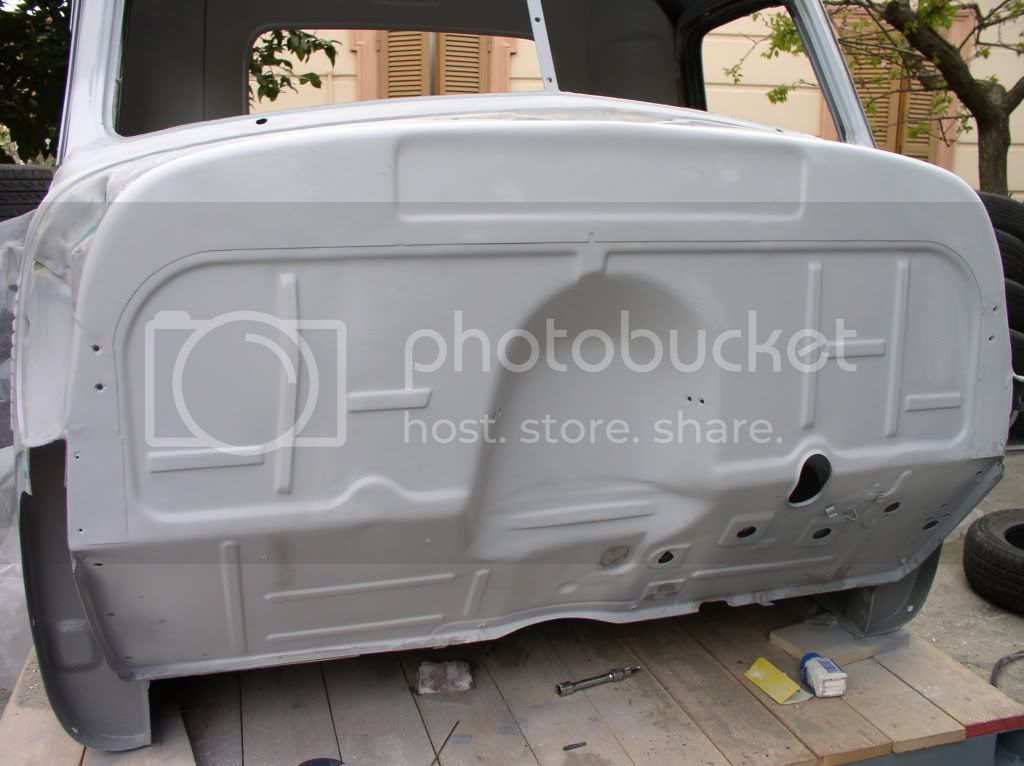

    Cab removing
    Frame...
  2. vwnate1
    11,700
    Nice !
    I see no rust anywhere , that's hard to find .
    It certainly didn't need a frame off resto but I'm pleased you're giving it one .

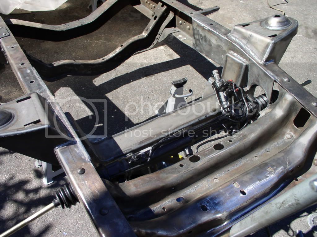

  6. Frank64
    Frank64 Member
    Dec 26, 2011
    53

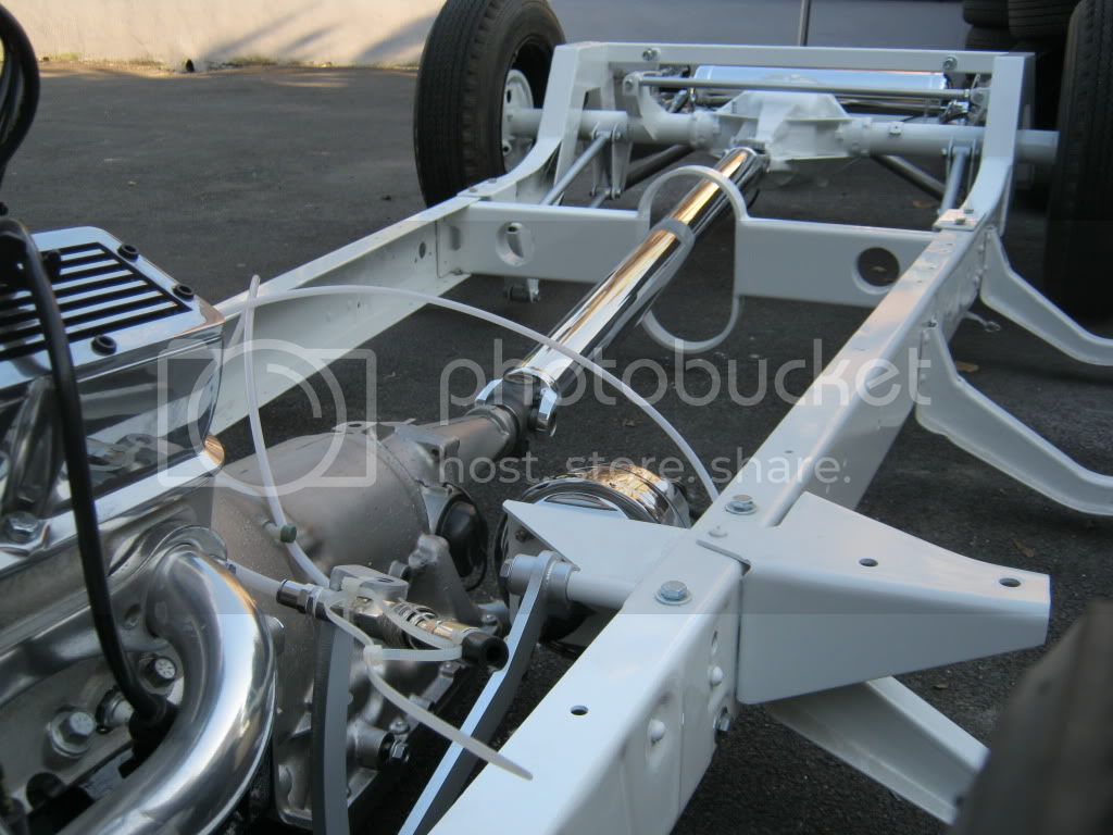

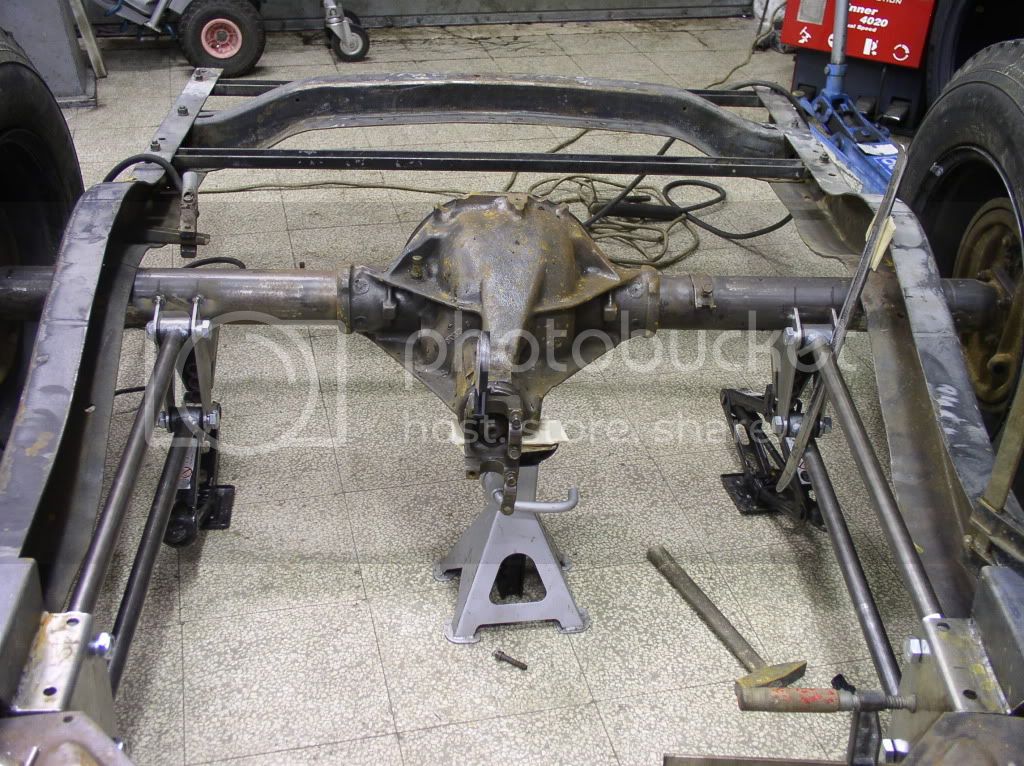

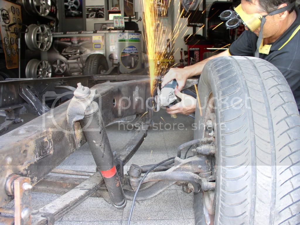

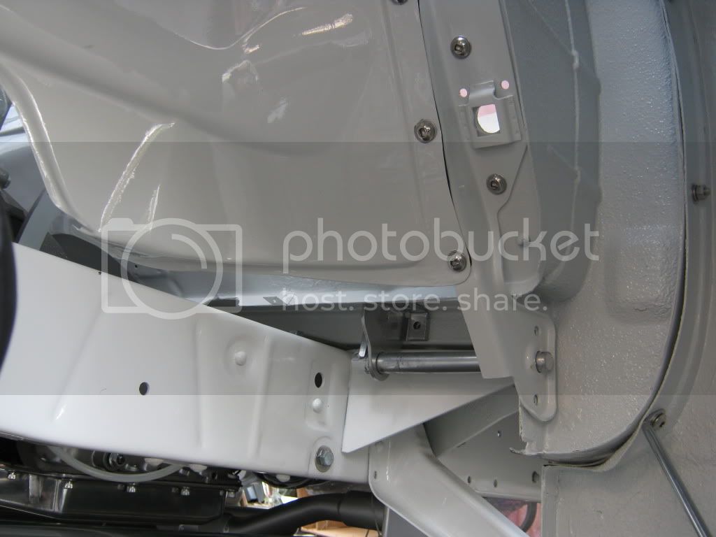

    More pics

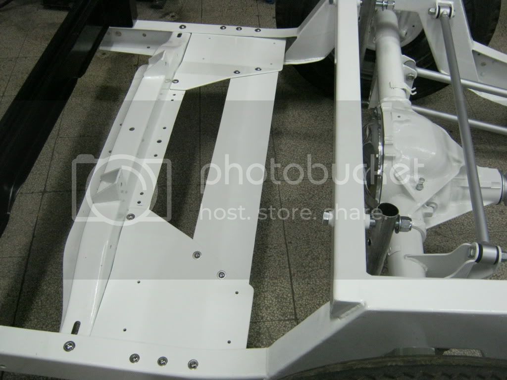

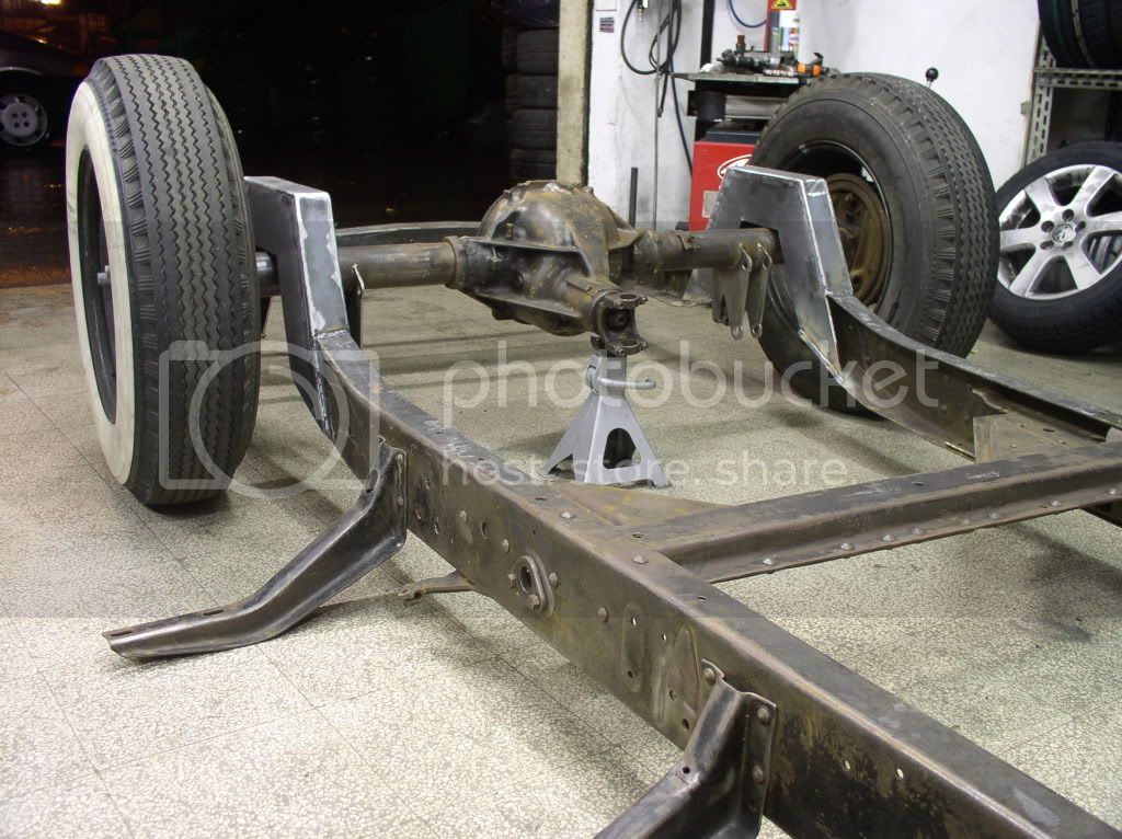

    Frame updates...

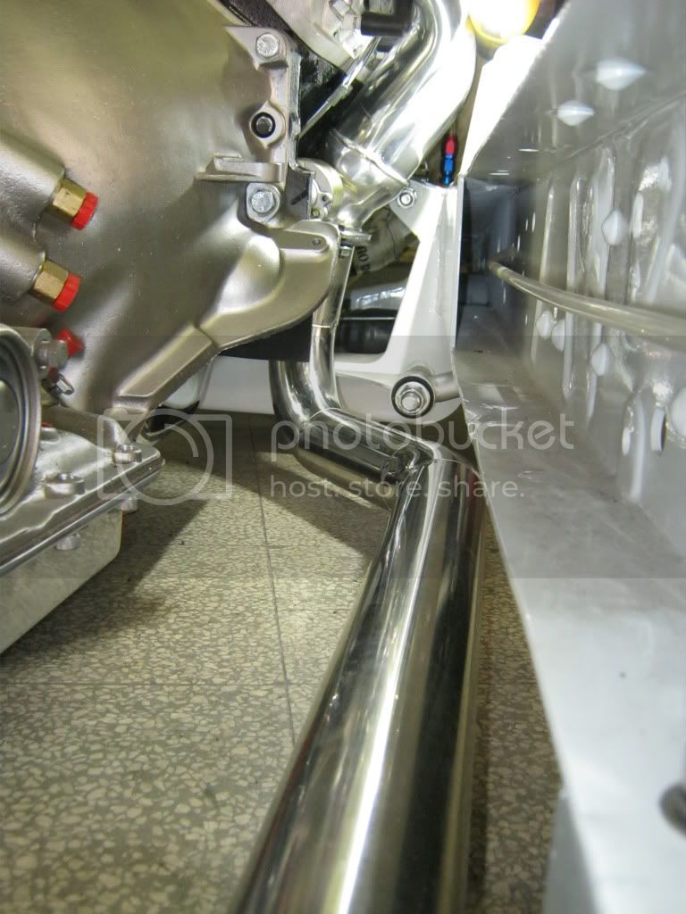

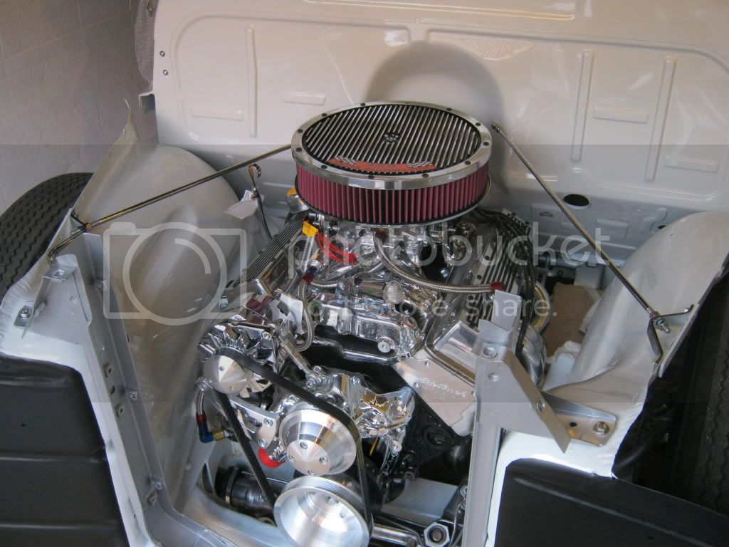

    Motor mount welding for a new 350 SB

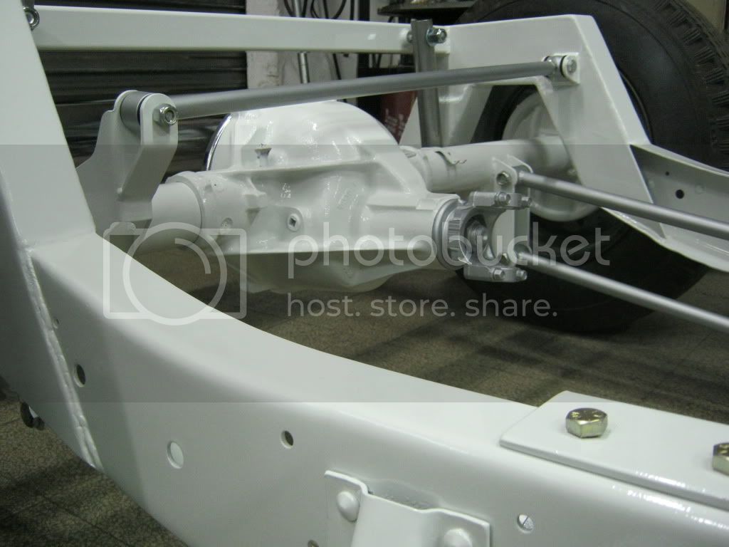

    Rear 4 link on the rear
    Frame C-Notched

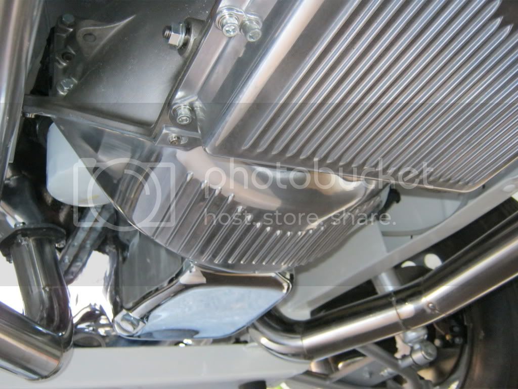

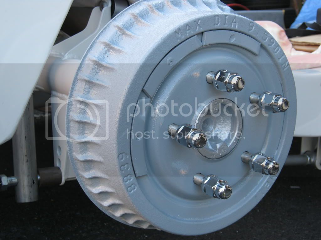

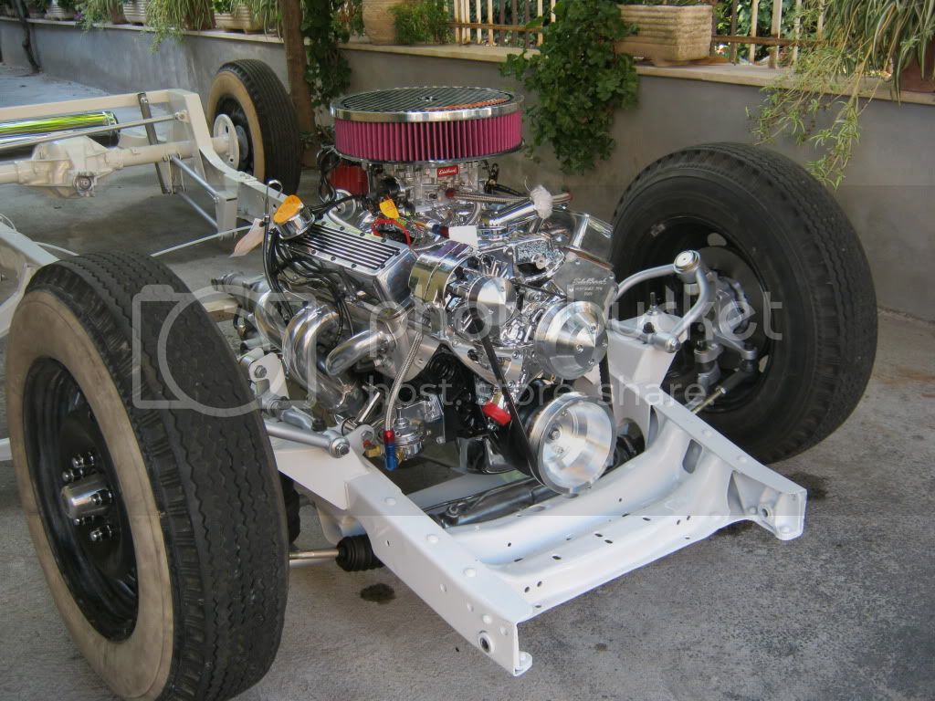

  7. Frank64
    Frank64 Member
    Dec 26, 2011
    53

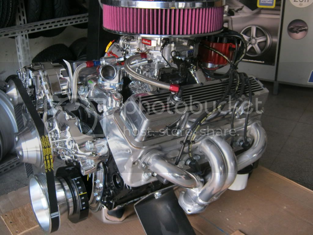

    My new engine from enginefactory...
    Rebuilded TH350 transmission
    GM 8.5 10 Bolt Rear End
    New aluminum driveshaft
    New SS exhaust tubing with polished SS Magnaflow Mufflers

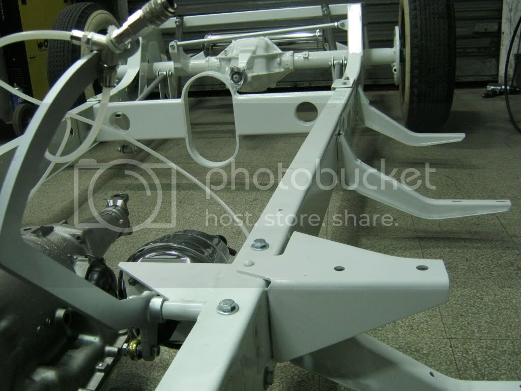

  10. Frank64
    Frank64 Member
    Dec 26, 2011
    53

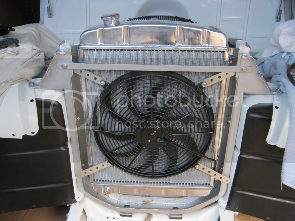

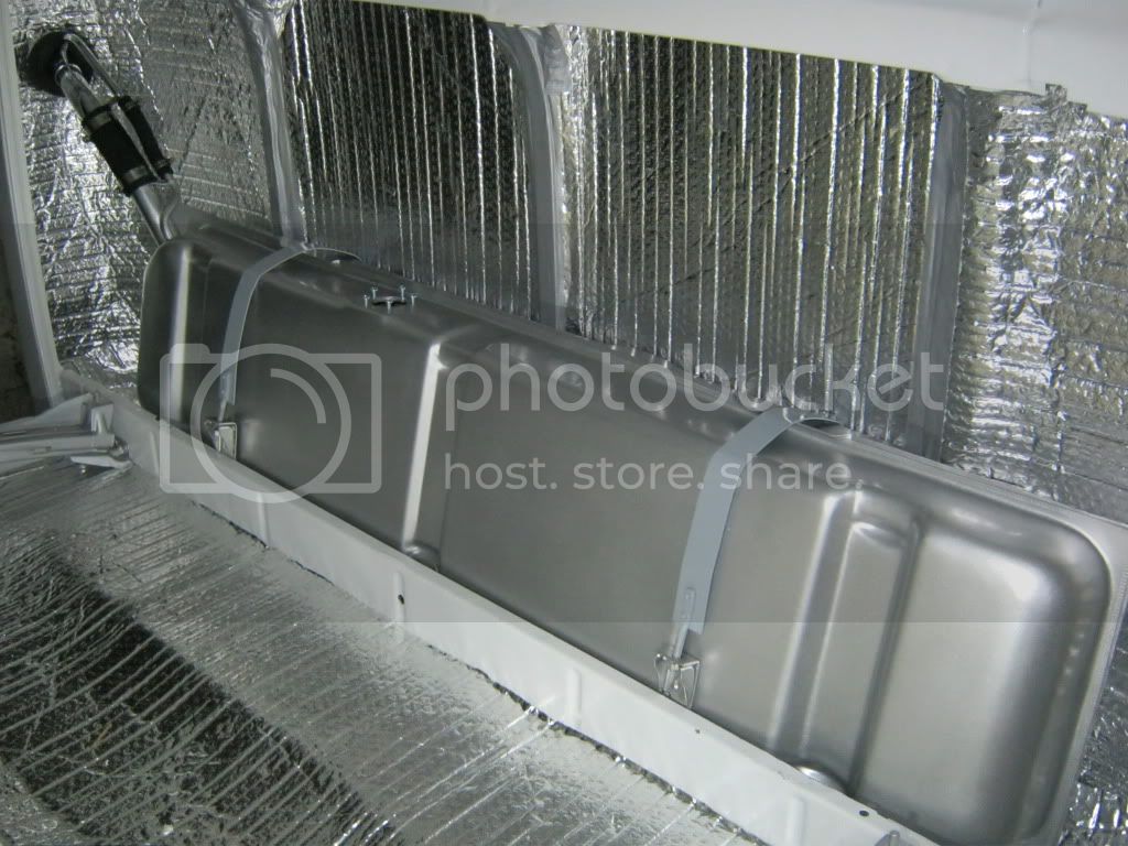

    Other pics
    New gas tank from Classicparts
    New polished aluminum Radiator

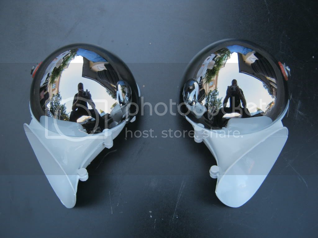

    '55 Chevy Horns white painted with chrome cover

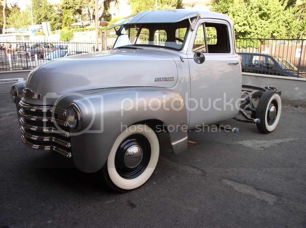

    Now the restoration is at this point,
    these are the last pictures taken a week ago

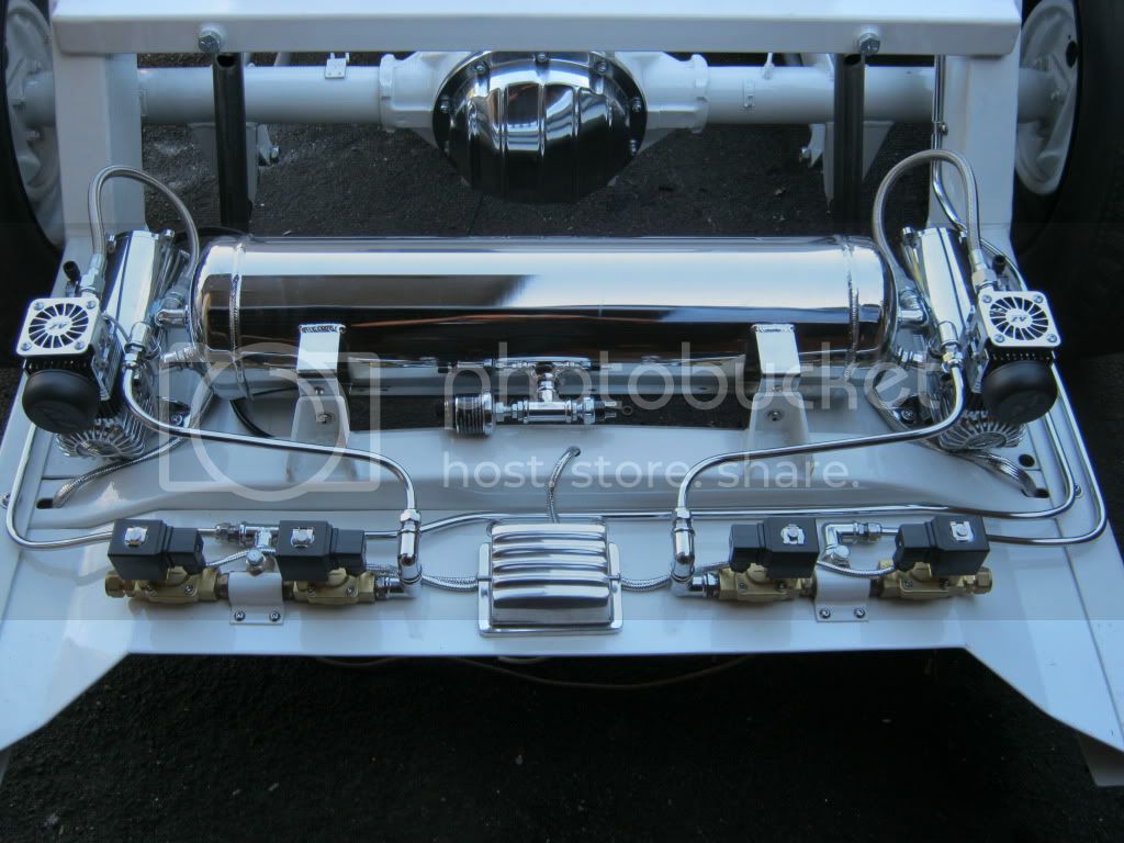

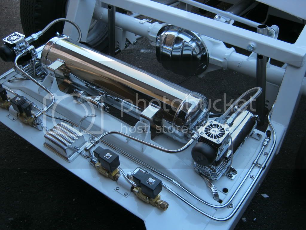

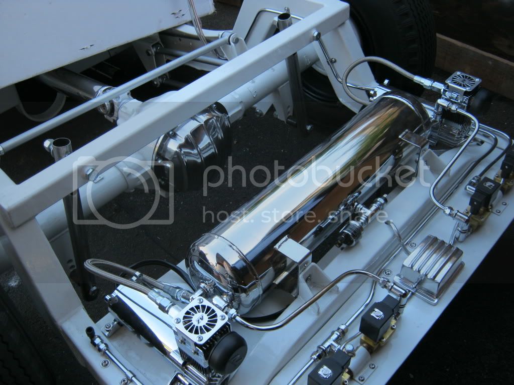

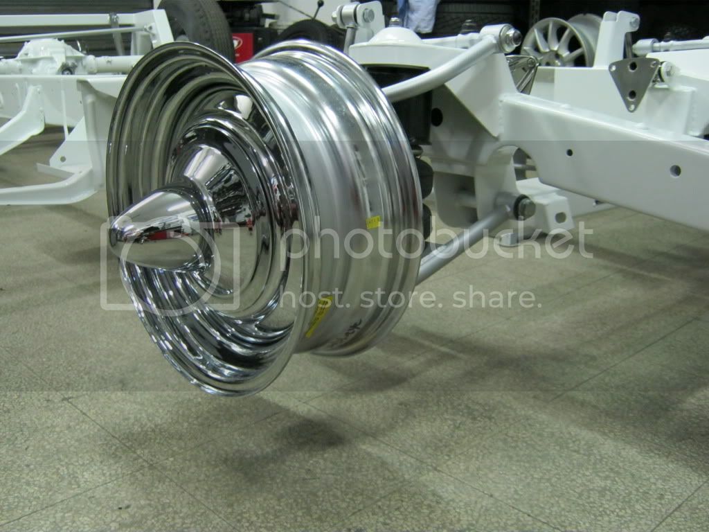

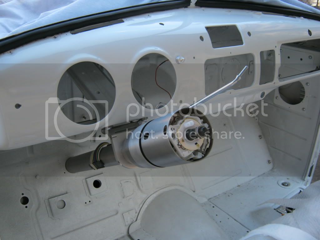

    My air ride setup...

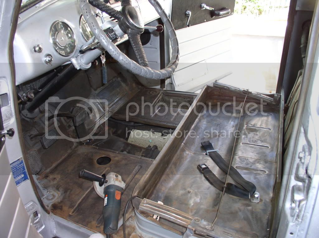

    Ididit steering column

    Nice truck. With those bags ran with "T" to each axle, you will want to run a thick sway bar front and rear to control body roll and air transfer. I had mine that way at first, it got exciting when hard cornering!

  16. Blueflame236
    Blueflame236 Member
    Mar 29, 2008
    1,555
    Norway

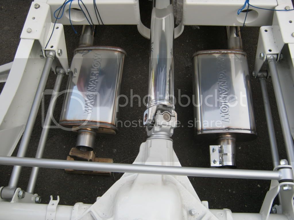

    Linkage at the rearend and airtank !
    Hey Frank
    I wanna ask you if the linkage is a standard solution or if you had to make it all , brackets and rods ect. is it posseble to show with a picture how you connected these rods at the opposite side ? I am intrested to know aswell wich air suspension solution you have choosen (what brand) tank and other parts ?
    Martinius.

    Hi Martinius,
    I chose Zenith because I wanted it to be all chrome :)
    This: http://shop.air-zenith.com/dual-ob2prokit.aspx
    I decided to install 2 valves for rear and 2 for front.
    Unfortunately I'm not very familiar with English and I can not translate all that you write to me :)
    Tell me how I can help, I have many photos to send to you.
    Many thanks
    Frank

  20. Blueflame236
    Blueflame236 Member
    Mar 29, 2008
    1,555
    Norway
    Pictures of the rear end linkage wil do
    hey Frank
    I whas in Oslo today and saw your reply when i came home:). I mean the brackets and the rods between the rearend and your crossover connection.
    Pictures will do offcourse.
